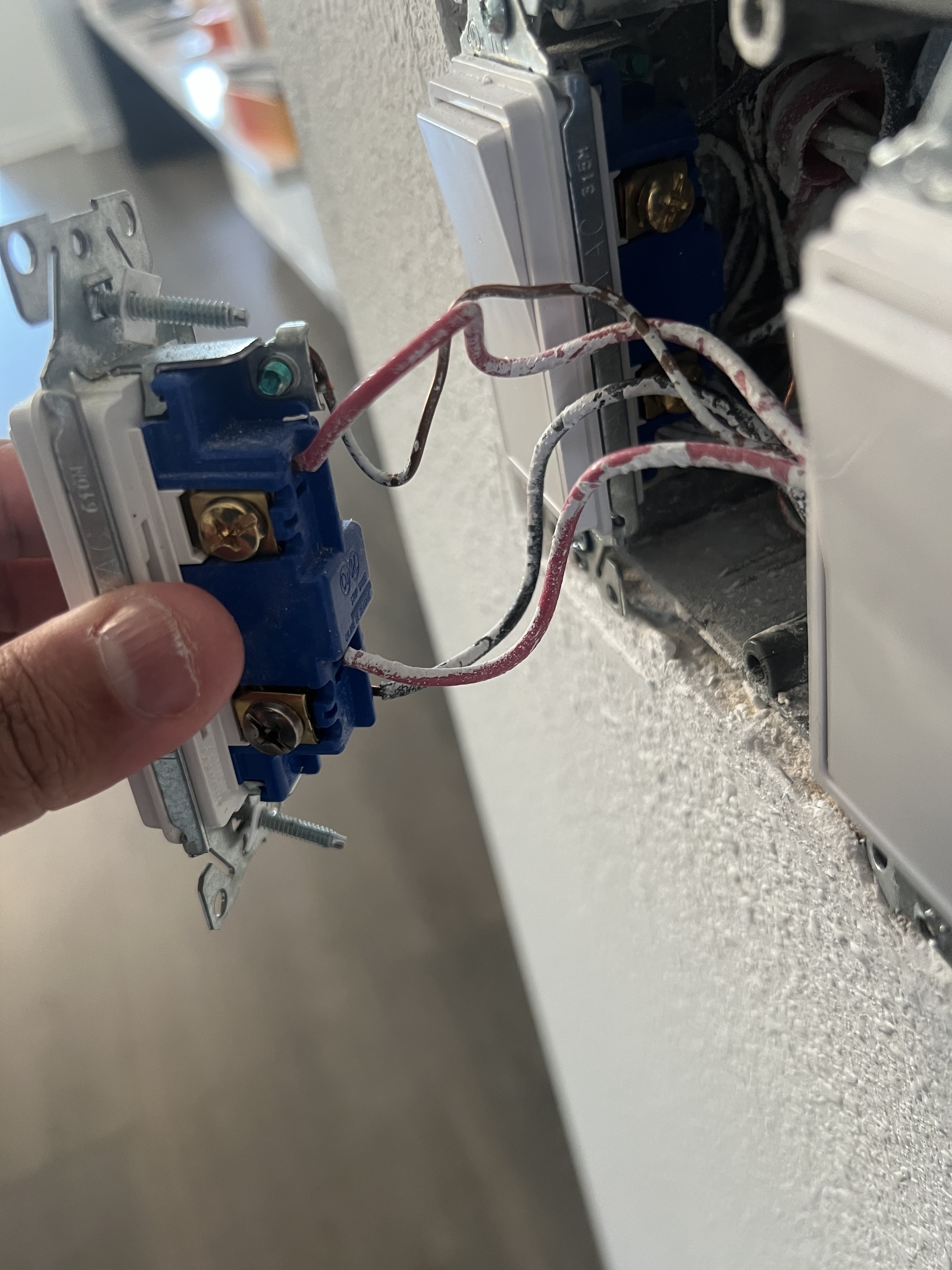

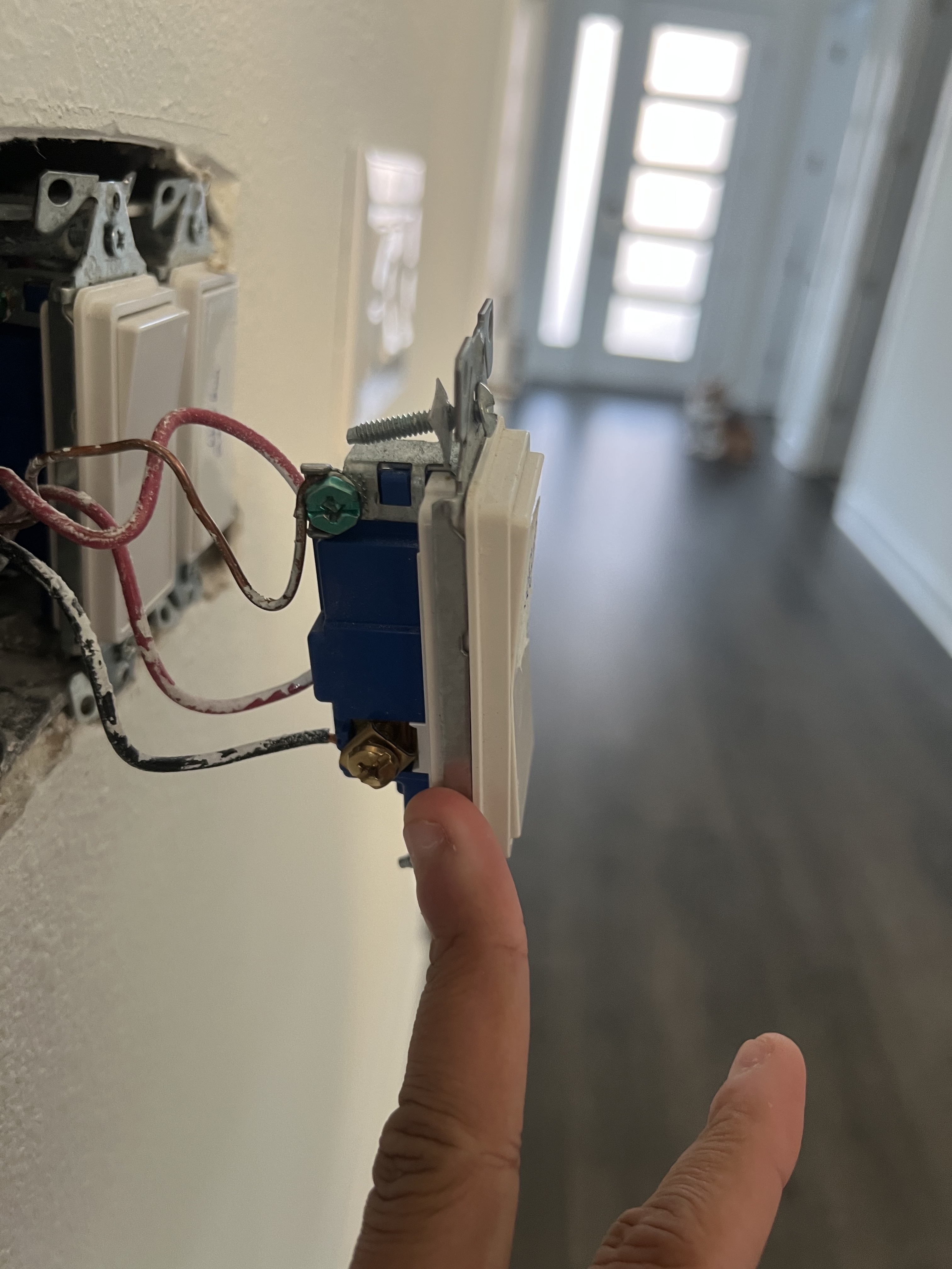

Hi I’m currently trying to wire up a 3 way multi with 1 white series inovelli, and 1 dummy switch. When I pulled out the switch I’d like to replace with the inovelli I had two red wires (I’m assuming a load and traveler), a black ( the line) and a ground. I wired up the inovelli. I may have switched up the traveler and load. I provided pictures of the wiring before removing, just in case I had to go back. The bottom red is what I assumed was the traveler and the top wire was the load.

The one thing that hit me with the pictures of the one switch that you posted is that there are two reds and a black attached to the switch. While that may not be incorrect, I would normally expect to see two blacks and a red attached to each 3-way switch.
But to do this properly, you have to fully understand the topology of your wiring. Making assumptions and just moving stuff around to see what works never works well with electricity.
I would start by removing both conductors from the black screws on the two switches. With them removed from the switches, one of them will be hot continuously and the other one will not have any power. So test for the presence of electricity on each of those two conductors. That will be your incoming line and the Inovelli will go there.
I’ll be glad to look at pictures of your wiring if you take pictures that show all of the connections to the switches and into the boxes so that wiring can be traced. However, I will be away from a computer for a couple days and it’s too tough to do that analysis on a phone. Someone else should be able to help you in the interim.
