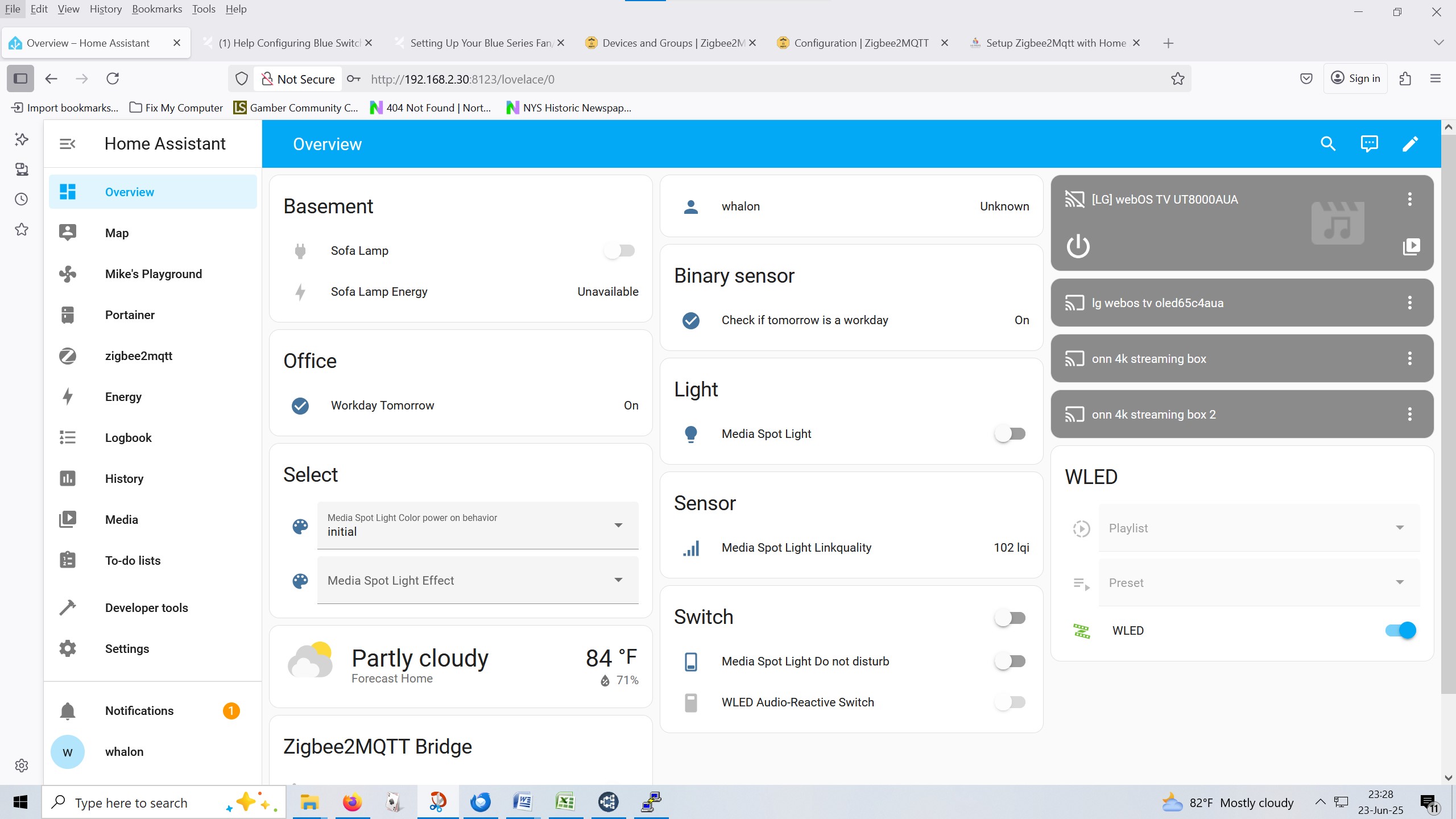

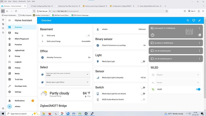

HA-Overview (below) shows my main HA page

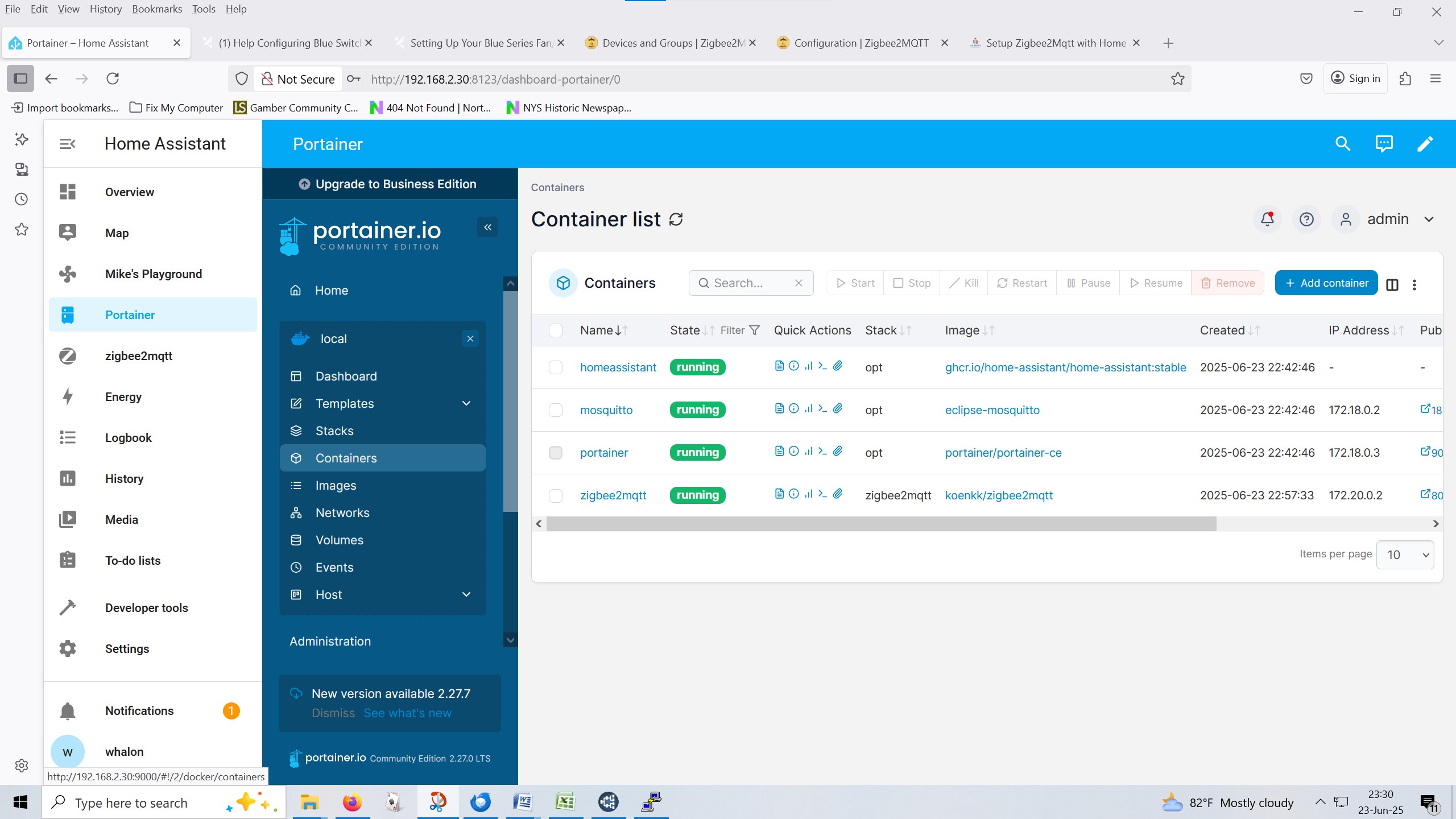

I can access Portainer by clicking on the ‘Portainer’ item in the side bar. Portainer shows four expected containers running

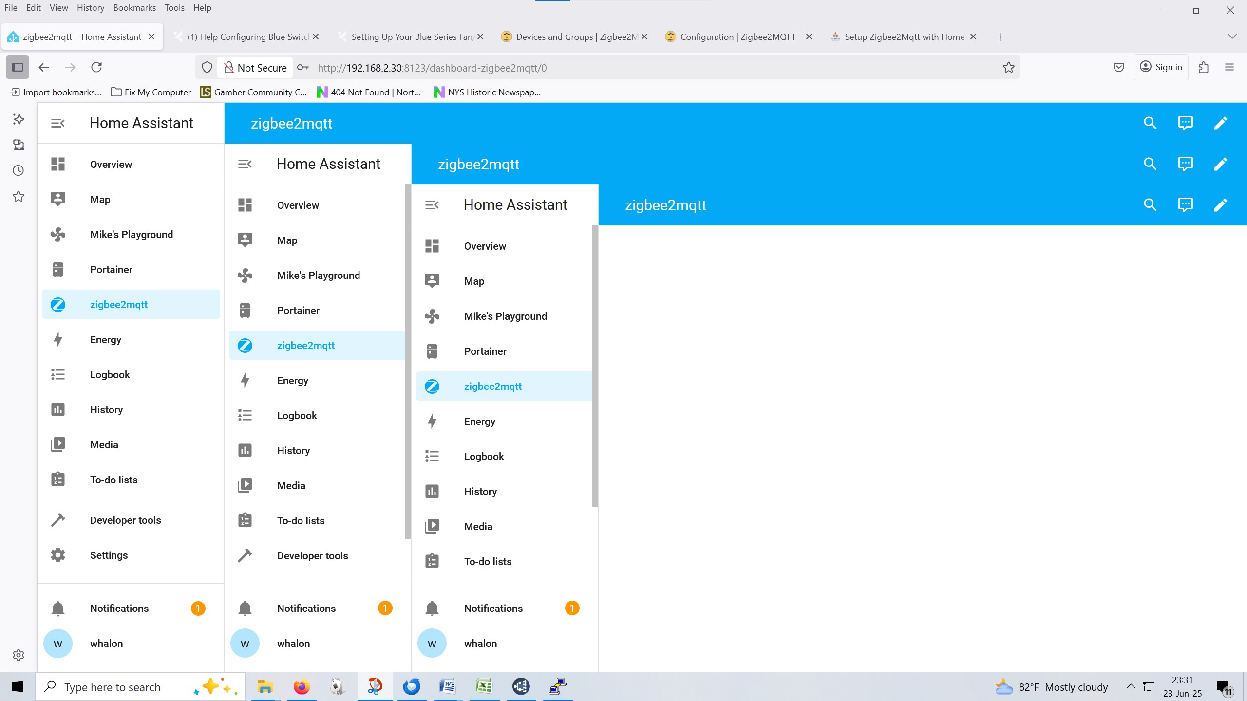

The ‘zigbee2MQTT’ item in the side bar was generated in similar fashion (to Portainer). However, when I click on zigbee2MQTT – I get the following…

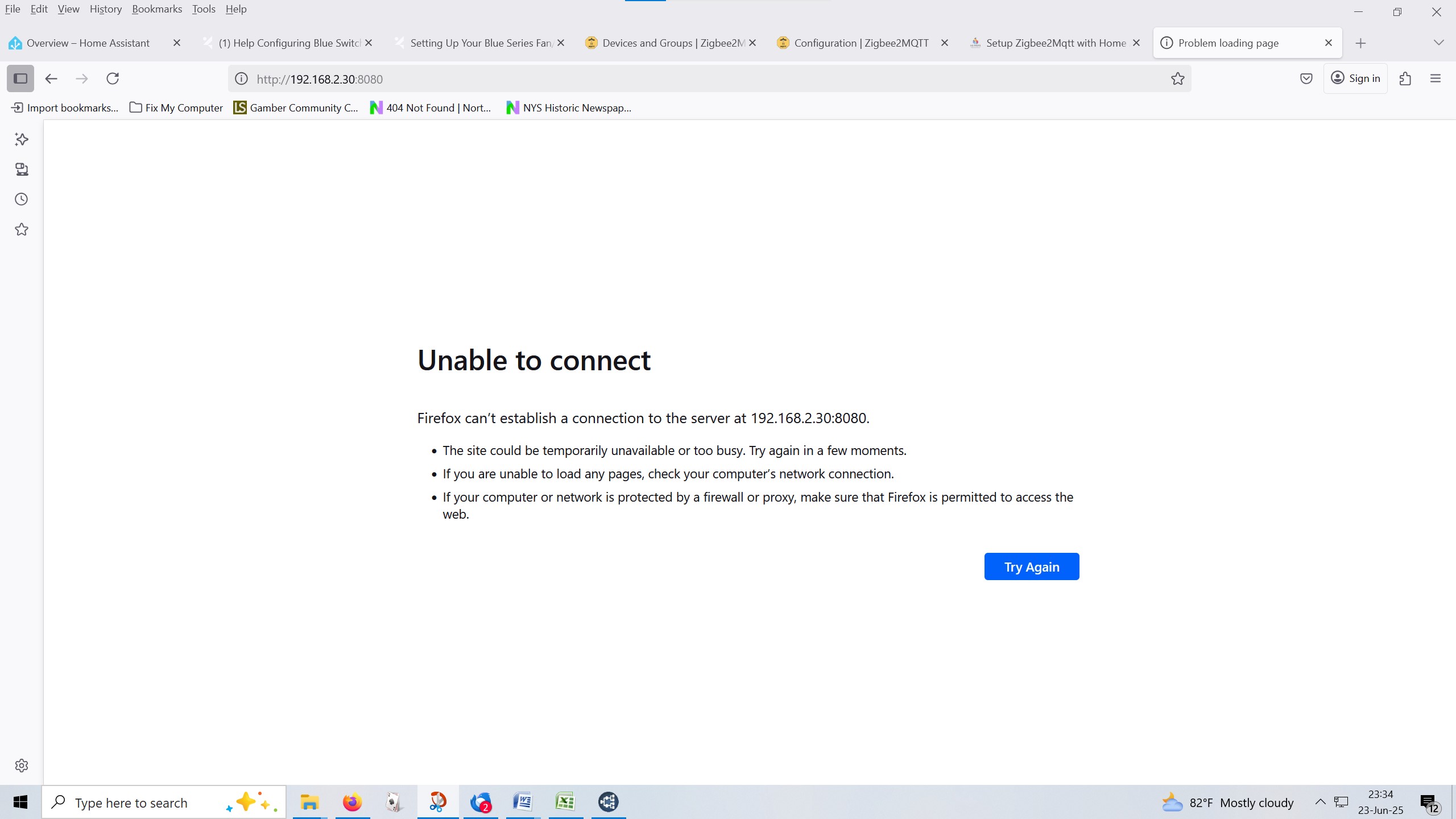

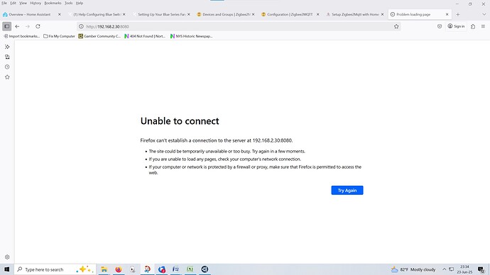

I was able earlier in the evening to display zigbee2MQTT page by directly typing IP Address:Port. However, most recently, I am unable to connect in this manner. I can no longer reach zigbee2MQTT directly. I can SSH into my server.
