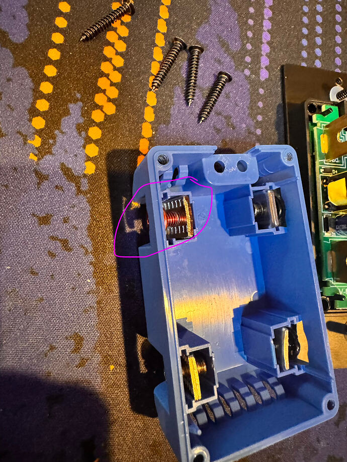

Photo guide:
Step1: Remove these 4 screws
Step 2: Set lugs to the middle of range, if they are fully tight or fully loose things bind up.
Step 3: Pull halves appart
Step 4: replace/swap screws (most of the time traveler is unused so you can steal this to replace a stripped screw. NOTE the orientation, it does matter! The stamping is there to help pressure plate hold wire. If you put it in the wrong orientation you will not have the same resistance to pull out.
