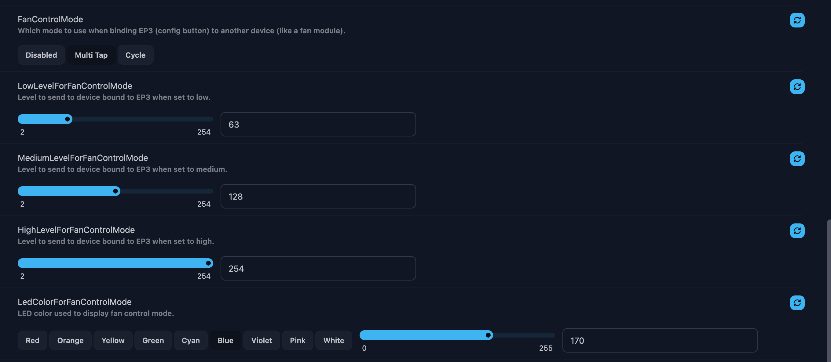

You’ll also need to set some of these parameters (unfortunately I don’t have the parameter numbers handy but the names should be similar). With that set, I can single tap the config button to take my hue light to 33%, double tap for 66% and triple tap for 100% and hold down to turn it off.
