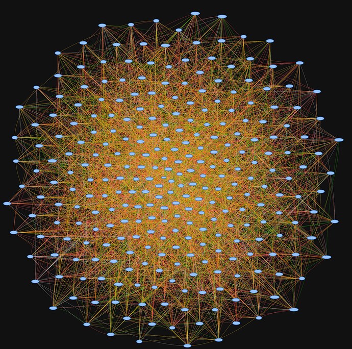

Large Zigbee Network Experiences
Curious why the switch from z2m to zha?
My coordinators have all been EZSP firmware. With Z2M, when getting to about 70 devices, I had to quickly power the device off right after joining to get it to stay on the network. That has completely gone away with ZHA. I prefer the current Z2M capabilities with binding/groups/OTA/MQTT information etc…but at this size and complexity, the joining process had to be closer to flawless. With EZSP, ZHA was much better for me. I have worked through the binding/grouping “features” of ZHA and they are very early. The OTA was a nightmare, as I did not know they had stopped it from working because of Tuya devices and spent countless hours trying to fix something that I could not without a very specific YAML entry. Of course, there is a PR for an almost complete rework of the OTA for Zigpy. I would expect that to drop into HA shortly as well and might resolve a bunch of OTA issues. You can even use the JSON from Z2M to feed the update process.
This is almost impossible to zoom in on and use, but it looks “cool”.
In case you’re not familiar with it, zha-toolkit does give you a bit more flexibility with the binding options, etc.
Thanks. I have used zha-toolkit before, but I had not thought about the group/binding options. That helps a lot. Thank you!

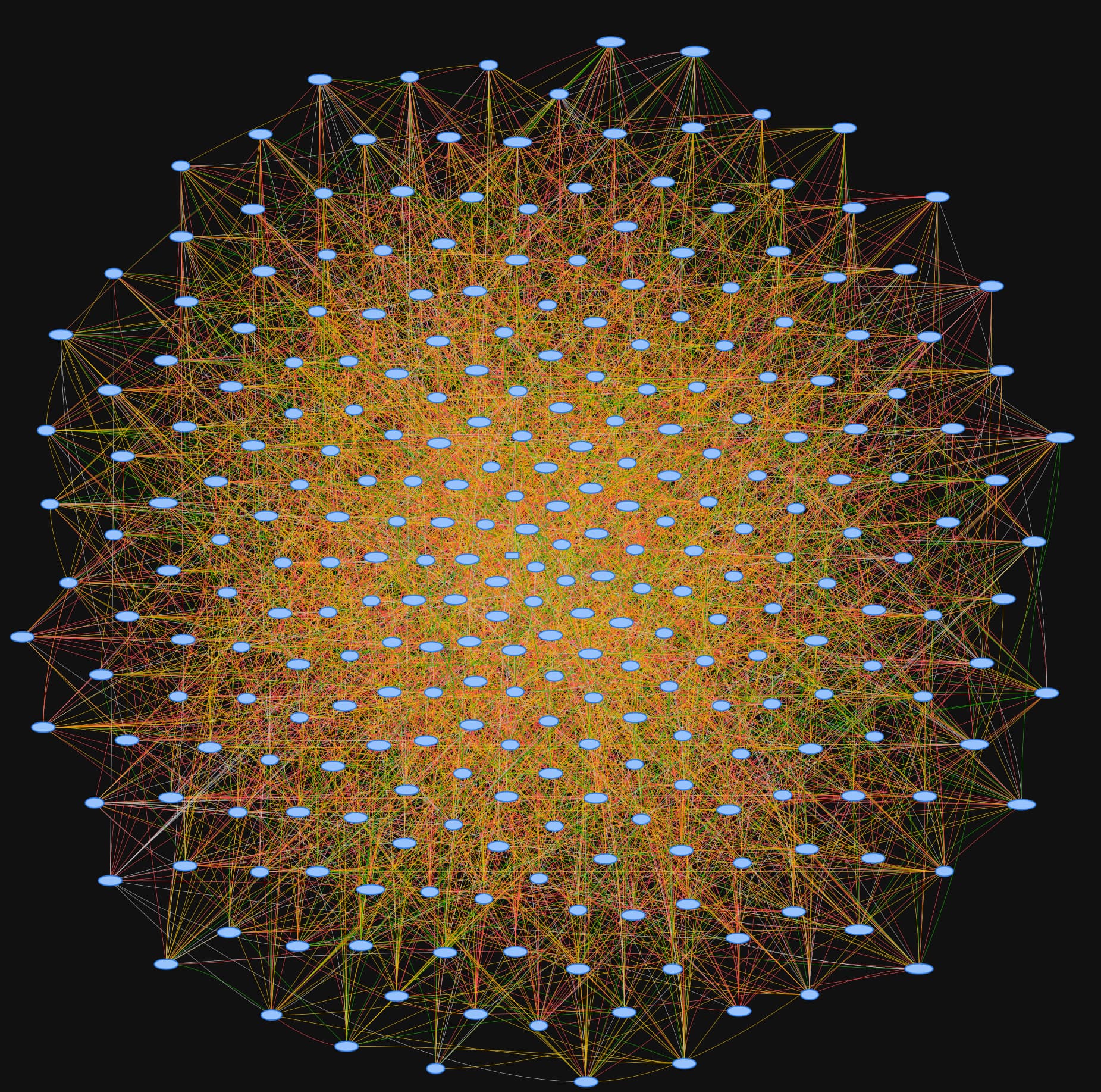

This looks like the most dense mesh I’ve ever seen.
Perhaps…I wonder what the largest operational residential Zigbee network size is. Should be over 300 devices by end of the weekend. Had to adjust my adaptive lighting routines and make multiples of the same settings and then have different time frames for adjustment checks. Like 567, 605, 633, 667, etc… so that chances are low that of multiple requests. Otherwise it would overload the network with broadcast messages changing 15 light groups with a single adaptive light setting.
Continue to be happy with the performance of the network. It takes a moment after a HA/ZHA restart for everything to be happy, but it is a LOT of devices to check in on. Just setup a Proxmox cluster and high availability for the VM to try to keep everything up and happy and be fault tolerant.
Still solid and have hit 312 devices. Should be starting the outside lighting soon, which will also be Hue lighting part of this Zigbee network. Things are still fast and joining actions are perfect. Construction workers tripped a circuit on Saturday that took down power to 1/3 of the house. Network adjusted perfectly and when the power came back on it, everything was perfectly happy.

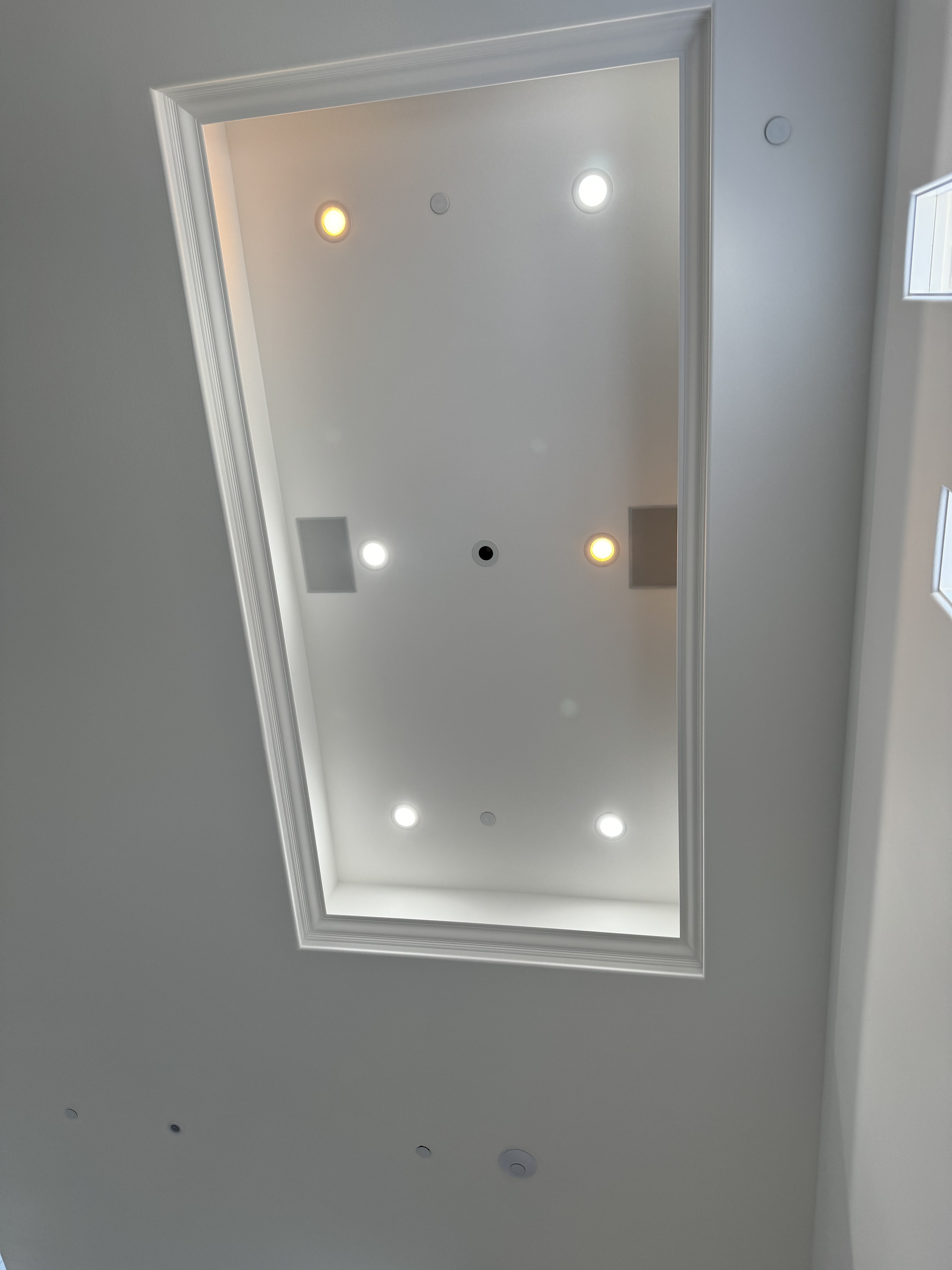

So I create Zigbee groups in ZHA and add the lights to them. Now I would not typically add the switch to the group, and it is not necessary to do that, but since I also control the lights via HA and HomeKit/Siri, I want the switch to reflect the status of the lights as they are used. I will use the latest example to likely cover all that you are looking for:
Install Adaptive Lighting (via HACS) - using this for brightness and temperature of the lights based upon sun position. They have taken up a request of mine to add in an offset for large networks to help prevent broadcasts overloading the network
In ZHA, go to the groups in the Configure page and create a new group
Add in the lights you want as part of the group
Add in the switch(es) you want as part of the group
(side note: if you are one switch to one light, I bind those directly without a group)
For this example, we have light_1, light_2, light_3, light_4 and switch_a, switch_b, switch_c
So four lights and with three entrances into the room all three switches are controls for the lights.
switch_a is the switch that powers the lights and is put in Smart-bulb mode
switch_b and switch_c just have constant hot and are configured in the 3way mode
Add all the lights and all the switches to the group.
Go to each individual switch and bind On/Off and LevelCtrl to the group
Also bind each switch to the other two switches
This allows for any switch to control the other switches and lights and always display the status. If I use the light switch, everything is bound and in sync. If I send a command via Adaptive Lighting, the brightness and on/off state is also reflected in the switch. If I use Siri to change the lights, that command goes to the ZHA group which changes the lights and switches at the same time.
In essence it is like I have a 4 way switch configured for the lights and all works perfectly. I am running this exact scenario in one of my rooms.

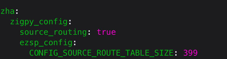

In addition to that coordinator, I have a tweak to the zigpy configuration options in ZHA that can be made in configuration.yaml:
This should allow for the device to store all the neede source routes for the network and this new device has more memory than the MGM21 devices allowing for more freedom. In addition to this setting, I tend to disable entities of Zigbee items that I am not using, so disable LQI, RSSI, and the power monitoring items of the Inovelli switches. It is data that is not important to my use case and I am doing my best to limit traffic to the devices.

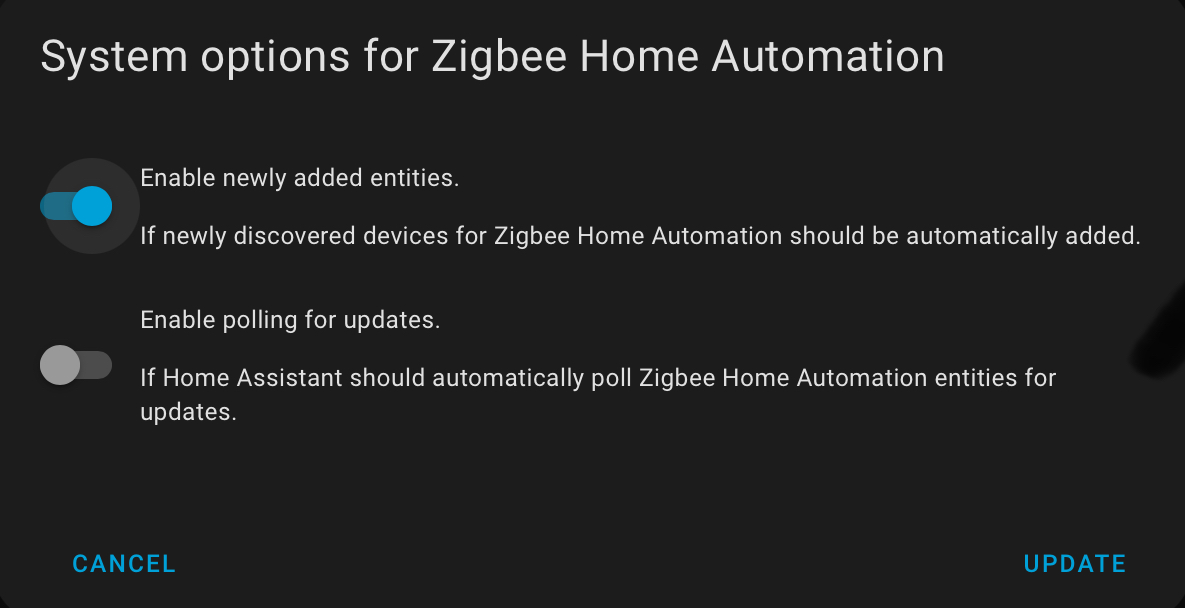

One more setting that I find helping reduce Zigbee traffic is to turn off polling entities for updates:
