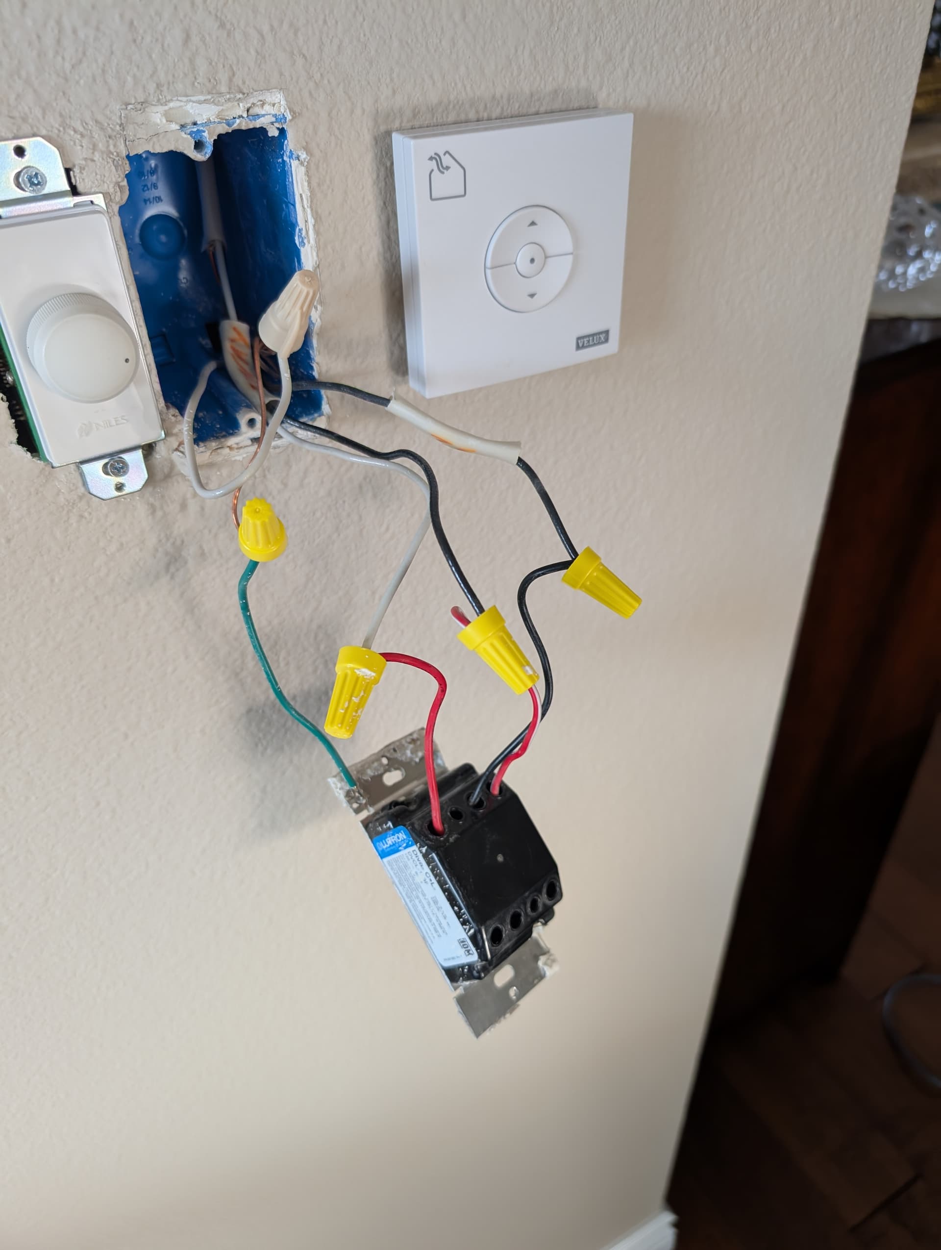

Hi - I’m having trouble mapping the Multi-Way (3-Way) + Dumb / Existing Diagrams listed at the help manual White Series Dimmer (2-1) Switch • Wiring Schematics and trying to map that to my setup.
I’m pretty sure it’s already Line/Load in Same Box or Load in Both Boxes based on my post-setup “On/Off Dumb Switch” setup:
(removed due to limit)
But I cannot figure out at all if I should have the white in my switch to be replaced go to load (as it’s weird it’s a white wire going to red right now) but I have two blacks.
I think I should follow Line/Load in Same Box and map the current black connected to red wire to traveler and then white map to load, but would love confirmation here. Thank you!

You’re going to have to post better pictures. For the dumb switch box, need to see into the box as well and trace all the connections. If you have to, pull the other switches to make the box connections more visible.
Better pics for the Diva box as well.
I have the feeling that instead of using a 3-wire between the boxes/lights, whoever wired this used two 2-wires, which isn’t incorrect, but it makes it more difficult to trace. That’s why the white is capped off. You should see a conductor capped off in the dumb switch box too.
Also, in the Diva box, there is writing on the sheath. What does it say?
If this is a line/load same box, you’d have four 2-wires for this leg in the dumb switch box. Maybe they’re there, but it wouldn’t surprise me if this is the lights between the switches.

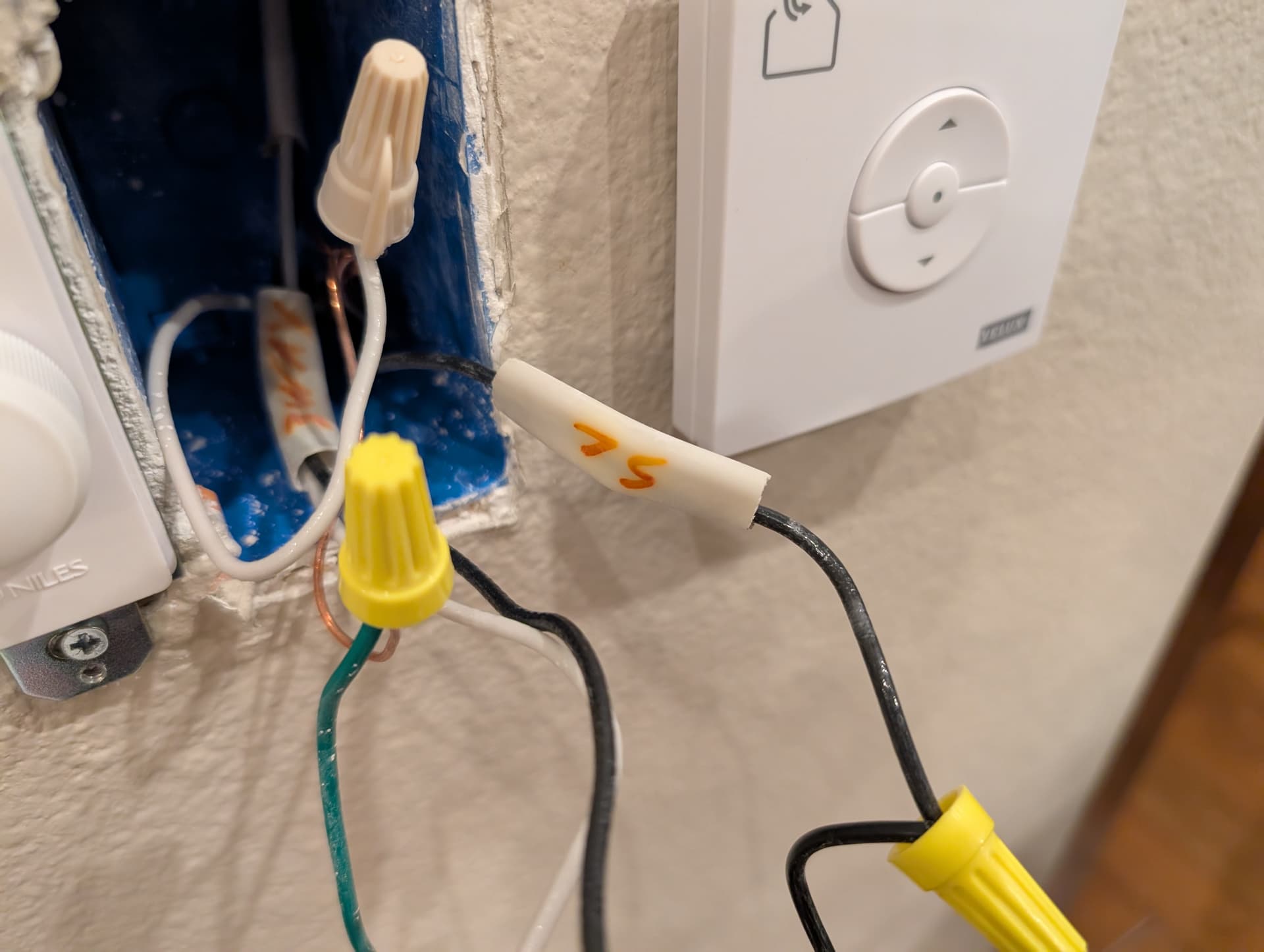

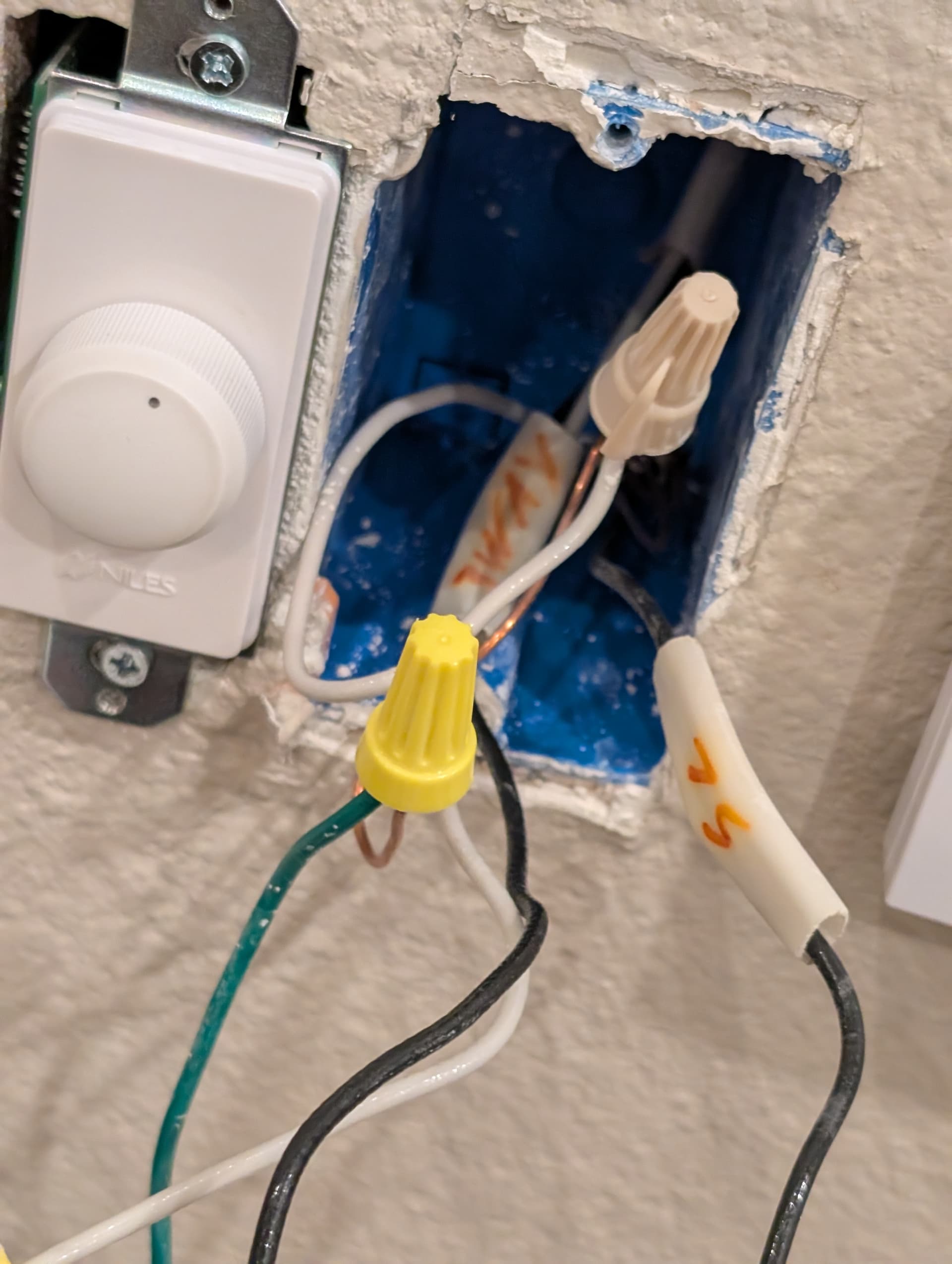

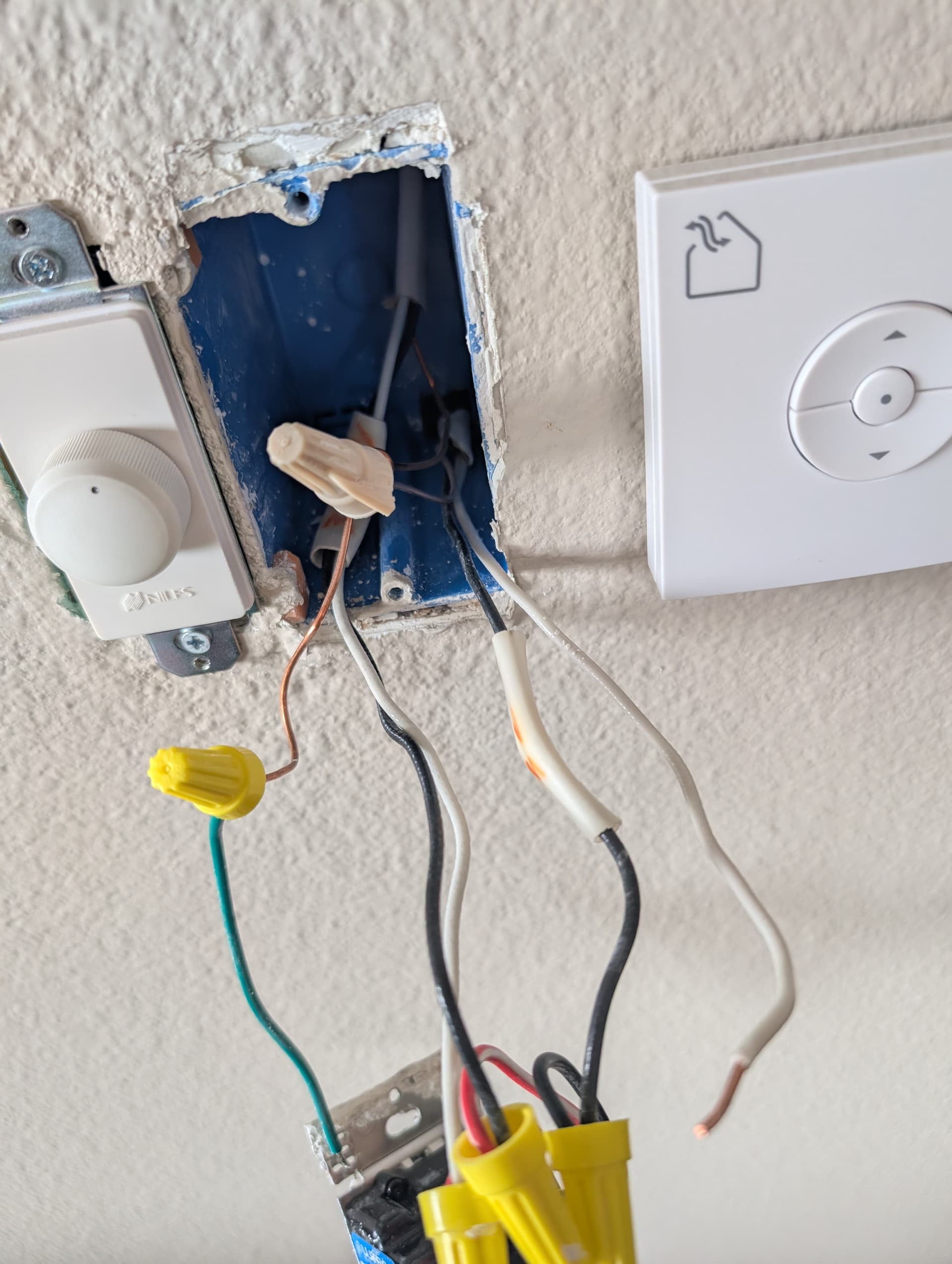

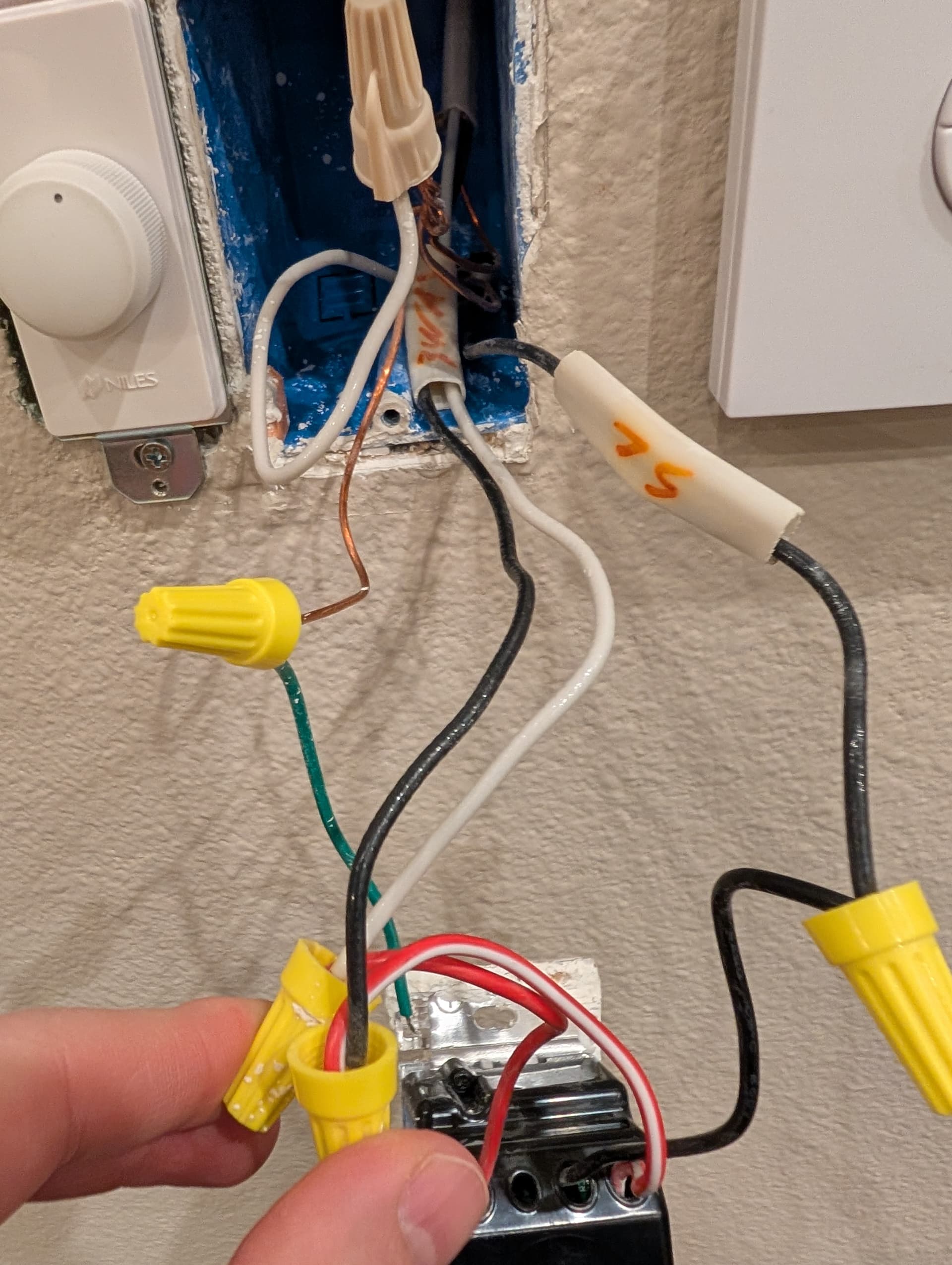

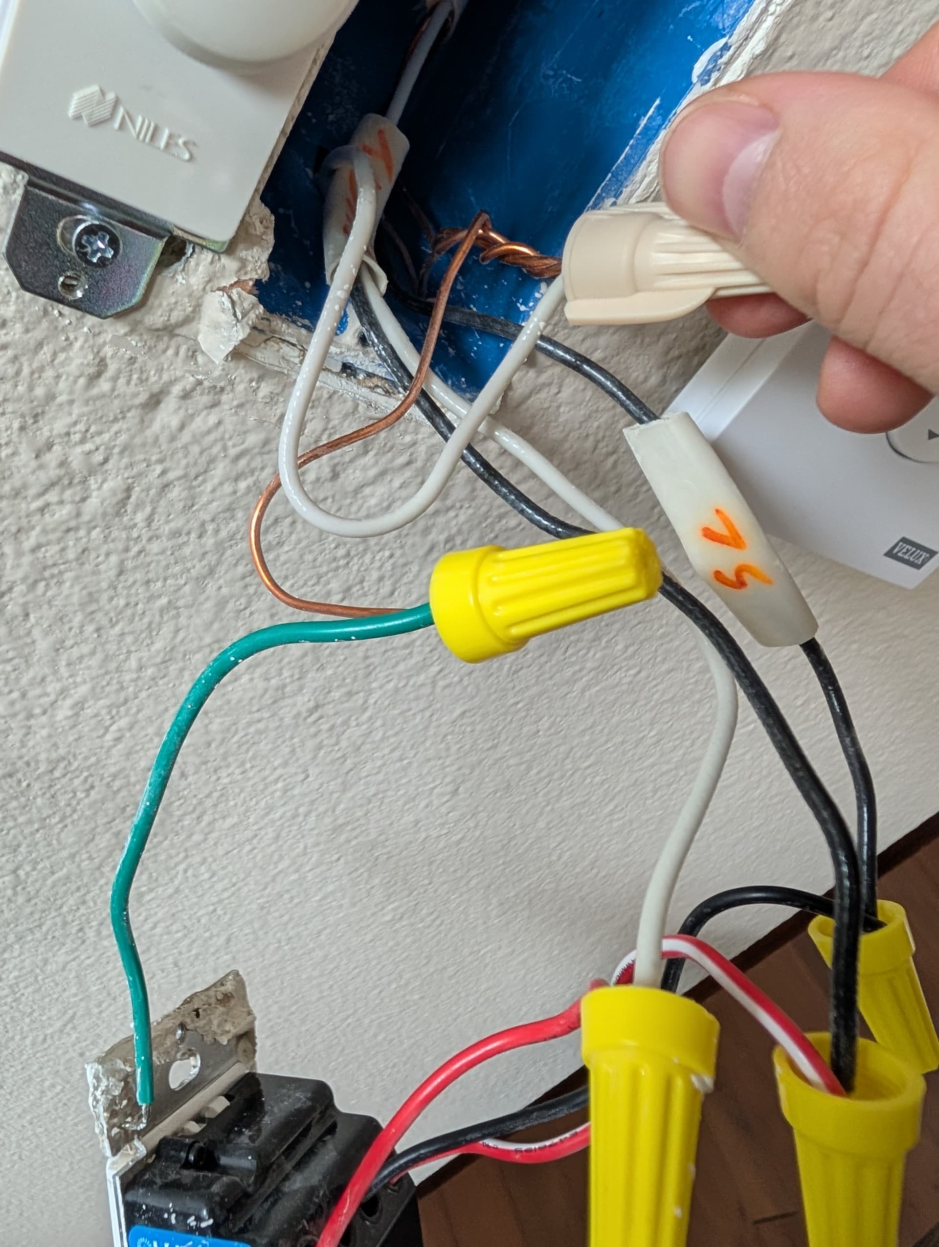

Thanks for responding. Here are the pix for the Diva box.
The black → black wire on diva is labeled “SL”
The black → red wire on diva is labeled “3-way”
The green → green wire is connected to another white wire in the box, which is completely separate from the green/ground wire.
Do you need more pix of the Diva? I will take deeper pix of the dumb switch tomorrow.
Good on the Diva box pics, thx.

Thanks. Does “SL” mean anything to you? I’m thinking something Light(s).
I asked if it was working because Divas are normally installed in the Line box, which I’m pretty sure is the dumb switch box. Unfortunately, Lutron only posts (that I could find) a Line/Load in separate box diagram, which I don’t think you have. So identifying based on the Lutron wiring won’t work.
No worries. This will take a bit but we’ll get it. I’ll take a look at the dumb switch pics when you get them.
Yes, SL = “Switch Leg” (according to a text from the person who installed it, who’s not in town anymore).
Agree, the lack of labeling on the Lutron box is incredibly frustrating.

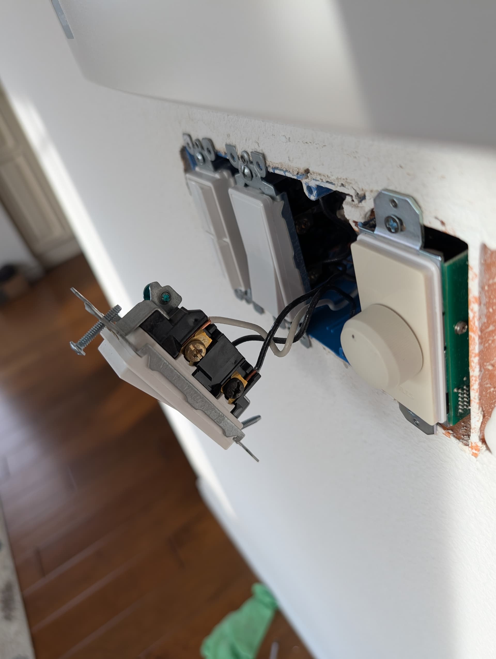

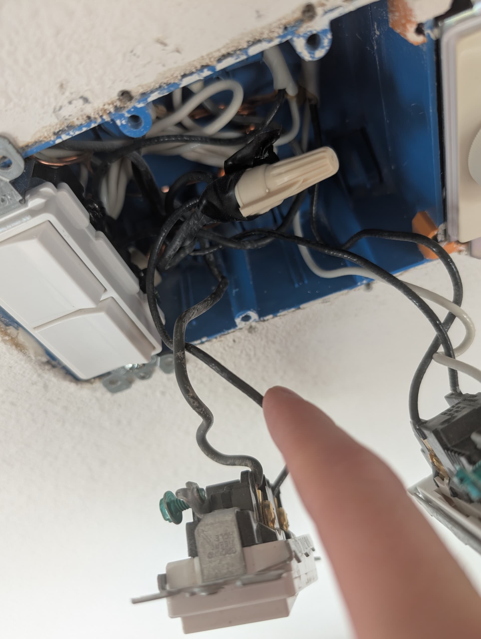

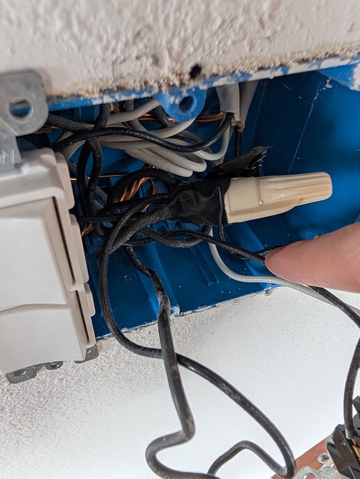

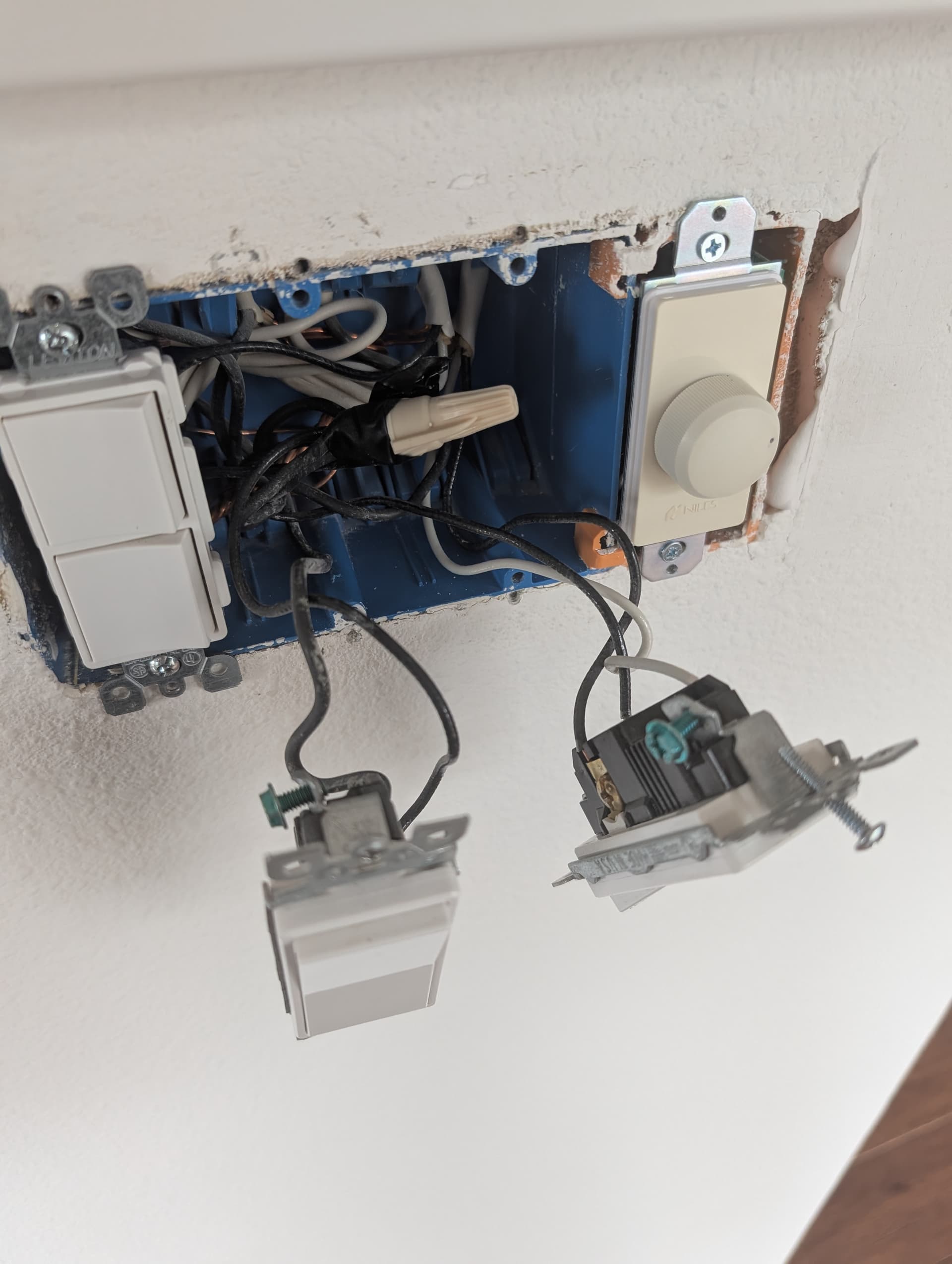

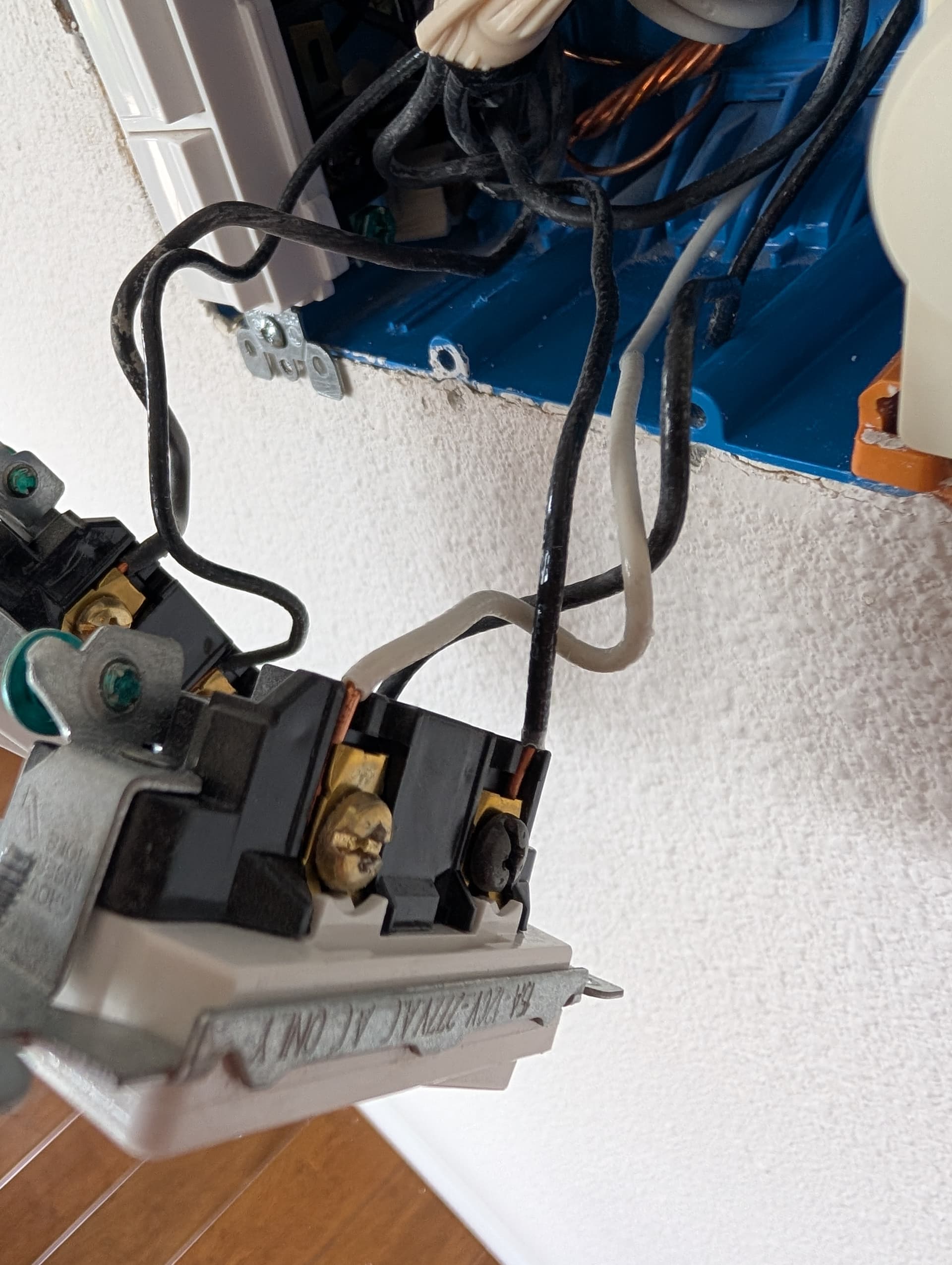

Here are the photos of the dumb switch.
The dumb dimmer is on the right.
The dumb dimmer and the other switch black that I’m pointing to are connected to the the same black line that is twisted together with the other switch I pulled out and others in the box.
Understood regarding the SL. Was the person that did that a licensed electrician?

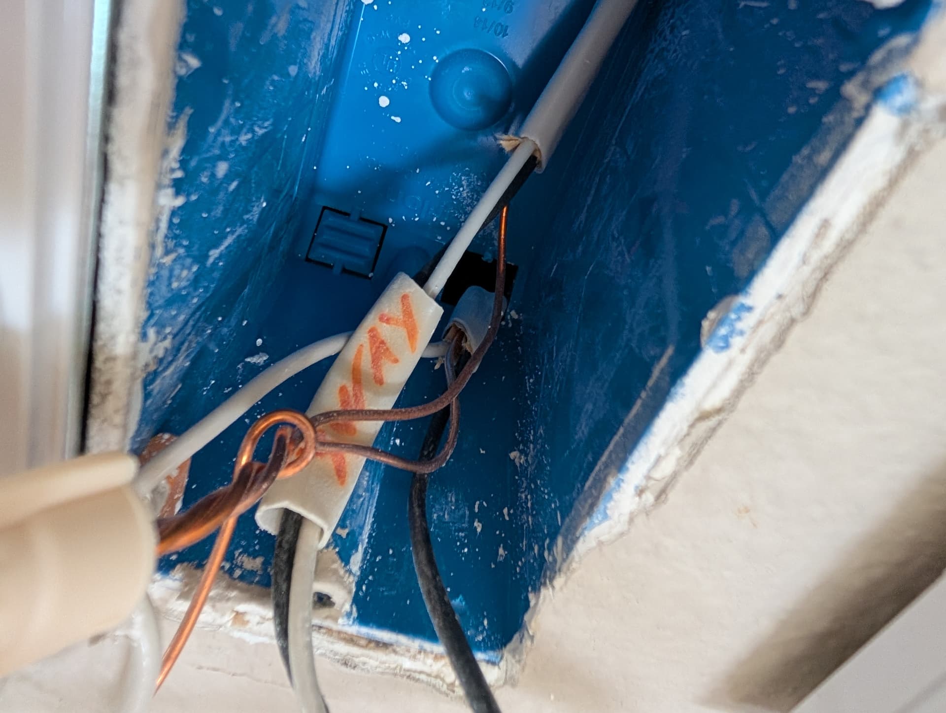

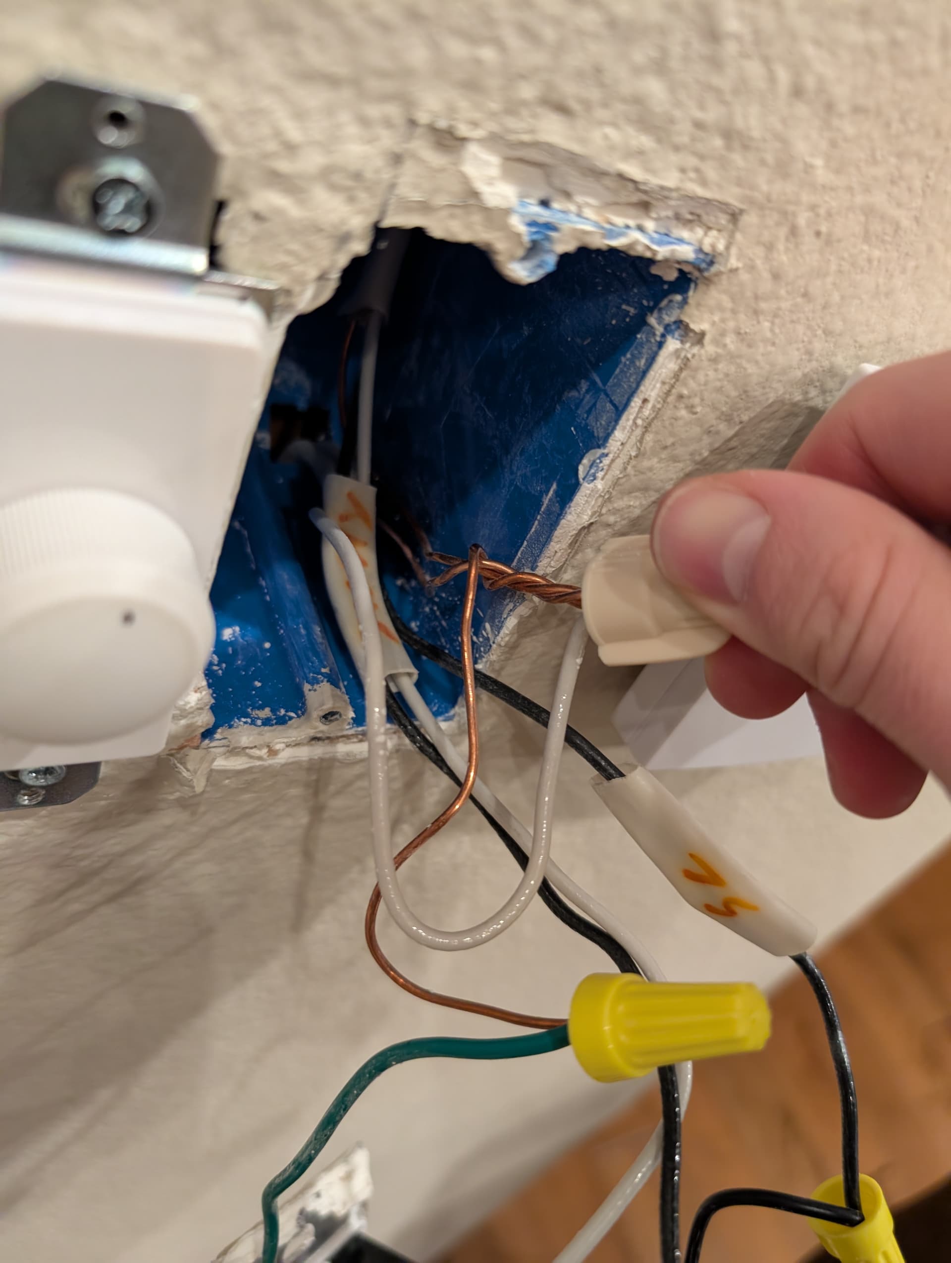

In the Lutron box, it looks like the white conductor from the SL labeled pair is connected to the ground. Was it like that when you started this exercise, or did you just connect it recently?
I’m not sure his license, he wasn’t hired by me as I got his information from the original owner… should I be worried :sweat:
Lutron box = original diva box I’m looking to replace? Yes, the white line is connected to the ground. The ground looks like it’s just wrapped around the box, see some more photos below. I haven’t changed anything yet.

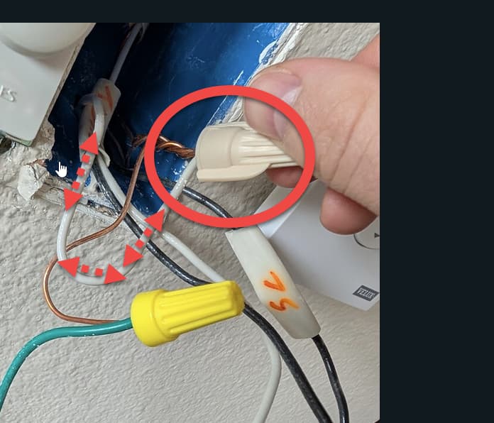

Ok, DO THIS WITH THE BREAKER OFF: Remove that white conductor from the ground bundle. Then restore the power and see if your lights still work with the white disconnected from the bare ground.
Done. The dimmer lights don’t work (either from Lutron diva or the dumb switch).
Thanks. As I expected.
The way those switches are wired violate the NEC or whatever code you’re subject to and most importantly, present a real safety issue. But I have a solution to get you out of this mess.
I’ll explain the problem first:
You do in fact have a line and load in separate boxes, as you first suspected. When you have a line and load in separate boxes, the power originates in one box and is sent switched to the other box, which then routes the switch hot to the light(s).
In your case, the line (comprised of a hot and neutral) originate in the box with the dumb switch. You can see the pigtail from the black (hot) bundle to the black screw of the dumb switch. The neutrals are bundled and tucked into the back of the box.
When you wire this properly, you need a 3-wire (not counting the ground) between the two switch boxes. The way it works is that you need two conductors for travelers and a third conductor to send the neutral. That load box needs a neutral because the load box has to send the neutral to the light.
In your case, you only have a 2-wire between the switch boxes, not the required 3-wire. So there is no neutral in that far box. The very improper solution: Attached the neutral conductor going to the light to the ground. So when you removed the white conductor going to the light from the ground, the lights no longer work.
Doing that is extremely dangerous and for that reason, the NEC prohibits it. It can result in a fire and shock hazard if something goes wrong, because the safety mechanisms have been circumvented.
