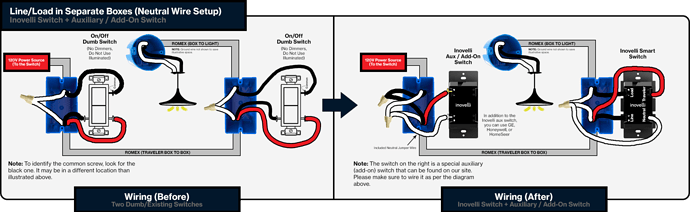

As an alternative, you may be able to do it with an Aux switch and the dimmer if you don’t want to use two dimmers.
It sounds as if you have a line and load in separate boxes, based upon your description of the downstairs box having a line and two travelers and a neutral going upstairs. If that is the case, the load is in the upstairs box.
So if that is the configuration, you can put the Aux downstairs and the dimmer upstairs. This is a wired solution, so no binding between the two switches is required.

I got an Aux switch and wired per the diagram. The dimmer works, but I’m not getting any functionality on the Aux switch. I configured parameter 22 on the dimmer to Multi-way switch with Aux. Is there something else I’m missing?
Disregard the last post, I double check the wiring, and the travel wire was loose. Everything is working as expected. Thank you for both of your help.
