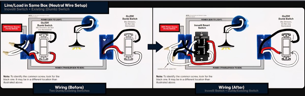

I current have this setup with a red series 2 in 1 on 1 side and a dumb 3 way switch on the other side wired like this.

If the diagram you posted replicates your topology, then that’s probably not it. There is a 2-wire going to the light, so there is no logical reason for the 3-wire to go through the light box.
OTOH, if you don’t have a 2-wire going to the light, then you are relying upon an incorrect diagram.
