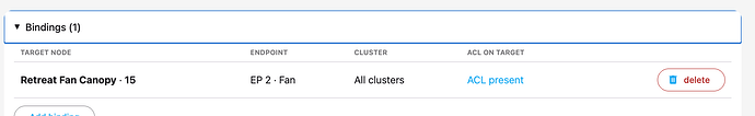

I have this the binding working just fine with VTM35 1.0.1r5 and VTM36 1.0.1r1.
Both are beta versions but they are easy to install with HA. The Beta version of both appears completely stable.
This is what the binding looks like. Once you get the beta versions installed you can make the config changes via HA.

I tried all three settings (I put the setting names from the current online white fan switch manual in parentheses below since they differ from what is reported by Matter to HA):
  • Default Behavior (Precision Mode)
  • Single Tap Cycle (Step Mode)
  • Tap Down Always Off (Loop Mode)
All work exactly as described in the manual via the VTM35 to VTM36 binding.
The VTM36 canopy reports the same speed as the VTM35 fan switch is indicating (LED and reported speed) and the actual fan speed matches the reported speed. (I turned all automations on those switches off for the test).
Note that the “mode select” settings in HA (above) are only available in software versions > 1.0.0. Also VTM35 and VTM36 firmware versions > 1.0.0 are based on the Matter 1.5 SDK rather than the original 1.2 SDK which appears to have significantly improved connection reliability.
Hope that this helps.
