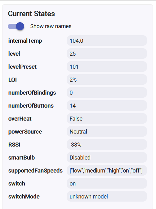

Setup a Ceiling Fan (Multi-Speed) and added it to Apple HomeKit via Hubitat.

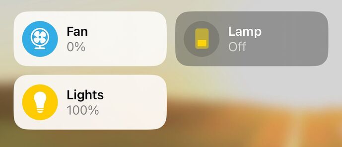

The fan shows up with the correct icon, but the fan % always reports 0%.
Has anyone else run into this issue?
I’m assuming this is more of a Hubitat-related problem, but figured I’d ask here first.

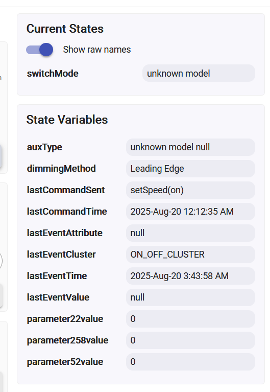

I’m also having this issue, so you are not alone. I haven’t found much on how to fix it.
For some reason, HomeKit is now reporting the fan speeds as 33/66/100 now, not stuck at 0%. However, when I try to change the fan speed within HomeKit, it usually freaks out. As I move the slider up or down, the percentage jumps all over the place, most of the time it doesn’t accept a change. I’ll have to make a video so this makes more sense.
I have another GE Fan Switch that doesn’t do this, which is why I think this is an Inovelli issue.
