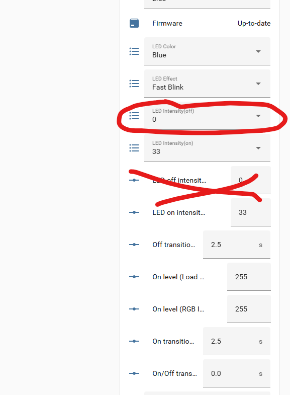

This most recent update seems to disable the functionality of being able to set the led intensity (on) to 0 to disable the led entirely. I use this functionality to indicate when my motion lights automation which controls that dimmer is enabled (led is dim when light is off and bright when light is on) and disabled (led is turned off entirely)
Now setting the led intensity(on) to 0 seems to have zero effect
Now that I think about it, would it be too much to ask for to have an LED effect that just disables all LEDs? That would make my life a bit easier trying to manage my automations
Using LED on intensity (Load Control) did turn it off, but the Home Assistant update disabled it. LED Intensity(on) does indeed do nothing on a value of 0.
@sebastianrasor are you referring to the firmware update or matter? I am able to change it. You do need to ignore the crossed out entities as they need to be removed and no longer work:
@sebastianrasor we actually do have an “off” notification on our other products. I will request it be added to the white series. It does exactly as you describe.
I am referring to the selector underneath the one you circled: “LED Intensity(on)”. Setting this to 0 has no effect.

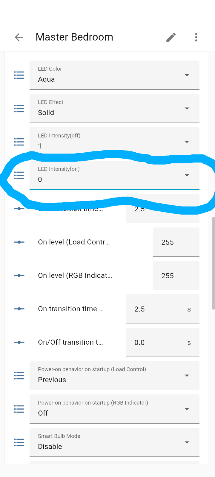

The prior firmware used a Matter custom cluster to implement this feature - however, Matter Custom Clusters are poorly supported (only Home Assistant supports them). The new firmware now uses a more “Matter standard” feature referred to a “Mode Select” which is supported on multiple platforms. That’s why you know see these drop-down menus with the available settings for the LED intensity when the device is Off and when it is On. So, with the new firmware, you use these “LED Intensity(off)” and “LED Intensity (on)” Mode Select settings (circled in blue in the post above) to achieve the result you are looking for. After a firmware update, Home Assistant doesn’t yet know to drop / disable entities created for the prior firmware - you need to reboot home assistant, and those numeric inputs you previously used will be greyed-out (“Not Provided” status) after which they can be deleted.
Ok. The “LED Intensity(on)” mode selector still has no effect when it’s set to 0.
@sebastianrasor I did confirm that this is a bug (LED Intensity (on) in 1.1.5 and will be fixed. Do you remember which version you upgraded from in which it worked?
I do not sadly. I think I had already upgraded the switch firmwares to 1.1.5 and was still using the number input just fine, it seems this has only happened after upgrading to home assistant 2026.3 but I can’t say for sure that’s a causal relationship and not just a timing coincidence (I only went down the path of updating my automations to use the new selects after upgrading to home assistant 2026.3)
