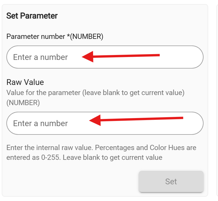

And just to verify that the set param did not hold?
Does not work there, tried many times with multiple switches.
