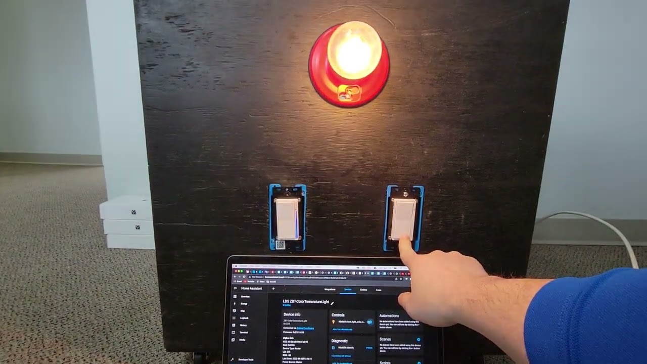

@terrence.bentley - quick update.
Caveat is that there is still a 100ms delay built in bc I still wanted scene control.
We are still working on group bindings and I had some issues when multiple bulbs were used, but we’re working through that.
I didn’t have a control of a hard wired light, but this seemed crazy fast.

In the first few seconds of the video showing just on and off, I find that really, really, really slow response time. It looks like 700ms+, maybe even 1s+.
Dude, watch the video again. From click to change in the light is damn near instant. Watch the toggle in HA vs the bulb.
Edit: Here is a frame where the light is ON and the toggle is still acting on the HA dashboard lol:
Oh sorry, I just posted when you posted this new videos.
I’d say this is pretty fast, but slower than @terrence.bentley setup and my pico setup. Still, very very promising!
I’d ask you to watch the video again. From actual trigger to actual action I can’t get more than 1 frame, which is 1/60 of a second (it’s a 60hz video per YouTube) or 16.6 ms. Imperceptible.
We may have to agree to disagree on this one bc I literally can’t tell the difference. I do wear glasses though lol.

I’ll respond to the comment regarding the newest video showing the very fast, but not (to my eye) instant response:
@kreene1987 - thanks for suggesting looking at this frame by frame, I hadn’t thought of that and is a clever way of trying to track the precise milliseconds of delay.
I counted at least 12 frames between when the finger starts leaving the button and when the light turns on. I can’t be 100% sure the exact frame where the button is depressed so I rely instead on when the finger starts to leave the switch. Here’s what I did:
- I visit the video at the 5s mark here
- I pause the video at the 5s mark, and use “.” to move forward frame by frame as I watch the finger move towards the switch. I go until I see the finger start to lift off the button, then I use “,” to move to the point right before the lift off.
- I count how many “.” presses it takes to see the light turn on. I can count at least 12-13 frames, but I think the reality is closer to 19 frames+ from the moment the switch is pressed. When you frame by frame you can see the finger has time to retract and form almost a fist before the light turns on.
Here’s a screenshot of the finger on the button:
And the screenshot of the hand retracting, this is the exact frame before the light turns on, and this is 12 frames from the top screenshot when the finger is starting to move away from the switch:
12-15frames on a 60Hz video is 200-250ms of delay. Which is fast, but not instant. And I’m pretty sure the delay is higher than that when I listen to the click vs seeing the light turn on. It’s much harder to tell when moving back frame by frame when the exact moment the button is clicked, but I am certain that the minimum is 12-15frames, and probably closer to 19-20 frames (which is near 320ms). I won’t bore you with how I determined the 20frames, which is when I think I see the top button moving by about 1px. I am also 100% certain my pico setup and I’m pretty certain @terrence.bentley setup is faster, without needing to do frame by frame counting.
I’m not trying to be pedantic, I am very good at spotting visual timing delays down to 200ms ranges. I understand many users cannot and may consider the video to be instant, and I do agree it’s very good. The definition of “near instant” is also going to vary from user to user. I am telling you with conviction that there are smart implementations out there are that are faster than depicted by the video, and also so that anyone pursuing “instant” response can know that a smart switch has in practice turned on a smart bulb faster than depicted in the video.
PS. I would not use the toggle in HA dashboard to determine when HA detects the event.
In HA, go to Developer Tools > Events and start to record the exact events. The UI toggle is much slower than the actual event detection by HA. For me the UI toggle can be 500ms or more behind the actual event.
Edit: I don’t want this to seem like I’m trying to to take away from how good the switch looks to perform. I, and I am sure everyone else, really appreciate @Eric_Inovelli’s responsiveness, passion and willingness to really engage with us for this project. Just look at the videos he’s making and the lengths he’s going to test these setups and respond to inquiries. Cheers and thank you.
I’ll say this… The human eye can indeed register delays as short as 13ms. So it’s possible that some will perceive anything faster than 13ms as “slow”.
Now don’t forget, there is a built-in 100ms delay that’s programmable and on. So if you’re saying 200-250ms, the switch is pausing for 100ms of that before doing anything at all. This is by design for multi-tap and can be disabled if a user doesn’t want it. So realistically that 200ms is really only 100ms.
Now I’m not a frequency expert, but from my understanding Lutron uses a frequency down in the RF range somewhere while Zigbee is in the 2.4ghz range. The higher frequency should transmit signal significantly faster. And since binding is sending the command direct from switch to bulb and bypassing the hub, I would expect any Zigbee binded switch/bulb combo to be faster than a Pico remote.
