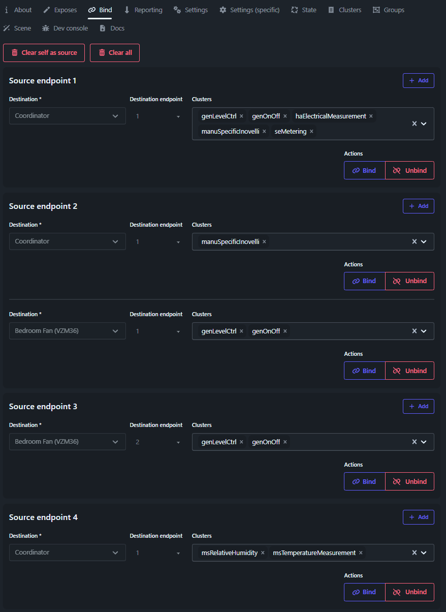

I have this set up like this in 2 different rooms, with a VZM30-SN and a VZM36 using Dual Zigbee Bindings. You can still use the multi tap settings to trigger automations, but that way you don’t NEED to use automations to control either the fan or lights. The switch works essentially the same as the dimmer when bound to the canopy module.
You would bind EP2 on the switch (paddle) to EP1 on the canopy module (light) and EP3 on the switch (config button) to EP2 on the canopy module (fan). You also want to set the FanControlMode on the switch to either Multi Tap (1 tap for low, 2 for medium, 3 for high, hold for off) or Cycle, while setting the switch to Smart Bulb Mode so the contactor doesn’t click every time you turn the lights on.
I don’t use Hubitat, but rather Home Assistant with Z2M, but here is what my bindings look like for my VZM30-SN if it helps.
