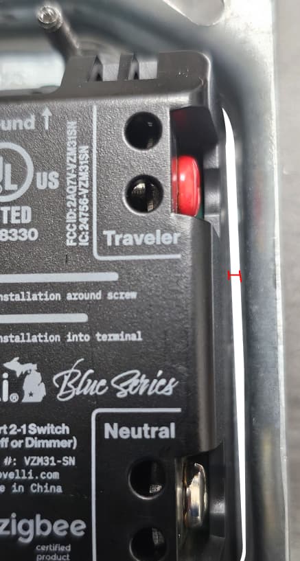

The 2 devices have to be spaced at the distance the current plate allows before the faceplate (screwless or not) gets put on, so I’m still not seeing the point. If they can be that far apart once in the box then they’ll fit into the box during installation with the current faceplate.
In the picture you showed, the edges of the mud ring need to be filed down to get them to fit right.

Let me try my best to illustrate. Maybe you and I can also talk via Teams to make it quicker.
This is how it looks now. The front of the switches (metal plate) are touching and that allows the perfect spacing between the faceplate holes (circled in red) as you correctly pointed out and is the current point I’m going back and forth on.
Here’s where I think I needed to do some better explaining as to why I’m targeting the metal plates vs the back of the switch.
The best way to fix this issue (aside from shaving the mud-ring) would have been to shave the sides of the switch down so that there’s some wiggle room to push the switch into the gang-box.
In other words, keep the metal plates the way they are so that the faceplate screw holes line up correctly, but shave the sides down so that you can get the switches in and then move them into the correct place.
The problem is that we can’t shave the sides of the switches down as it will cause structural issues and also there’s no room on the PCB to adjust the sides in.
So, the only option is to remove part of the metal plate so the customer could at least get the two switches screwed all the way down and flush. The holes at the top wouldn’t be aligned for the faceplate, but once the switches were basically flush (and at least in the box), they could they could move the switches left to right to get it lined up for the faceplate.
I don’t really know how to illustrate this :confused:
But I’m wrestling with the fact that this may have unintended consequences for people not using the mud-ring (the majority) as it would make it harder to put the faceplate on bc you’d have to line it up (whereas before all you had to do was make sure both sides of the metal plate were touching each other.
As much as I’d like to say to just sand down the mud-ring, unfortunately what’s driving this change is that these switches have caught the interest of builders and there will be a ton of huge projects that will be installing them and if they put mud-rings in 1,000 units, I can’t really ask them to sand down all the mud-rings and these would be a pain to fit as shown in my original post. I couldn’t get the switch to fit when they were side by side since there were so many wires in the back.
“as it would make it harder to put the faceplate on bc you’d have to line it up (whereas before all you had to do was make sure both sides of the metal plate were touching each other.”
But this is already true for virtually all regular decora switches and outlets that I know of, so I don’t think that it is an issue. Usually eyeballing the center of the screw slot is accurate enough (and you could engrave little slot center marks on the plate if worried).
Also, test with the face of the mudring not exactly parallel with the face of the wall, as having the extra space may be helpful here.
And with the blue Ideal bands that go around the switch and cover the screws, in case they are required to be used.
Why don’t you shrink the edges of the metal plate, and then include a plastic spacer in the box? The purpose of the spacer is to get the proper spacing of the switches aligned for the faceplate. Maybe even find a way to include a level in the spacer so that my spacing is correct and the switches are level before I attempt to put the faceplate on.
Agree that changing for the sake of a minority use case is tough. What about break off tabs that the minority users could break off if needed?
Did you get a tooling quote to make some custom mud rings and not change the switch dimensions???

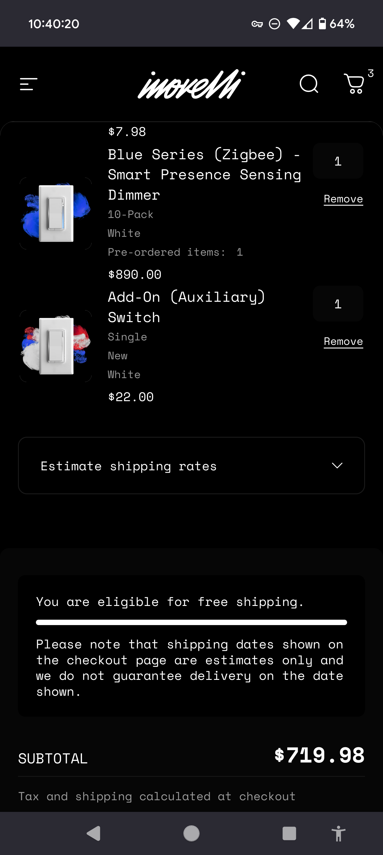

I was about to pre-order and had it in my cart to contemplate, but when I tried to check out today, I saw that the pre-order price is no longer available.
Am I too late to the pre-order? :cry:
The cart is a bit confusing, but I think you are OK. The detail shows the list price ($890.00), but the subtotal looks like it’s got the pre-order price $690.00 (Pre-order) + 22.00 (Aux) + 7.98 (not sure what!) = $719.98

For some odd reason, the cart had the old price listed, but the website had the full price. I tried to proceed to the checkout, but instead of the pre-order price ($690), I was met with the full price ($890). That’s why I was wondering if I was too late that day.
I’m assuming that the pre-order price is no longer valid, as I don’t see that price anymore anywhere.
