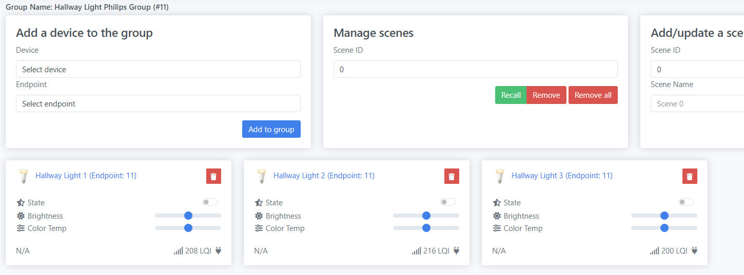

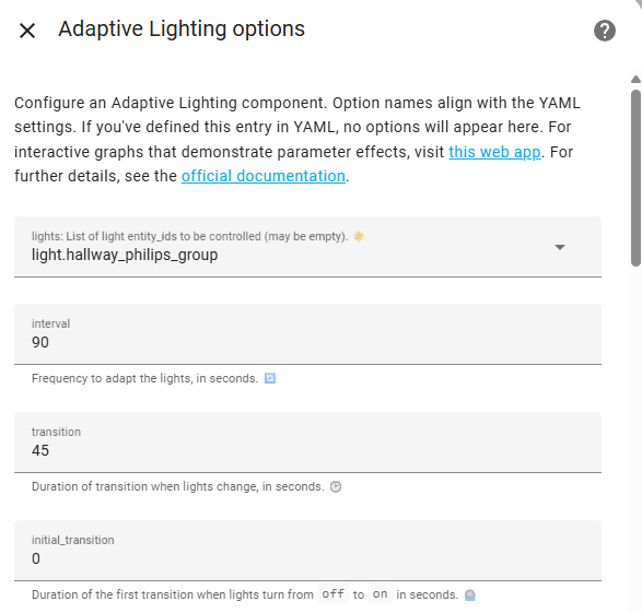

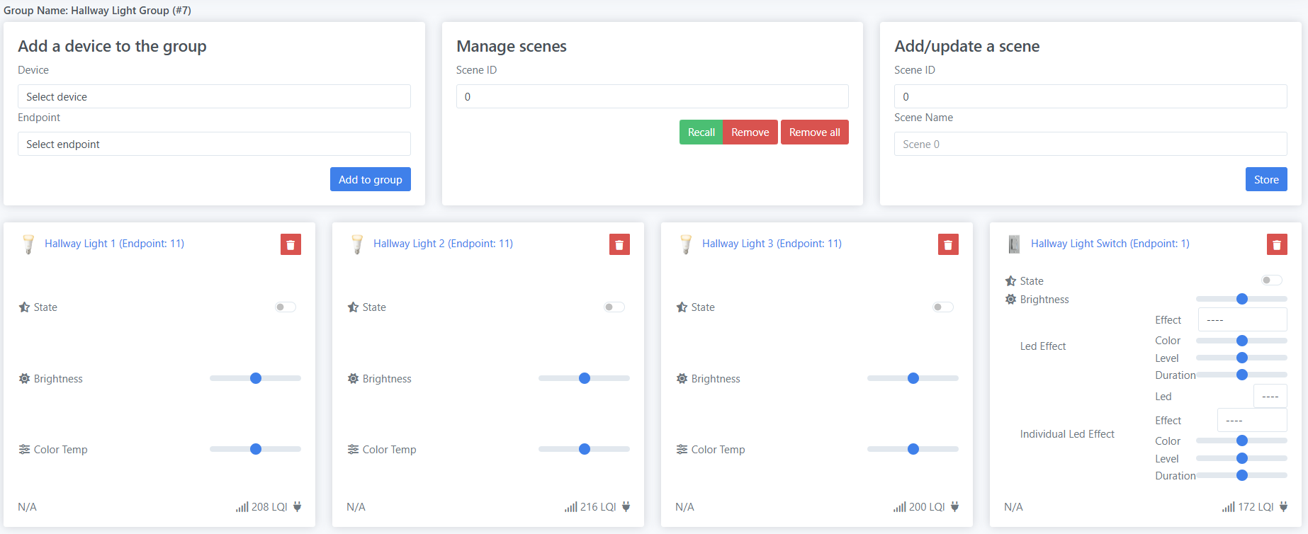

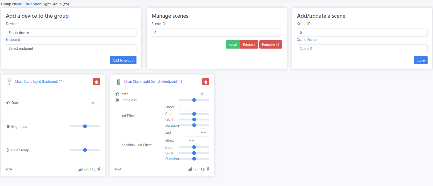

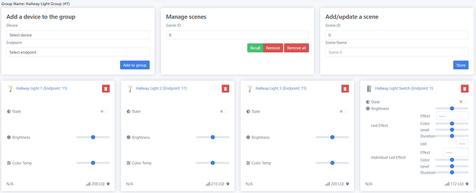

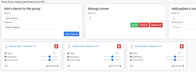

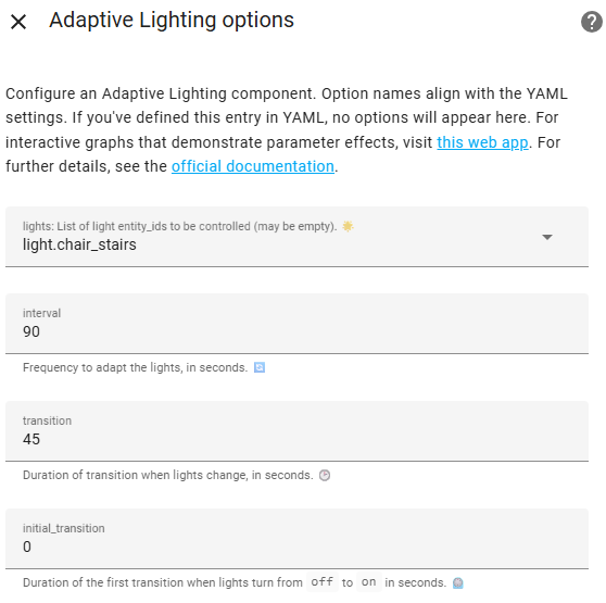

Some examples below. I will start with a single bulb circuit with an Inovelli light switch.
Z2M Group
Adaptive lighting
This one is also included in a motion sensor automation that I point at the Z2M group to keep the LED bar matched to the brightness.

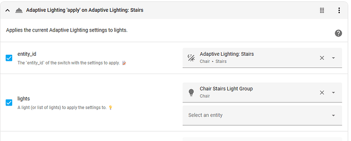

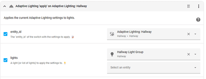

The second example is a circuit with a single switch and multiple bulbs.
Z2M main group
Z2M bulb group
Adaptive Lighting

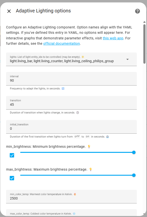

I think what I’m not understanding is how the LED bar is kept in sync if it isn’t part of the zigbee group.
It is part of A zigbee group. Just not the one that primes the bulbs for me. The bulbs are part of a group with the switches though. The only thing I can figure is that whenever anything happens to a member of the Z2M group, all members of the group are kept in sync. That is my only guess because all of this gets very confusing with settings in multiple different locations.
All I can say is that it works for me and my situation. I get instant transitions. The bulbs turn on to the right color. No funny business with lights showing on, but not actually being on. It finally works for me.

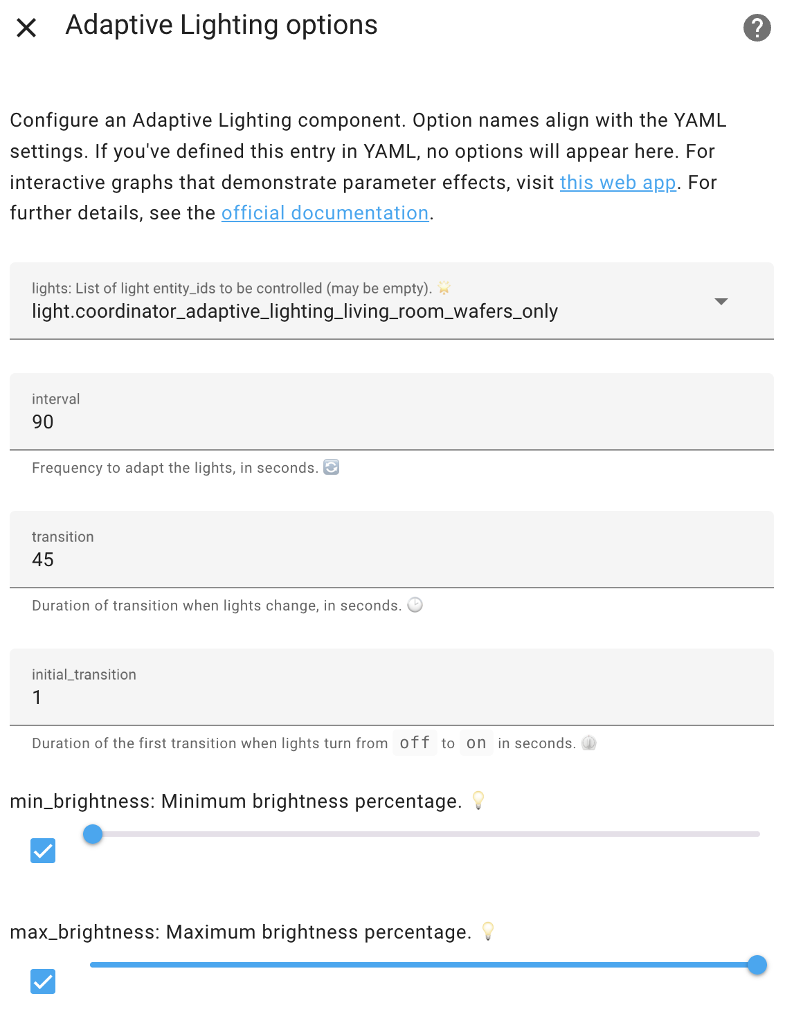

  3. Could I ask you a favor? Could you screenshot your configuration screens a little larger/less cropped? Just trying to follow what you’re doing.

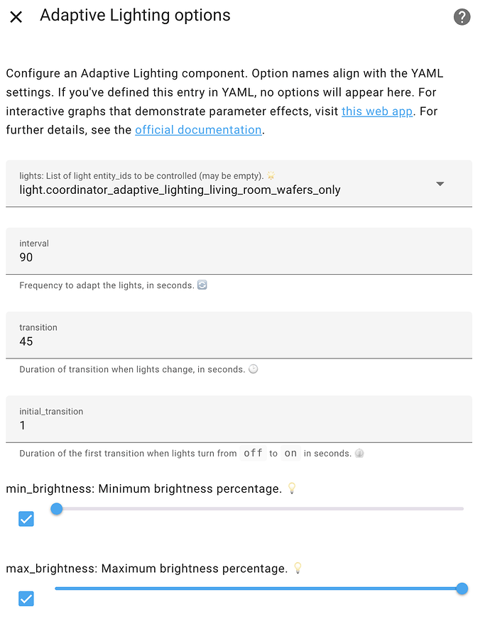

My configuration for the Adaptive Lighting HACS device looks like this:
-Jonathan
  1. Yes. I do not let Adaptive Lighting control my brightness with the exception of a couple of lights that have Sleep brightness applied.
  2. The automation I am referring to is posted above for priming the color temp on the lights when they are off. You can scroll through this thread and there is discussion about the automation I am referring to.
  3. See below for a more complete screenshot.

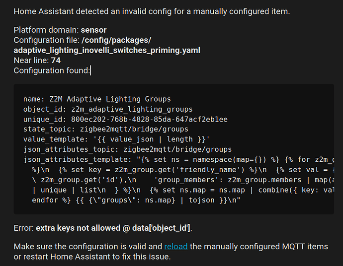

I added this into configuration.yaml :
homeassistant:
  packages:
    adaptive_lighting_inovelli_switches_priming: !include packages/adaptive_lighting_inovelli_switches_priming.yaml
and then created the file ‘packages/adaptive_lighting_inovelli_switches_priming.yaml‘ and pasted in it the whole code from https://community.inovelli.com/t/adaptive-lightning-settings/16242/90
Unfortunately, upon retarting HA, I got this error message:
Here is what Claude AI told me. I don’t know why ‘object_id’ was included in initial code, but by removing them in both mqtt sensors the error message disappeared.
The problem is clear. Line ~74 corresponds to the MQTT sensor definition:
mqtt:
  sensor:
    - name: Z2M Adaptive Lighting Devices
      object_id: z2m_adaptive_lighting_devices   # ← HERE is the problem
object_id is not a valid key under mqtt: sensor:. It belongs to the template: platform and other integrations, but not to MQTT sensors defined in YAML.
To control the entity_id of an MQTT sensor in YAML, you have two options:
Option 1 — Use unique_id only (recommended)
HA generates the entity_id from the name. With name: Z2M Adaptive Lighting Devices, you automatically get sensor.z2m_adaptive_lighting_devices. The unique_id is already present, which is sufficient. Just remove both object_id lines:
mqtt:
  sensor:
      # object_id: z2m_adaptive_lighting_devices  ← remove
      unique_id: b0fbc6ea-b025-4413-9985-0737873d96a0
    - name: Z2M Adaptive Lighting Groups
      # object_id: z2m_adaptive_lighting_groups   ← remove
      unique_id: 800ec202-768b-4828-85da-647acf2eb1ee
Option 2 — Rename to force the desired entity_id
If the generated entity_id doesn’t match what you want, you can adjust the name accordingly, or rename the entity via the HA UI after creation.
Since name: Z2M Adaptive Lighting Devices produces exactly sensor.z2m_adaptive_lighting_devices, removing the object_id lines should be sufficient without breaking anything else in the package.
