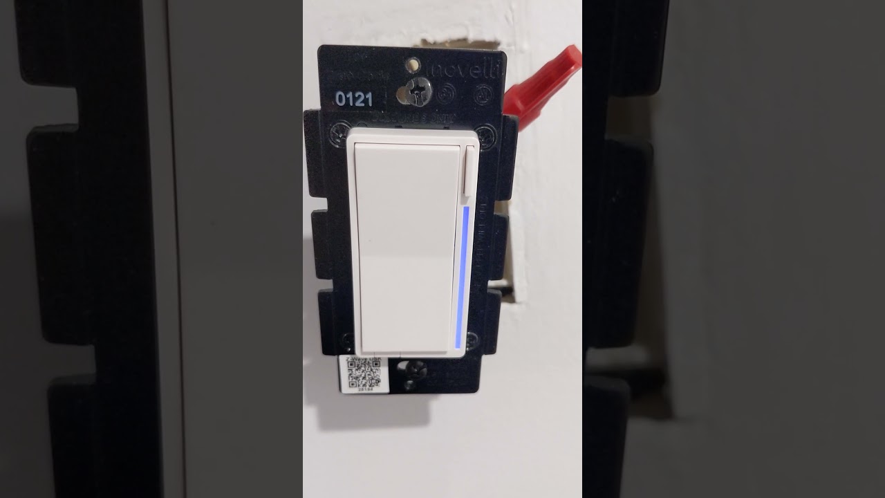

I have recently connected an LZW31 dimmer with a GE Enbrighten Add-On Switch (46199).
My current configuration has no neutral, and the power comes from the light. I have replaced my switches using this configuration:
After the wiring, I changed the switch to Non-Neutral, (Config Mode-> Configx12 → DOWN 1x) and Changed to Aux Switch, (Config Mode → Configx13 → UP 1x).
When I made the change to the switch configuration, the add-on switch worked but every time I turned it OFF, the inovelli smart switch would click loudly, turn the lights back on then off quickly, and cycle the LED bar from red>green>blue.
After a few times of turning ON/OFF like this, the light starts to strobe out.
Any assistance would be greatly appreciated!
