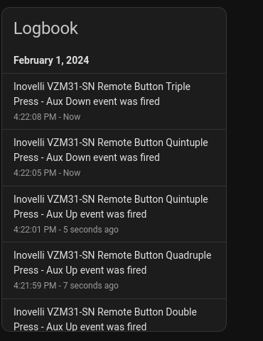

Blue Series 2-1 with Aux Switch - Help Understanding Events for Automations
Wow, very interesting- this is what I was looking for. Thank you!
If either of you are willing to test and are familiar with setting up a custom quirk, I believe this update will fix the issue -
(just add these 2 files your custom quirk folder named zhacustomquirks, or if you already have a folder, just change the import in VZM31SN.py “from zhacustomquirks import INOVELLI_AUTOMATION_TRIGGERS, Inovelli_VZM31SN_Cluster” to reflect your folder name)

Assuming that works as expected, I’ll get a PR in to update the quirk properly and you won’t need the custom one once it’s live.
I’ll try it tonight. Thanks @chack
Good to go. @chack
Awesome, I’ll get a PR in for it tonight, thanks!
Y’all are amazing - thanks very much.
Just following up on this, I don’t have an aux switch setup to test but I do believe that @chack put in a PR to get this functionality sorted out.
