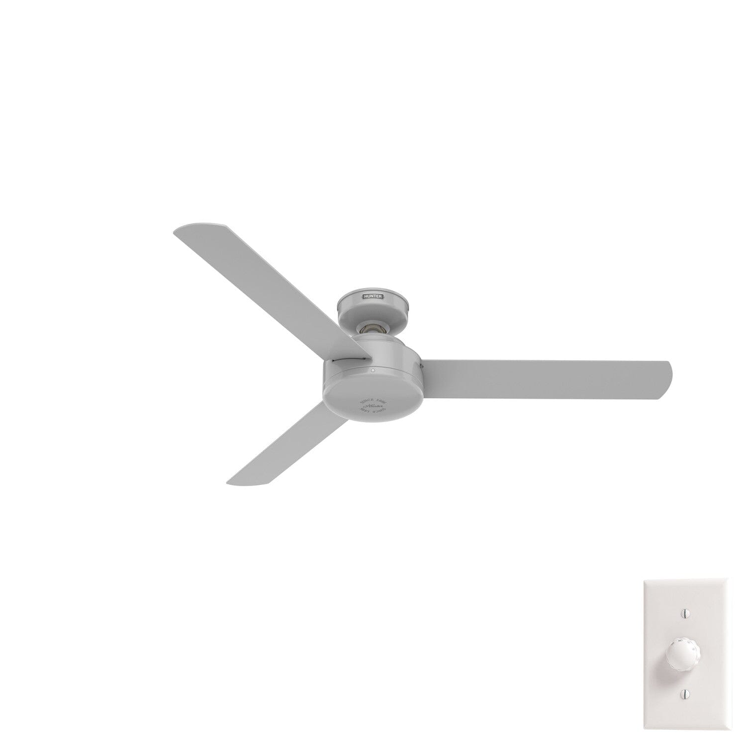

I’m looking to purchase a new fan to be controlled by a blue series fan switch when they become available.
Can anyone confirm if the Hunter Presto is compatible? It is an AC motor and ships with a fairly simple switch from the factory.
Thanks for any help!
That fan looks like it should be compatible. The only slight odd part is having a black and blue wire in the fan, but I suspect the blue wire is for a light kit (not included).
