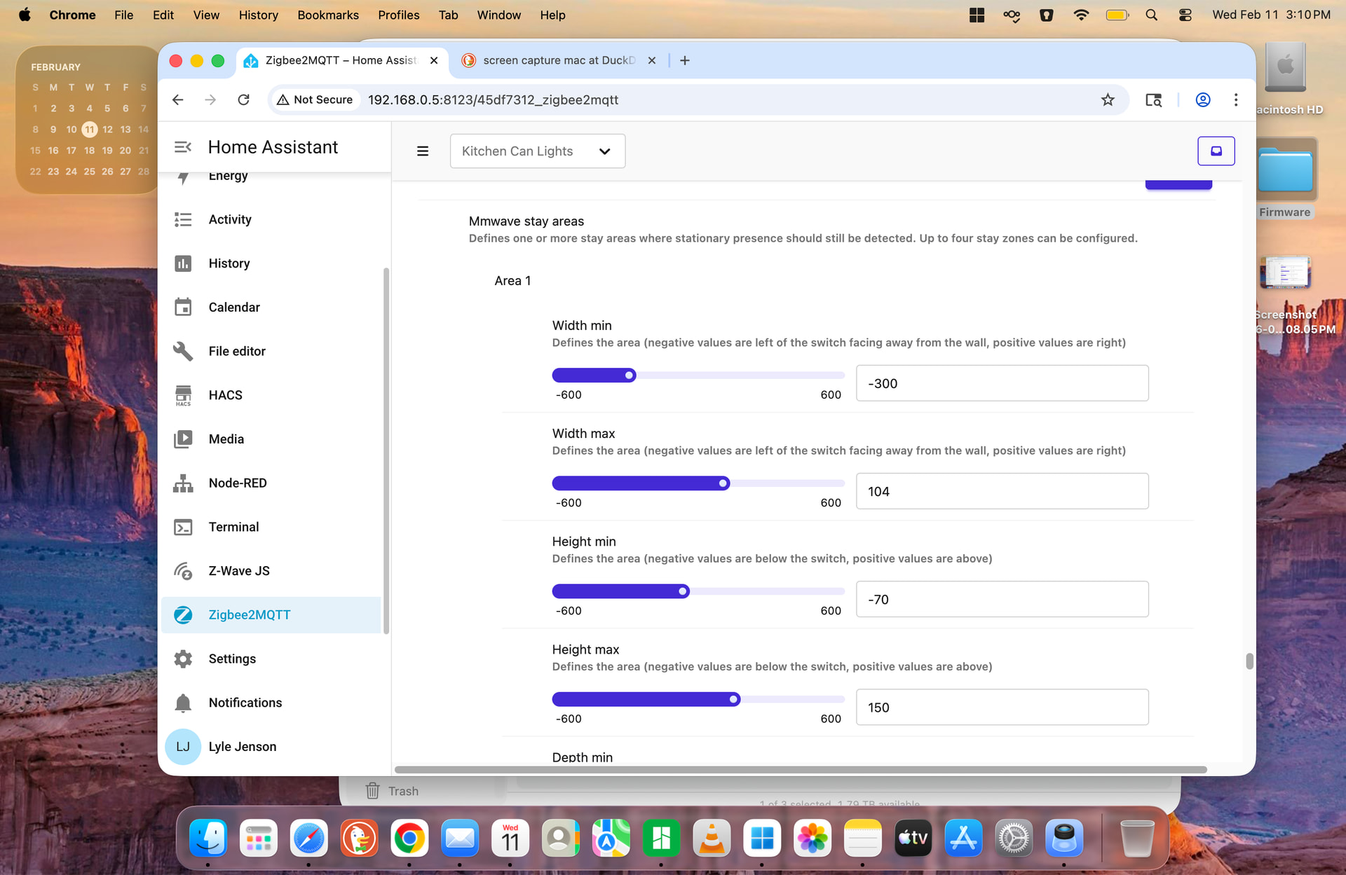

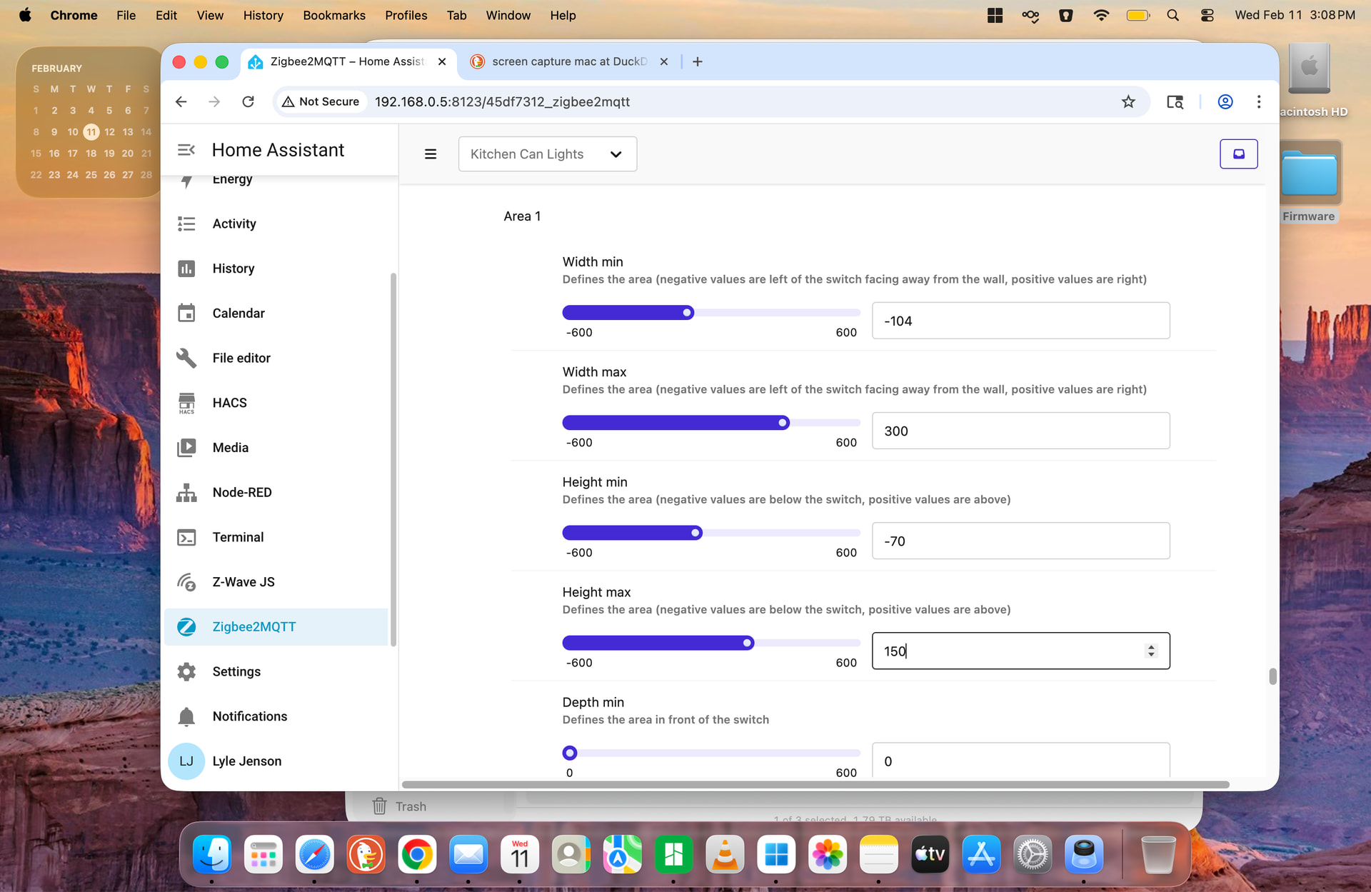

In Home assistant (ZigBee2MQTT), if you set the stay areas (in my case Area 1), and apply them, under STAY AREA, go back in and it swaps the Width min and Width max numbers. Changed 3 times, and it swaps the numbers when you go back in to the settings page. I cleared the stay areas, and tried again, same thing happens. I am unsure if the original 1.00 does this, as all the mmWave are running the beta.
It did fix the switch not working after changing the “LoadLevelIndicatorTimeout” from 1.00 however.

Notice my stay settings below when I set them, and afterwards hit “APPLY” to save.

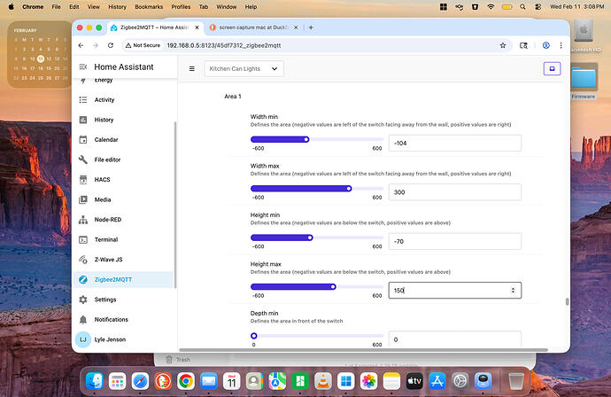

After applied, I go out all the way, back to ZIGBEE2MQTT, then back into the switch (Exposes), and they have swapped.
I checked to make sure my browser cache was empty, but yep.. Keeps switching
UPDATE: I tried your way, and clicking reconfigure AFTER I go out to get values.
Same thing happened, with swapped values between width min and max.

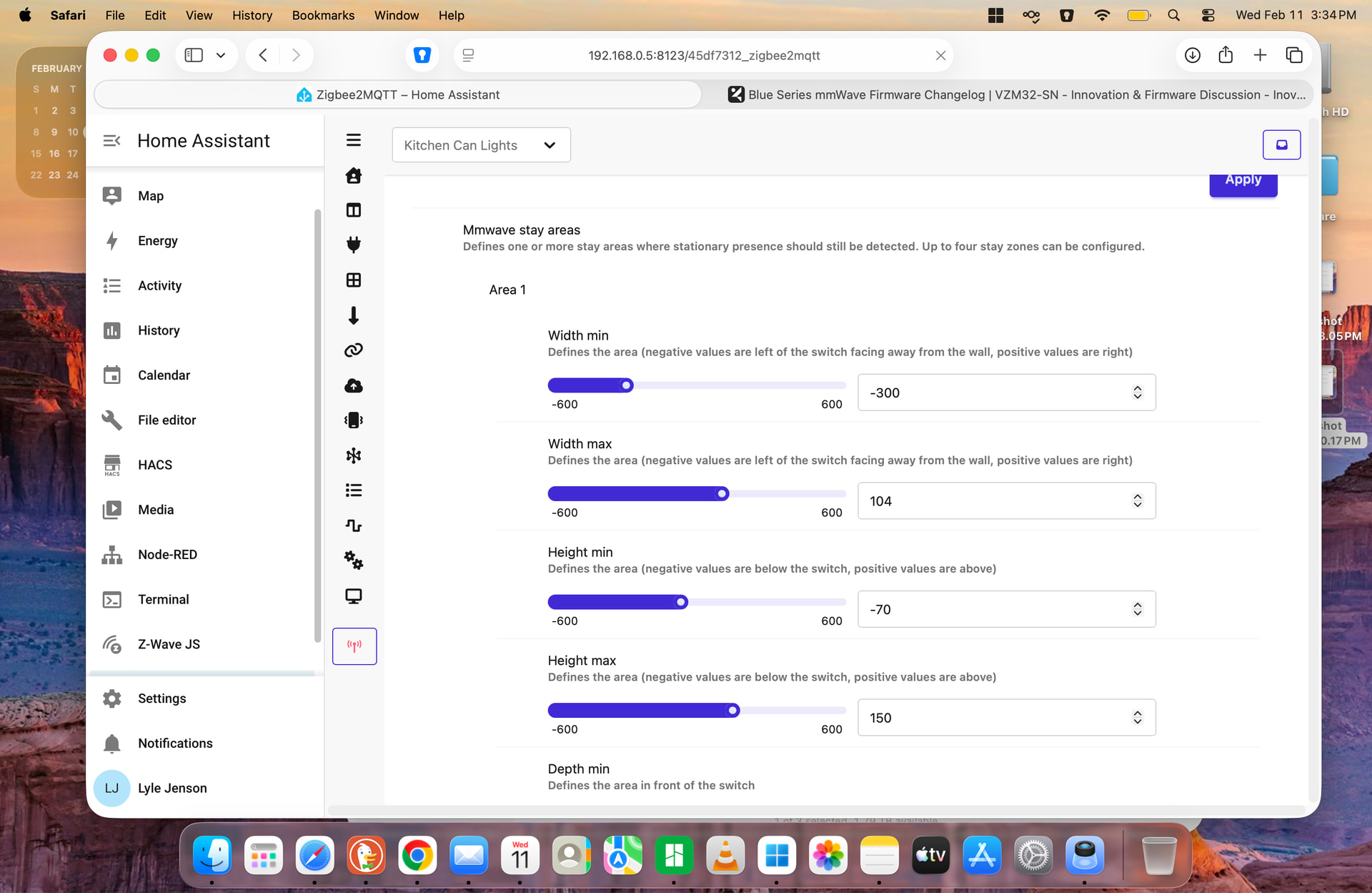

Tried different browser just in case of Safari, and used Firefox. Same thing.
