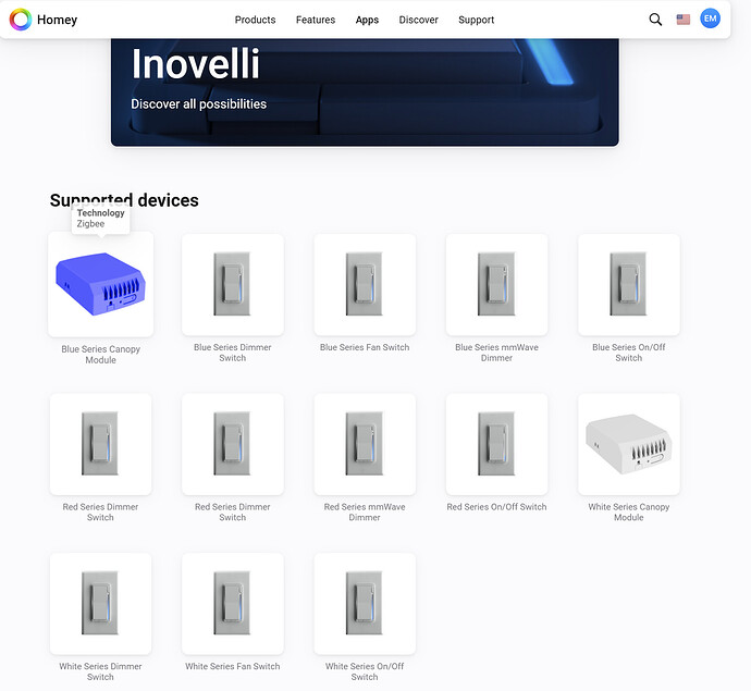

@harischundrigar just FYI, the presence switch (red and blue) have been added to the test app and I will push it up the production channel after doing some more testing.
We have most of our devices published in the test channel. Will be updating the production channel after some testing:
