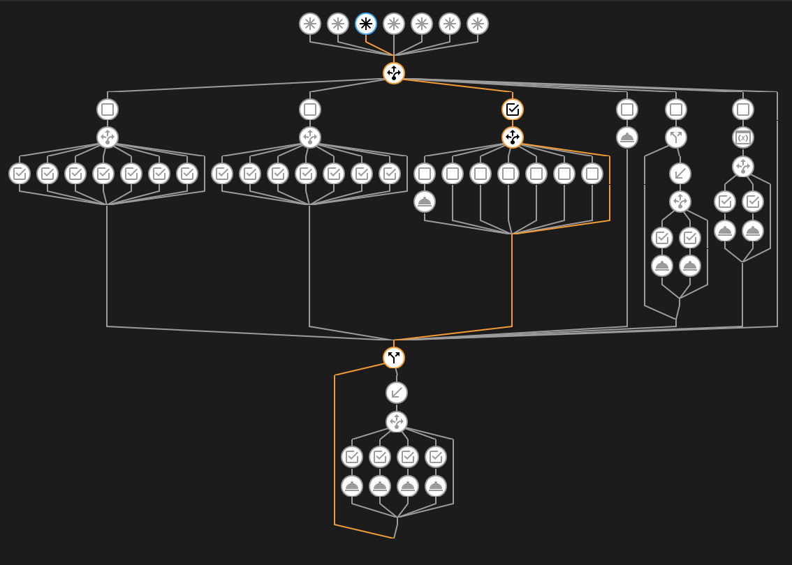

Try single clicking your config button and then look at Settings > System > Log for an error related to the automation. In the automation editor you can also click on “Traces” (top right) and error details should also be in there. Can you copy/paste any relevant details you see?
There were no errors in the system log. It appears it took the incorrect path. Here’s the trace.
It appears your config entity event_type is reporting an unusual state. It should be multi_press_1 for a single click.
Can you click the switch’s config button once, open the automation and click Traces > Step Details > Changed Variables and paste the output? Mainly looking to see what was reported as the event_type in the to_state section.
Sorry for the delayed reply. We were away. Here’s the Changed Variables output.

These do not appear to be the correct event_types for the Inovelli Matter Switches. In HA there’s basically two separate sets of event_types that are assigned depending on the switch and it’s capabilities, and it looks like your switch was assigned the more limited set (for switches that can’t do multi taps).
What model number switch do you have? I’m curious if you’re using the White Dimmer or the Fan Switch.
How did you integrate it into HA? Was it commissioned with another HUB like Google, Amazon, and then shared to HA?
Matter Fan switch beta, v1.0.0
