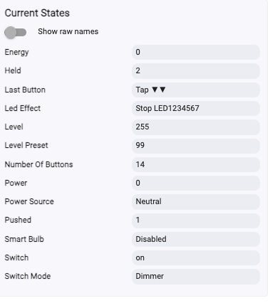

I have two Red series VZW31-SN (v. 1.04) switches running in dimmer mode on Hubitat (C8-pro).
Hubitat is running the latest ZwaveJS (not Zwave legacy)
Driver: Inovelli Dimmer 2-in-1 Red Series VZW31-SN (2024-10-22)
The issue is that the devices are reporting a brightness of 255 whenever the switch is triggered ON.

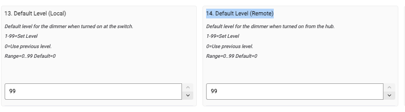

I’ve tried changing the “14. Default Level (Remote)” parameter, but this does not resolve the issue. Currently, it is set to ‘99’.
Any suggestions?
