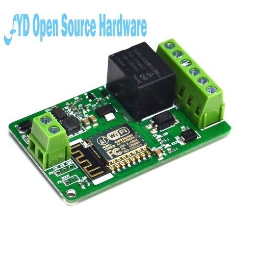

That’s not the cheapest prices, just ones I found quickly. There is a 12VDC sensor version and the ESP card has a 12VDC input, so they work together hooked to 12V. In a 8’ ceiling the sensor can pick me up about 9’ away. I was surprised how sensitive and well they work. Instantaneous reporting back to HA too. I 3-D printed some rings to fit in the same hole a Aeotec sensor would fit in, just because they can be swapped then.

This is good stuff. One of the things (of all the many things) that pushed me from ST to HA is being able to integrate custom hardware centered around esp8266/esp32 like this.
