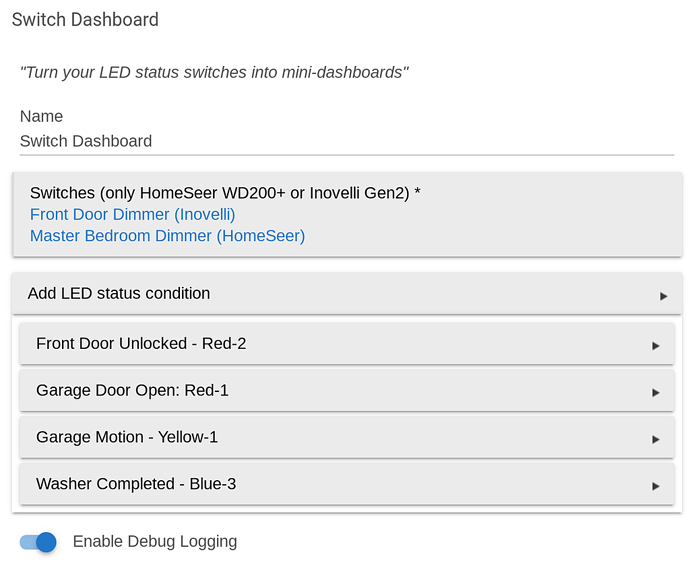

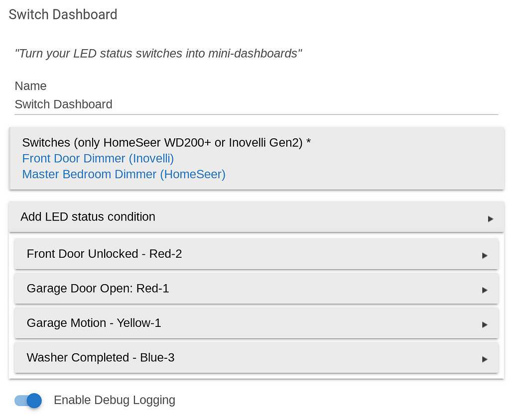

I set mine to different dim levels for on vs off, and use the child notifications to change the LED color as a confirmation that my fan controller received my command.
Double-tap up causes my fan speed to increment
Double-rap down causes my fan speed to decrement
When the fan speed changes,
If fan is off, turn blue with cycle effect for 2 seconds
If fan is low, turn green with cycle key effect for 2 seconds
If fan is medium, turn orange with cycle effect for 2 seconds
If fan is high, turn red with flashing effect for 3 seconds

And these are the notifications LED status settings I setup for the Dimmer
These are always being tinkered with, so they may not be exactly as described in my prior description, but it should be very close – certainly close enough that you can mimic what I did, and make your personal customization changes.
I notified you in another thread, but the child devices for the LED bars were just added to the SmartThings device handlers.
This app just makes it easy in HE.
You can assign priorities so a higher priority status shows. When that condition goes away, it drops back down to the next highest priority.
