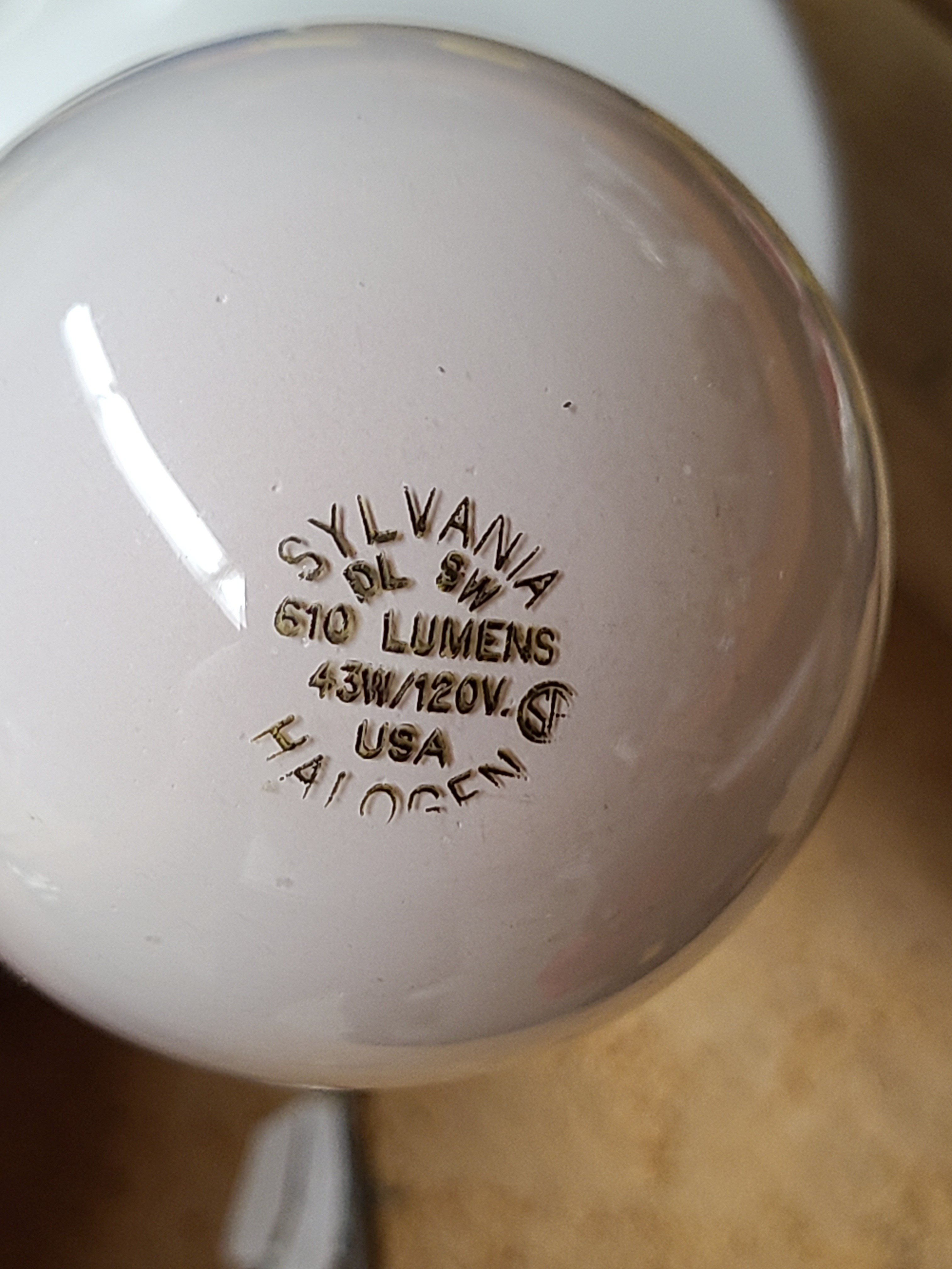

DH version is 9/21. Bulb is a 43W incandescent. ST reports firmware 1.47. I did not verify with zwave stick.

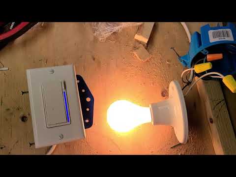

When the bulb is ‘off’ from holding down paddle, what is the LED bar doing? Is it uniformly dimly lit (indicating the dimmer is off), or is it just lit at the bottom (indicating it’s at 1%)?
Looks like it’s off. Check out the video. The switch actually reboots several times during video. Bulb wiring and bulb images are attached for reference too.

For the rebooting that is something I haven’t seen. I wonder if using a different bulb would make a difference.
I’ll search around for some different bulbs. I plan on buying a bypass to try with my legs. I reset all the config options after pairing.
