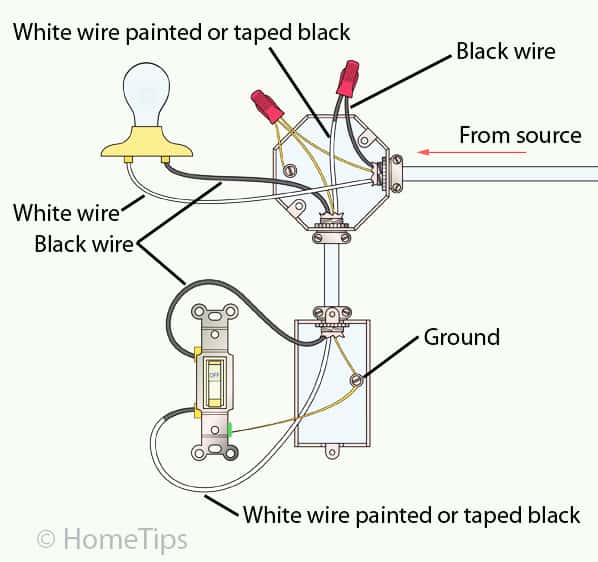

Thanks for the Clarifications. I’m not familiar with the NEC, The Canadian Electrical code is more my thing. (And I’m admittedly not as well versed as I probably should be) but I just had these issues with the electricians who rewired my parents house as part of an insurance rebuild. I’m not sure I would consider them “Competent”. You’d think with the amount they charge for change requests they would be willing to work with you on eliminating 2 wire switch loops or switch legs… At least in the 90s it was very common to pull power into a light fixture and then do a 14-2 loop down to the switch where the white was marked and both wires were used as a hot, one from the supply to the switch and the other from the switch to the fixture. Conveniently there is hot in the box which can be used for the fan so you can control the fan by it’s pull chain and leave the fan on when you turn the switch off at the wall.
Sounds like my American friends don’t have to worry about this in homes built since 2011. I just looked up CEC and it looks like it was allowed in the 2015 version, but as of 2018 a switch loop needs an additional “identified conductor”. (it looks like they avoid calling this a neutral because not every smart device uses it as such.

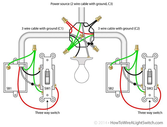

This is the 3 way wiring that I suggest avoiding. You can’t use a normal 3 way switch for the second location, it has to be a smart aux switch.
