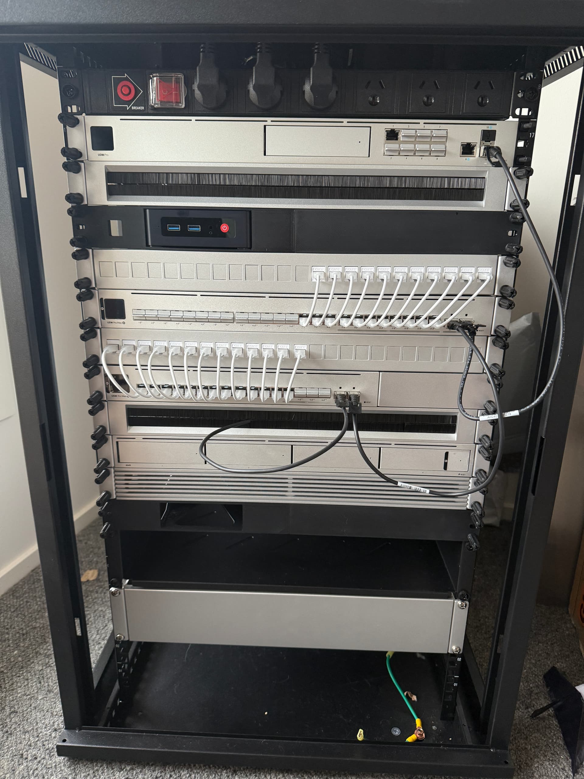

I am building a new house in AU , Smart Home run by Home Assistant. Have tested heaps of switches and platforms. Am retired and was in the corporate IT field. Happy to test anything, pre buy beta test and work through issues for AU products.
Here is my IT rack for the new house with NUC to run Home Assistant.

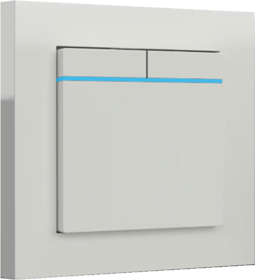

My understanding was that we wanted the main button (the large square button in the middle under the LED Bar) to be a, “rocker” where if you pressed up on the top part it turned the light on and or dimmed if you held it down – and if you pressed on the bottom part, it would turn the light off or dim it down.
Is this correct?
Another option would be to have the square part be more of a momentary style switch in that it simply turns the light on and off and you use the top buttons (above the LED Bar) as a dim up/dim down.
My thoughts would be to go with the first option (have the square button be more of a rocker that controls on/off/dim) and then use the top two buttons for scene control (multi-taps).
I still envision having multi-taps for the “rocker”, but the main function is to control the load.
What are your thoughts?
I think you’re absolutely correct. However, I’d like to stress that I think a smart bulb mode would be essential, as I’d personally combine them with smart bulbs in most cases. I don’t have much experience with dimming “dumb” bulbs.
