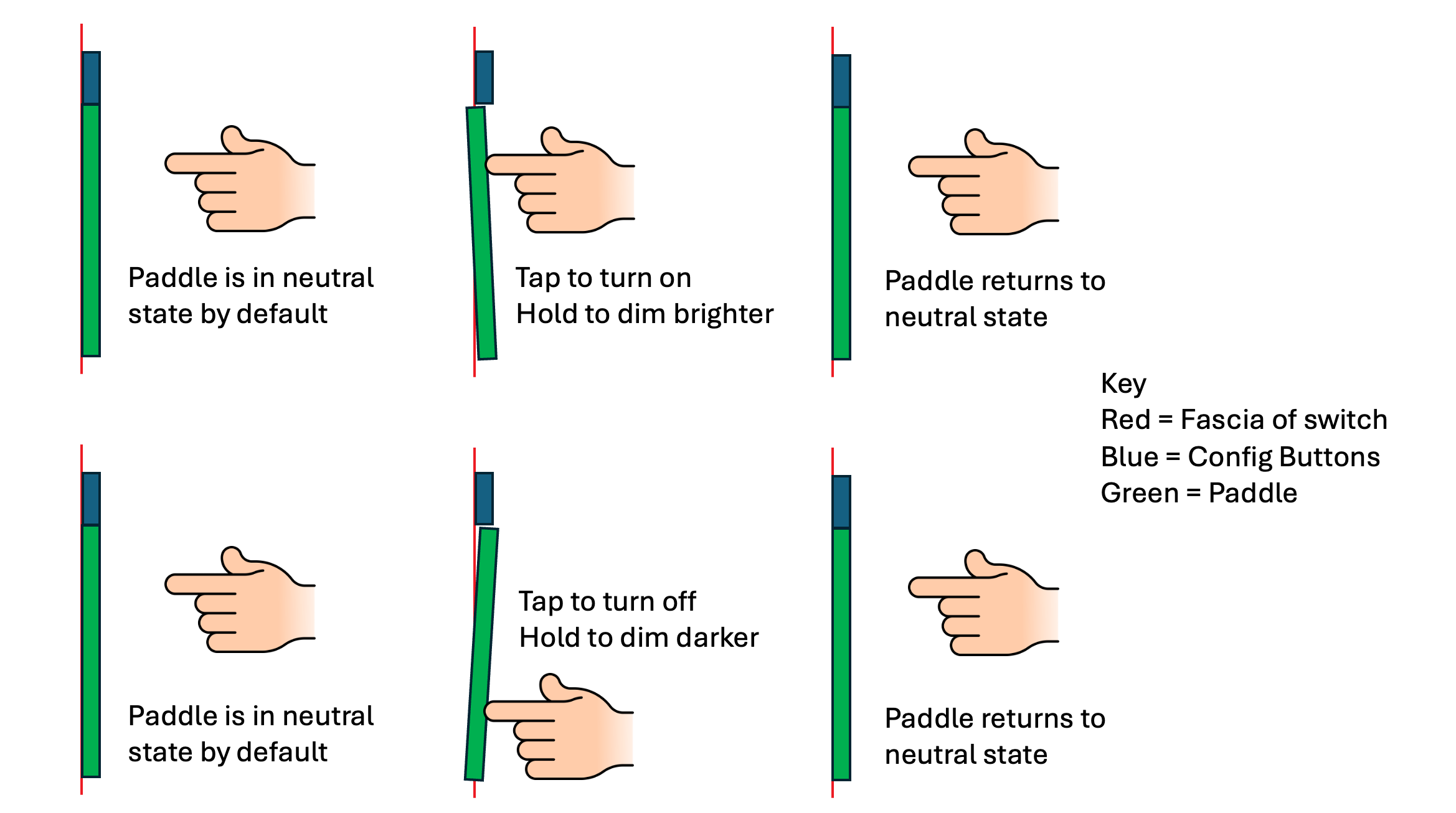

Yes, great point – I think I understand what you’re saying, but let me draw it out so I’m understanding/explaining correctly.
So, essentially the buttons at the top (blue in the picture) will always be flush. But the paddle (green in the picture) will start in a neutral state, but will be able to be depressed when turning on/off the switch.
Hopefully that makes sense?

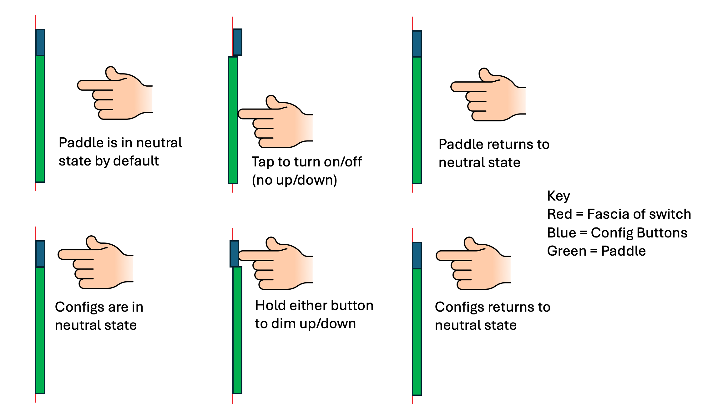

Whereas the other option would be this:
Makes a lot more sense with the pictures.
I feel like the first picture feels closer to the usage of a normal switch, and it would be the expected behavior for most people.
Having it be able to both toggle on/off and hold for dimming would be good, gives it more functionality as well leaving the top buttons for other things.
For Norway, from what ive seen, the normal way is pushing the top part to turn the light on, and bottom is off. But there is no set standard.
From these two options, the first one feels more natural when considering dimming. This is also what I understood from your original description.
I personally don’t use dimming, so I would personally go with the second option, if both were available, as it completely eliminates the problem “which way is up”. I guess you’d rather start with just one version, in which case the first one makes more sense.
So my answer is: a millimeter wave presence detector would completely eliminate the need to touch it :wink: And then the first option makes more sense again.
Also it’s worth noting that in some locations a single light may be controlled by multiple switches so the first use case seems more in line there.
