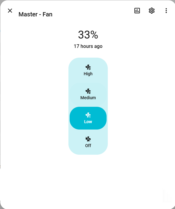

These were the only Z-Wave Fan Controllers I have had up until recently when I tested one of Inovelli’s Blue series canopy module on another ceiling fan layout where I didn’t have enough wires.
These enbrighten controllers are very robust and have 4 settings (Off, Low, Medium, & High) and work great with Home Assistant. It displays in Home Assistant like this:
This in turn gives you all the automations, voice control etc… that you could want. I had my original 2 in place for over 5 years before one of them did fail. I was bummed but I didn’t think 24 hour (Low Speed default) speed control for 5+ years was terrible and NO issues with the other. I just replaced it with the same model and things are back up and working as expected.
