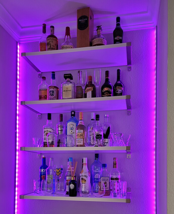

After buying and returning three different aluminum channels from Amazon, I’ve finally found one that fits the LZW45 and wanted to share.
https://www.amazon.com/dp/B07VSF292F/
Due to the thickness of the weather proofing and the wideness of the connectors, you need a wider channel. I must also warn you that the diffusers are nearly impossible to slide in, I had to pry them in.
