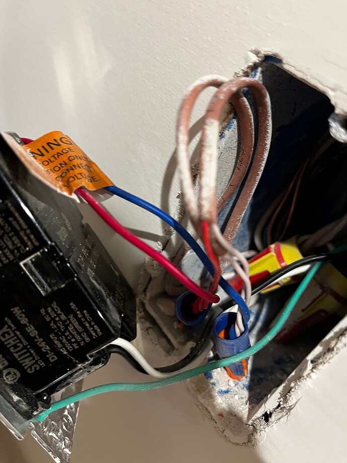

After several hours of searching, I think I’m out of luck, but I thought I’d post something here to see if anyone has any thoughts. I just moved into a house, and the LED under cabinet lighting is controlled using one of these:
https://www.diodeled.com/switchex.html
It appears to be a combo dimmer and SELV driver. It’s kind of a neat package, in that you don’t need some big box under your cabinet. The bad news is I can’t find anything like it that uses Zigbee, Zwave, or Matter (via Threads or WiFi) so that I can control these in Home Assistant. I found a ton of ways to do it with a separate LED driver, but the wiring between the switch and the LED strips under the cabinets is low voltage, so I can’t just push 110VAC over to the cabinet and install a driver there. And using the kitchen wall outlets to power a LED driver under the cabinet is a no go on WAF, as we don’t want the new house to look like it was retrofitted. Here are a few pictures of it:
Anyone have any inspiring thoughts or suggestions?
