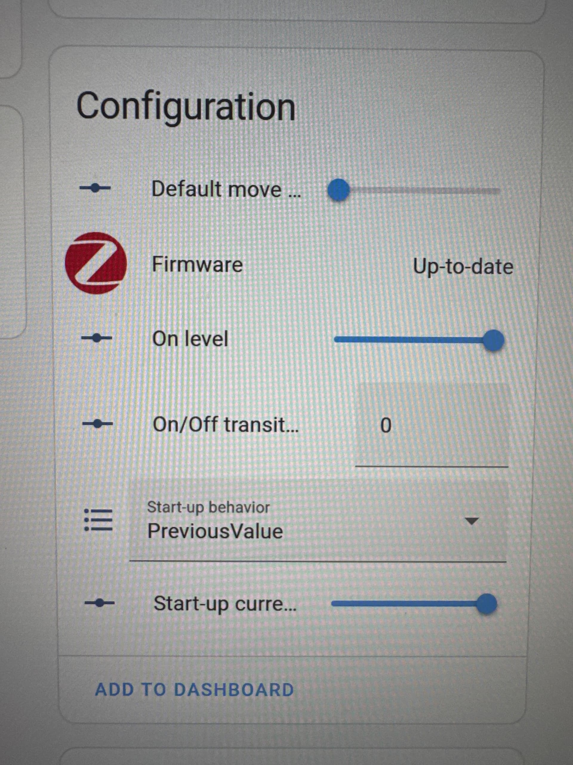

I am unable to see all VZM30 switch parameters after pairing with ZHA. Am I waiting for a Home Assistant update or do I need a custom quirk?

Edit - It looks like some parameters will need tweaked and I’ll put something in for that, but I would expect additional parameters to be showing up there for you. What version of HA are you currently running? And when you look at the device info section, what quirk does it say is applied for this switch?

I’m running HA version 2025.7.2
Quirk: zhaquirks.inovelli.VZM30SN.InovelliVZM20SNv2.
Sorry for the delay, ZHA has had some changes and it’s taken me a little longer than expected to catch up. Should have a PR in this weekend, but that quirk looks fine to me, think I know where the holdup is but it’ll be a change within ZHA itself.
Had the same issue here installing my VZM30-SN. I found that if you edit parameters manually, the configuration options/entities show up after (sometimes takes a few hours). Only for the edited parameters though. Looking forward to the fix. Quirk used in my homeassistant is also: zhaquirks.inovelli.VZM30SN.InovelliVZM30SNv2, also currently on HA 2025.7.2
