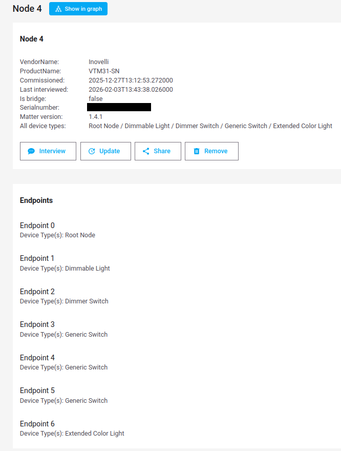

I did re-interview the device. Here is the list of endpoints visible in the matter UI:
Each of these has quite a few clusters, Iām not sure which one corresponds to the configuration actions.
Itās a bit problematic since the switch was in smart bulb mode, but after the update itās behaving as if smart bulb mode was disabled (but it reports smart bulb mode as enabled), and trying to turn smart bulb off/on from Home Assistant returns the error above.

EDIT: rebooting Home Assistant did not help (there was no āNot providedā entity to clear), but resetting to factory and re-pairing did the trick.

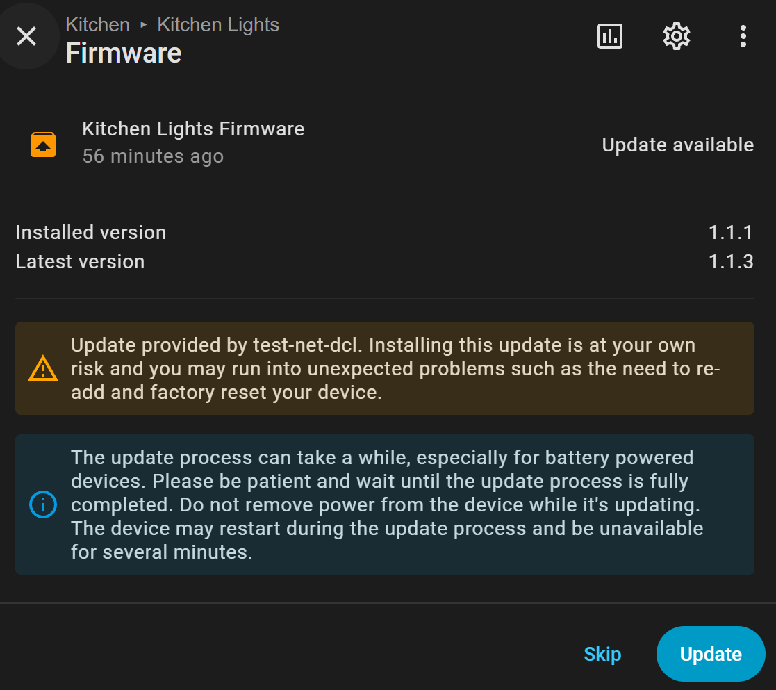

That is still the beta version. It looks like you have ātest-net-dclā enabled which I thought was disabled by default but maybe not.
Yeah, I figured it was a beta but when I saw it I came to this thread looking for the changelog and didnāt see one like the other betas, just saw people talking about 1.1.5 (donāt see the changelog for that either?) and no mention of 1.1.3. I probably checked the enable test-net option when I set up the matter server, I donāt remember doing that but itās the sort of thing I might do.
