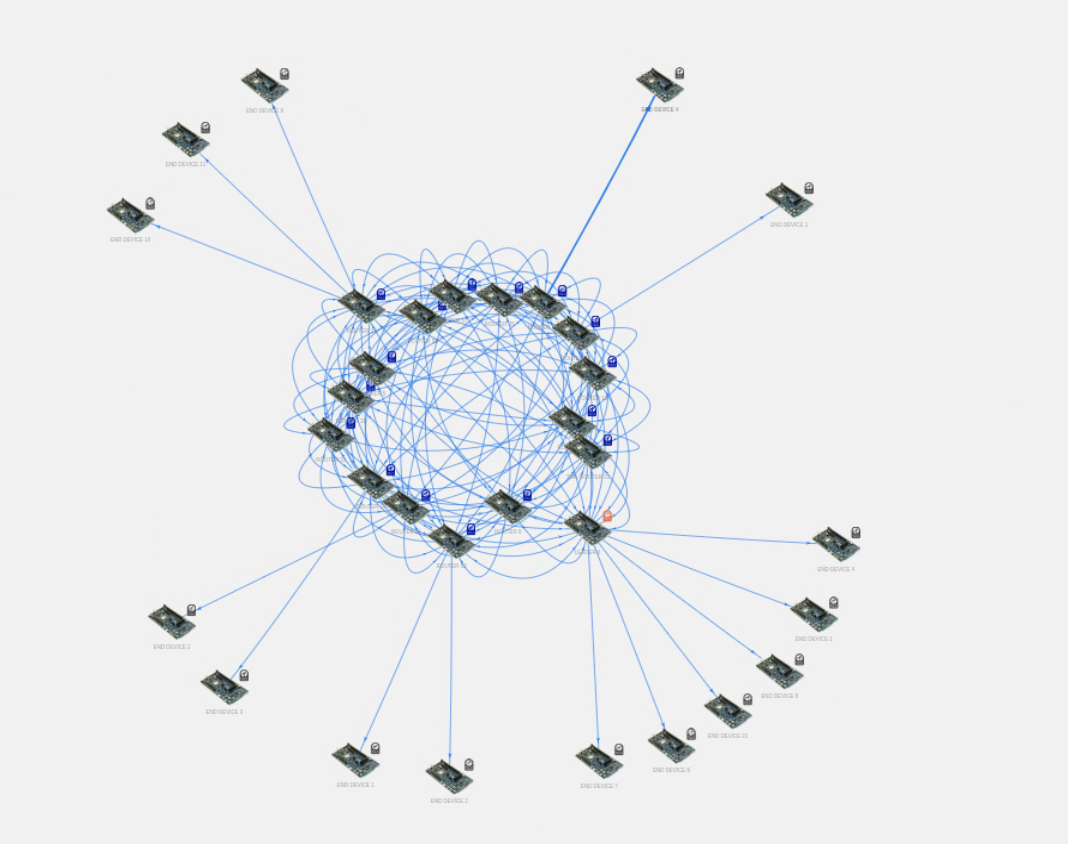

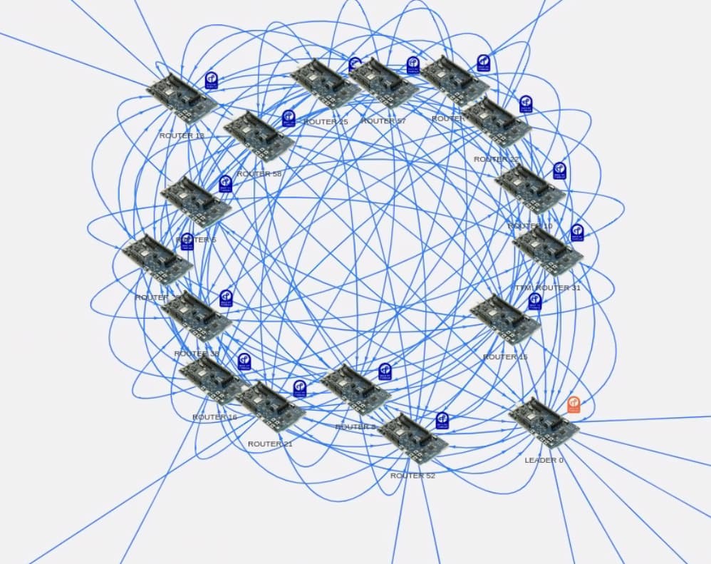

I’m not sure this helps or not but when I was first looking at Thread networks I played with Nordic’s nRF Thread Topology Monitor which gives you a visual view of a Thread network.
This tool needs a Linux or Windows PC with nRF52840 Dongle and the software is a pain in the tail to install (please don’t ask for assistance with that). However, once done the monitor inserts itself as a Thread node on the network and you can see all of the interconnections.
Even though I found the tool useful I have issues with using the tool in active network:
  • It does not appear to have been updated recently and hence is almost certainly not up to the latest Thread standards
  • Since it adds a Thread node to the network (itself) it is effecting what it it is observing.
As such I don’t use it on a regular basis and this morning I just fired it up for a few minutes to take the attached screenshots.
What you can see is that there is a core group of 17 (ish) routers with a bunch of devices connected as end nodes. As I said above I have 22 Inovelli nodes (#23 gets added tomorrow) plus 5 Apple OTBR/Routers plus 2 other Thread devices that are router capable. This means as HA indicated when I looked at things yesterday that a bunch of the Inovelli switches are (correctly) acting as End Nodes while about half of them are acting as routers.
When you watch the tool in real time you can see routers being “demoted” to end nodes and end nodes being “promoted” to routers every few minutes just as @jvm33 described which is how I believe a Thread network is intended to work.
Note there are two screenshots taken a few seconds apart. The first shows the complete network, the second a closeup or the central router portion of the network. You can see (if you look carefully) that each router has multiple connections to other routers and end nodes have a single connection to a router (however that single connection may “hop” to another router as network conditions change).
