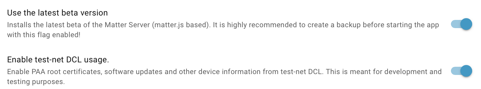

Go to Home Assistant Settings, then ā€œAppsā€, then ā€œMatter Serverā€. Then at the top of the web page, it’s got a ā€œConfigurationā€ tab (semi-hidden, not obvious). Scroll down a bit and enable both ā€œUse the latest beta versionā€ and ā€œEnable test-net DCL usageā€. Then reboot.
Via Home Assistant devices, it won’t offer the update (at least it didn’t for me). So go back through to Settings→Apps→Matter Server. This time, pick the ā€œOpen Web UIā€ button. If you just have one Switch/Node it should be pretty simple to find in that UI. Click on the Node, then click the ā€œUpdateā€ button and it should offer the option to do the update.
Picture below for the Configuration Setting toggle switches:
Yup, just got that update done! Was missing the web ui step :person_facepalming:
