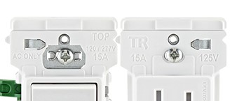

Leviton released a new line of receptacles and switches this year and there is a feature that I think would be a great benefit on this controller: alignment tabs for multi-gang installations.
decora-edge-hotspot-2
Here’s them showing it off (0:59): https://youtu.be/IjDBRYLFaqs?si=Bv6jTNjMSBS_bG6M&t=59
Any chance this product could have something similar?
Very nice! The lever connectors and extended break-away straps are great improvements also :+1:
Yeah I’d love to… need to see if there are any patents though!
How does it work if you have a “normal” switch and then one with these tabs?
