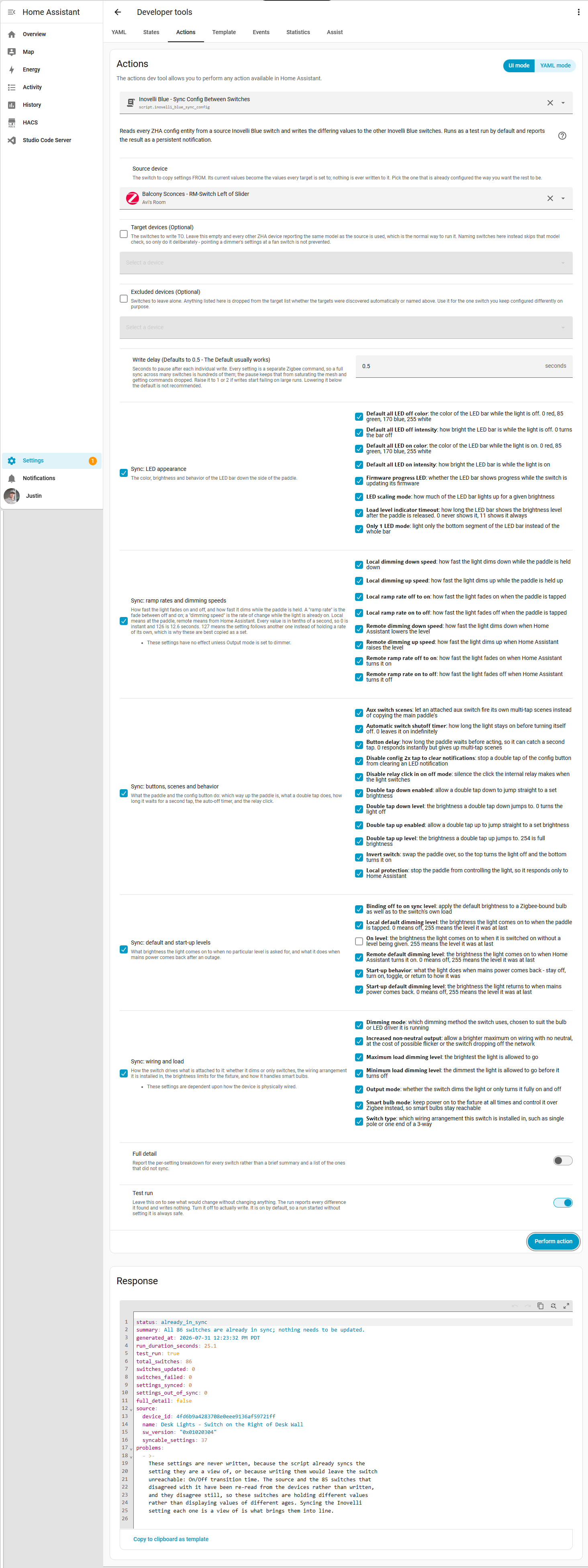

To solve this problem, I wrote a Home Assistant developer tool that will sync 1-to-N settings across your ZHA Network. Basically, you can select a Source Switch, then choose the settings you want to sync, then sync all of those settings across all of your switches. I also made it so you can select a target and destination switches if you only want to update certain switches. This has been amazing and has helped me so much; I decided to open-source it.

Here is a screenshot
