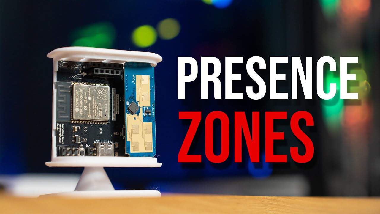

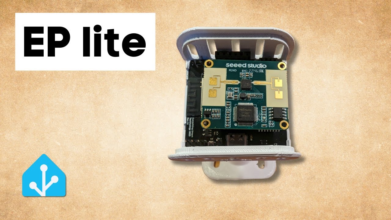

Could probably take some clues from the EP Lite:
