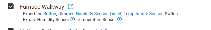

Has anyone found these new temp/humidity sensors useful? I haven’t. I bought the these to fix flicker/hum on a few lights, which has been successful.
Probably a Hubitat quirk, but these sensors keep getting added to Apple HomeKit and get auto-grouped with the switch. That prevents direct on/off control. You have to open the switch, tap into the group, then toggle the switch. The HomeKit Integration app lets you deselect the sensors, but they randomly re-appear on your phone even though they are deselected in the hub.
Question: Is it possible to completely disable these sensors within the Hubitat driver?
To disable them change 297-306 to 0.
Looks like my driver from 8-20 was missing some of those settings.
I updated the driver, set them to zero, hit configure.
I’m still seeing this in HomeKit
I think it will always show as having that ability but will not get updates when turned off. It does look like you disabled the humidity and temp so they should not show in homekit itself.

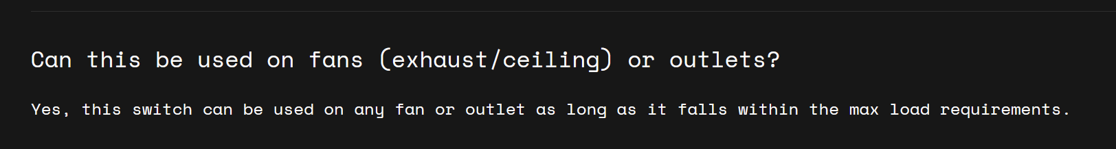

I notice that in the original project info, outlets were mentioned but I don’t see anything about it in later discussion. Did these end up being okay to use for switched outlets? It’s not clear to me from the product details if this is the case.
  • Maximum General Purpose Load: 1800 Watts for both 120V and 277V
  • Maximum Resistive Load: 15 Amps for both 120V and 277V
  • Maximum Lighting Load (Watts): 120V AC - 960W Incandescent, 600W LED/CFL, 277V AC - 1385W Incandescent, 600W LED/CFL
  • Maximum Motor Load: 1/2 Horsepower for both 120V and 277V
Yes, these are fine for switched outlets. I have five of them controlling the switched outlet in each of four bedroom s plus the living room. I guess the only kind of obvious caveat is that the switch is only rated for what I would call normal switched outlets. If you somehow managed to get a switch on a 220 outlet, this switch won’t work for that.
