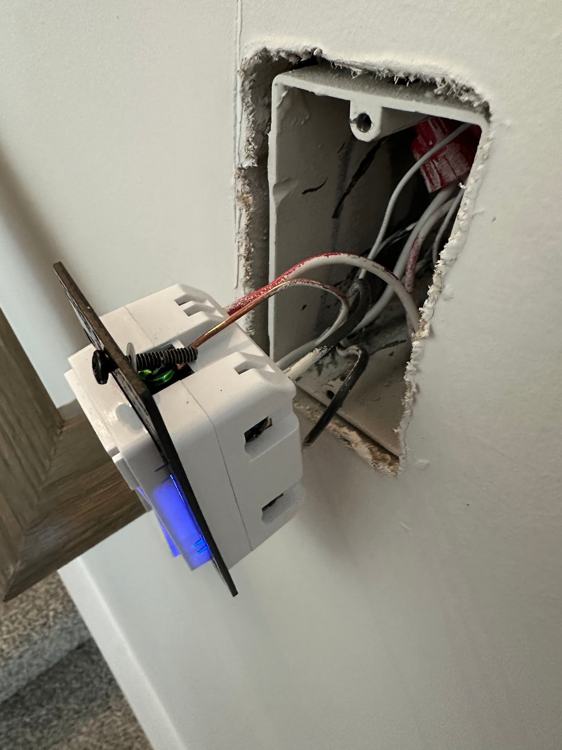

I can toggle the light on and off with the White Series switch. But if I toggle it off, it kills the smart functionality of the switch itself. I cannot operate it anymore from my phone. (I use Apple HomeKit)
Same with the dumb light switch - if I toggle this off, it kills the White Series switch in it’s entirety. So it needs to stay on, otherwise electricity to the smart switch is cut.

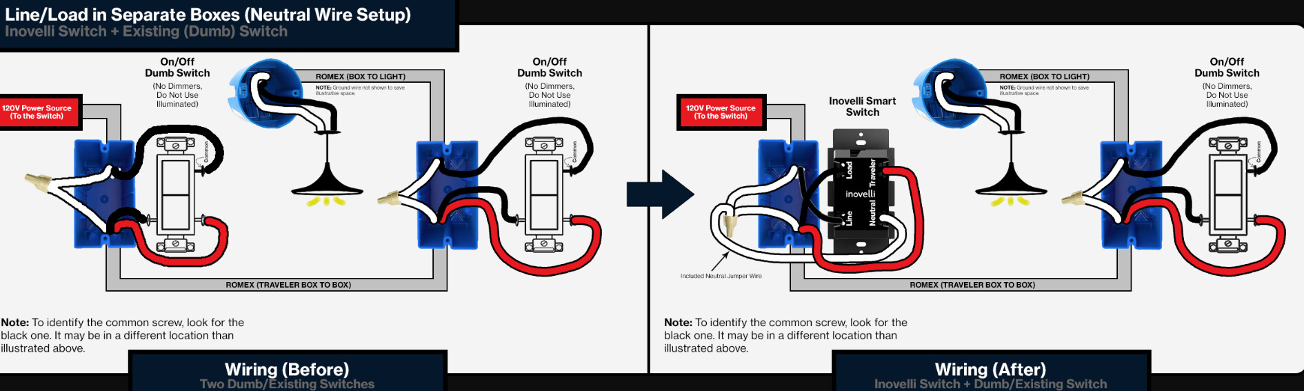

I also manually set up the 3-way dumb configuration (purple light showed up).
My configuration looks like this:

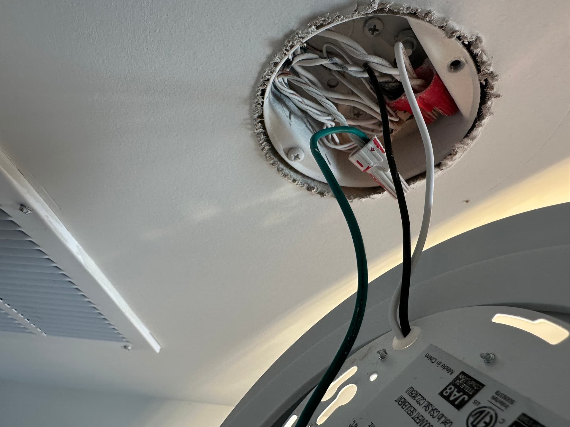

You mean which switch box is “before” the other, correct?

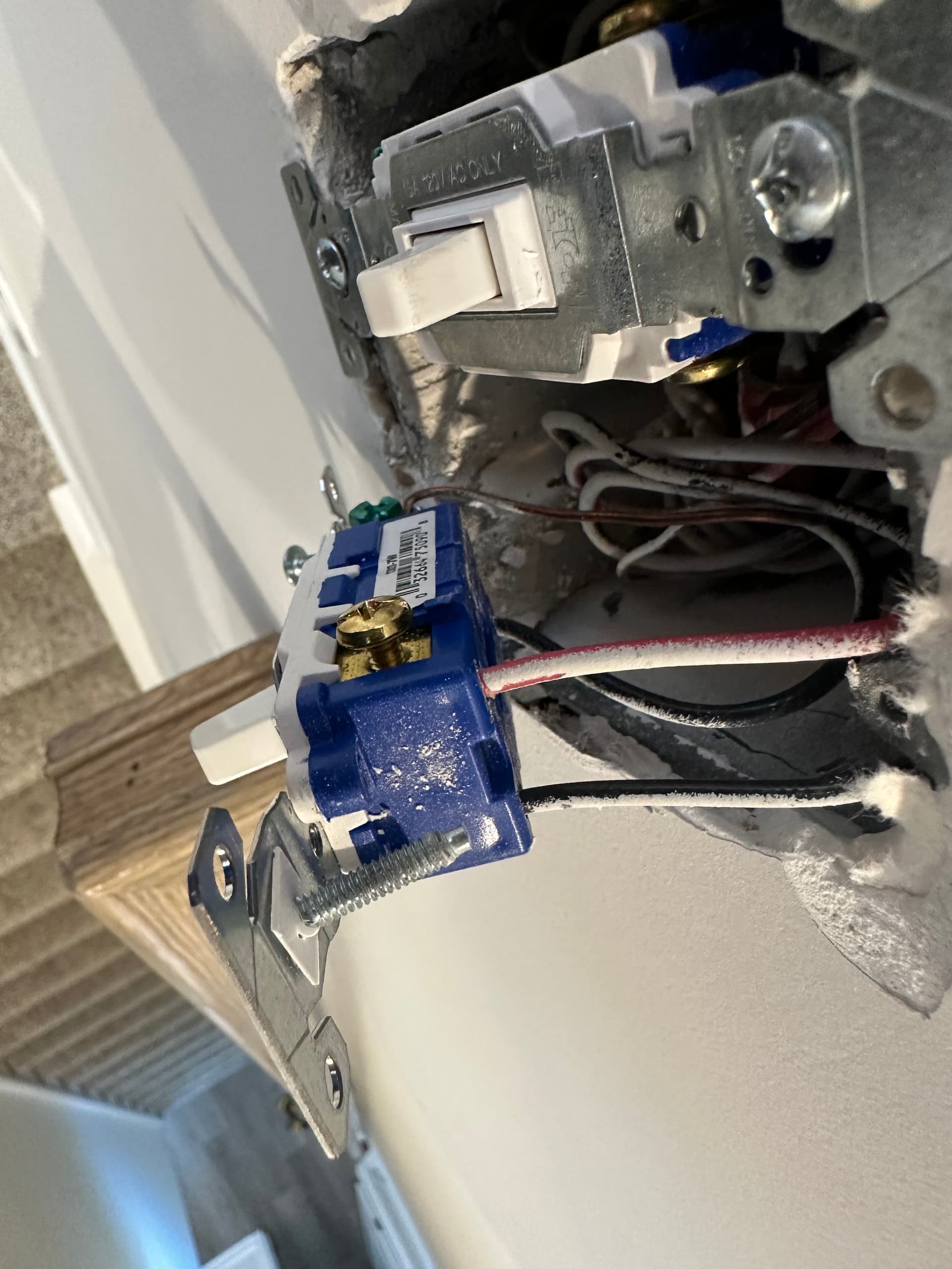

I removed the light switch where the Smart Switch is supposed to be and checked if the dumb switch still works - which it doesn’t. So, I guess I’m at the correct location…

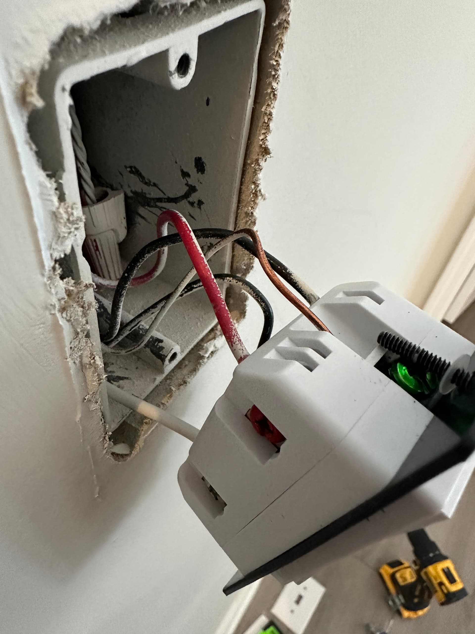

Also, I had no neutral on either of the switches before.
For the box where the smart switch is located, I measured which wire is load and line with a voltage indicator.
