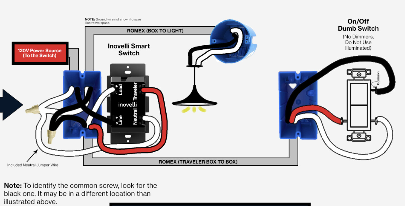

I’ve got a neutral setup 3-way with line/load in the same box. I’ve wired it up exactly as the diagram shows:

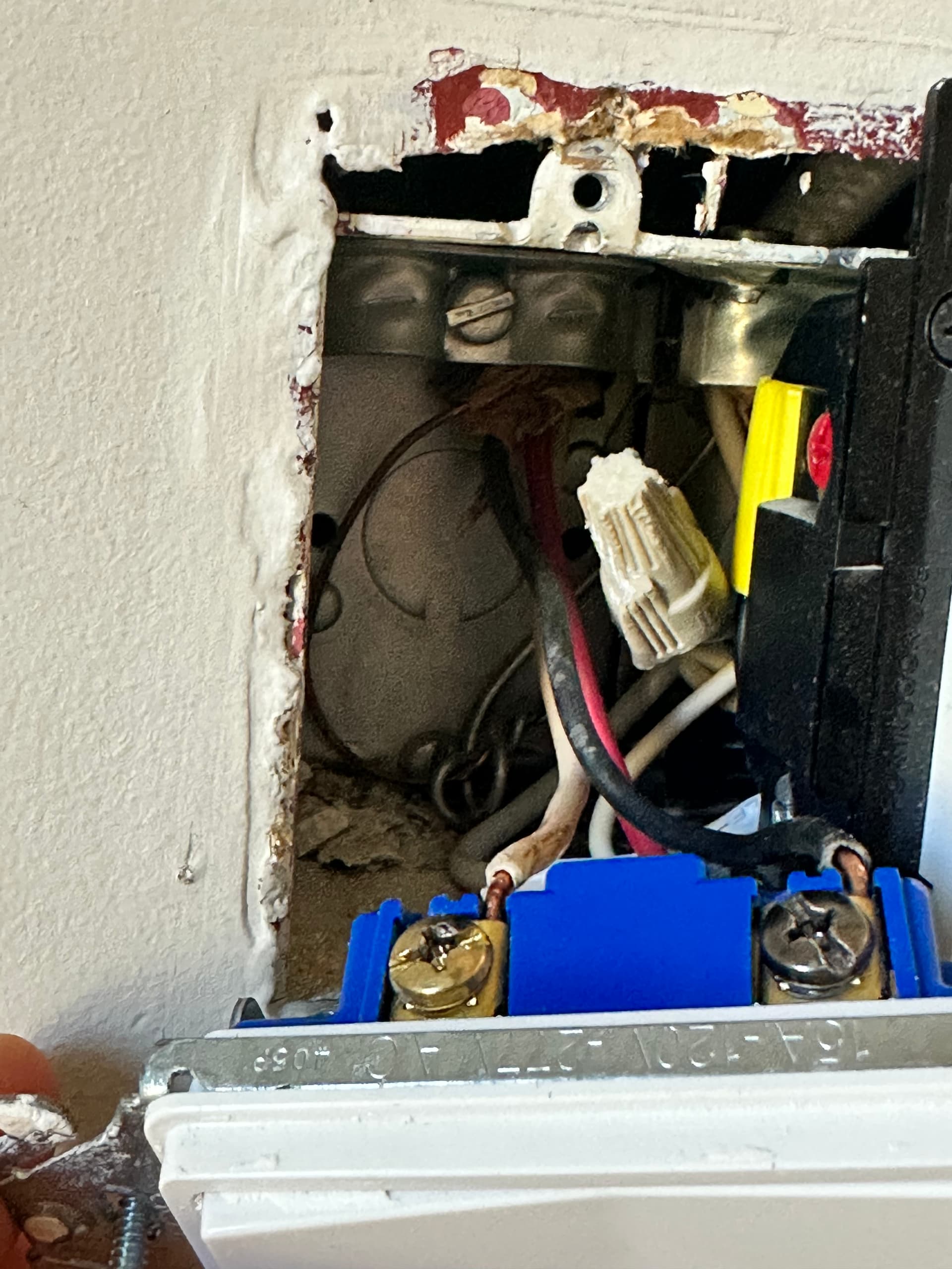

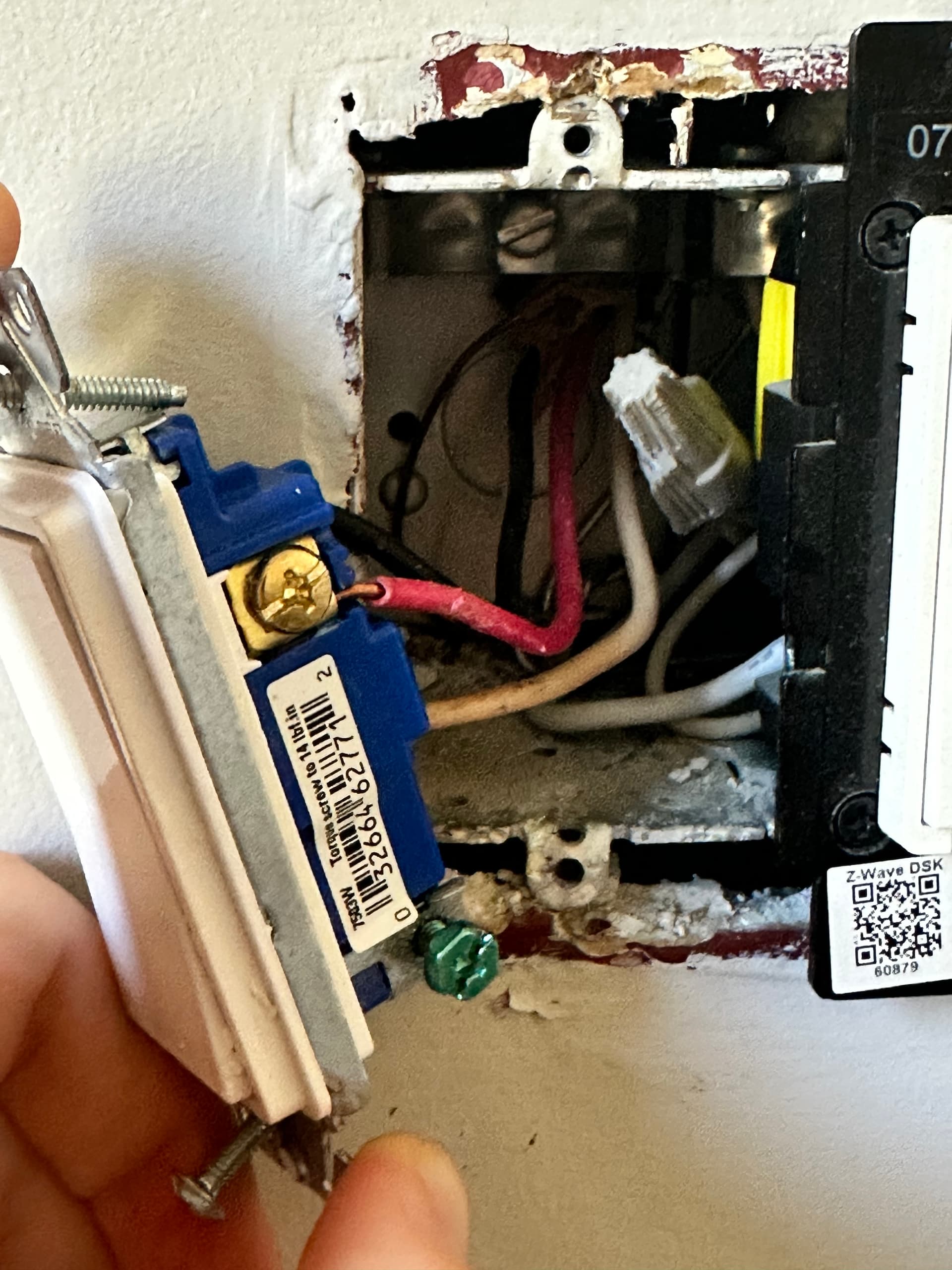

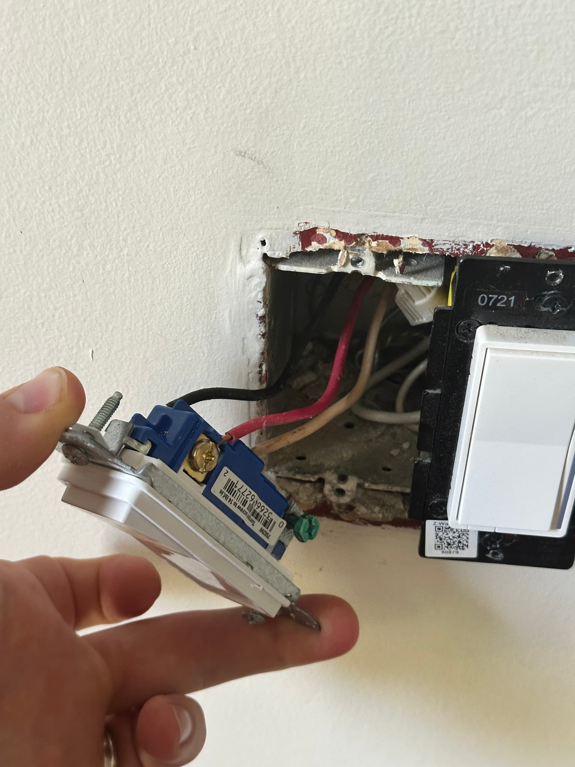

This is the dumb switch:

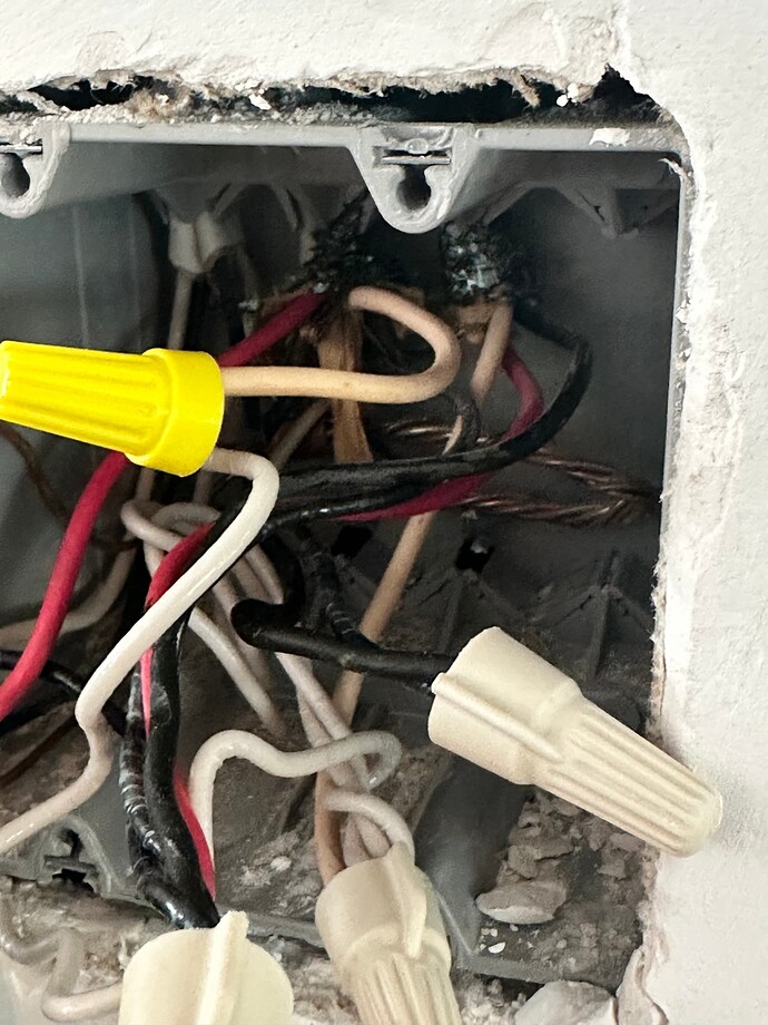

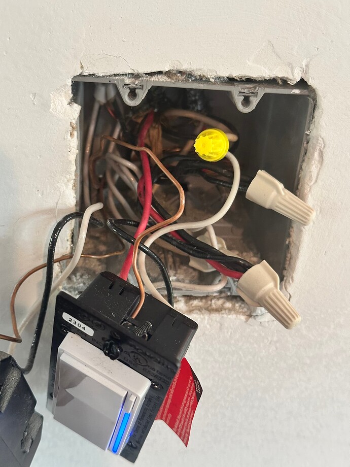

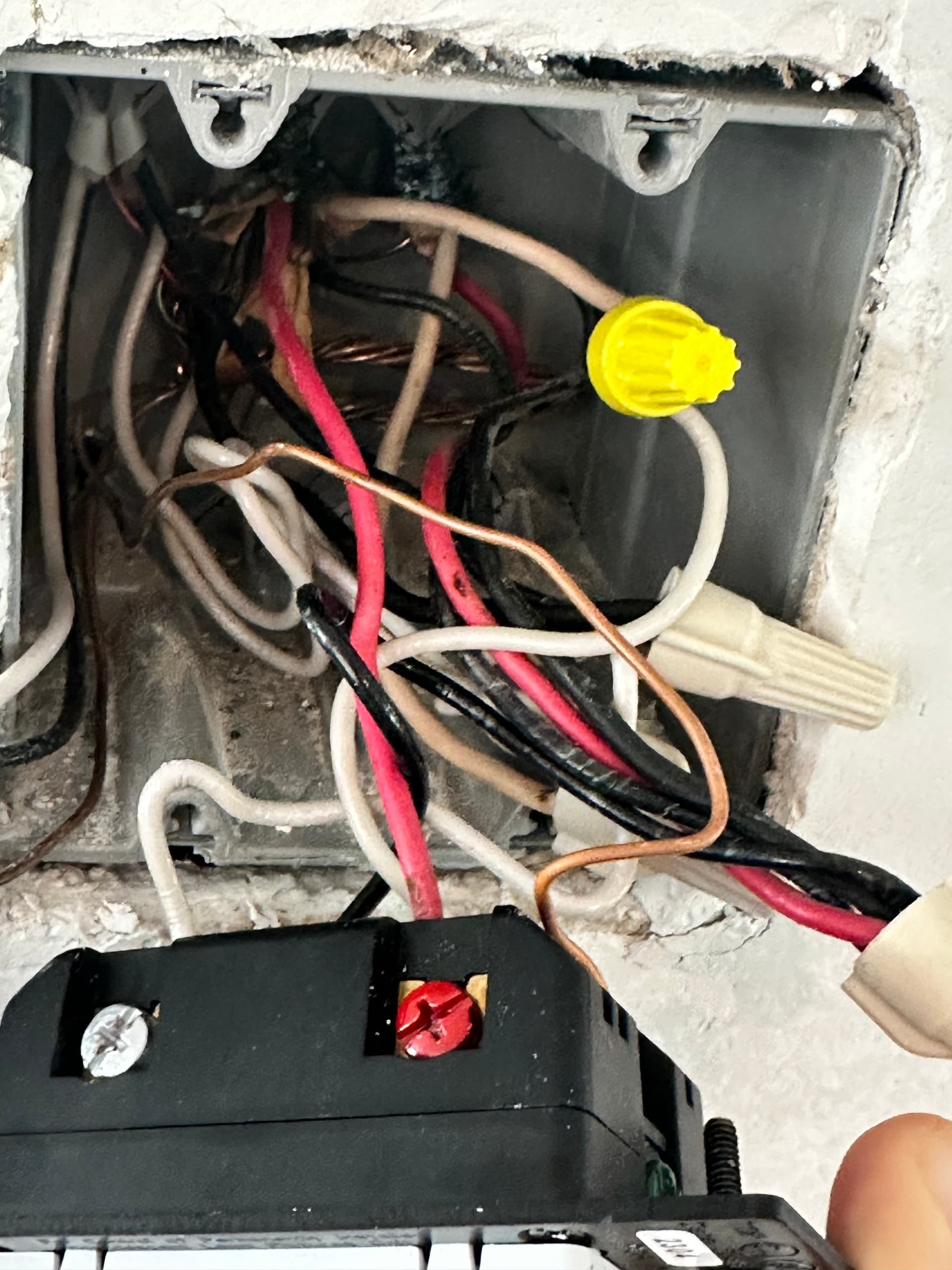

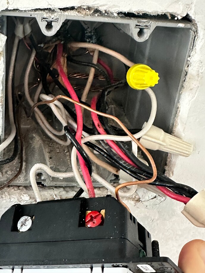

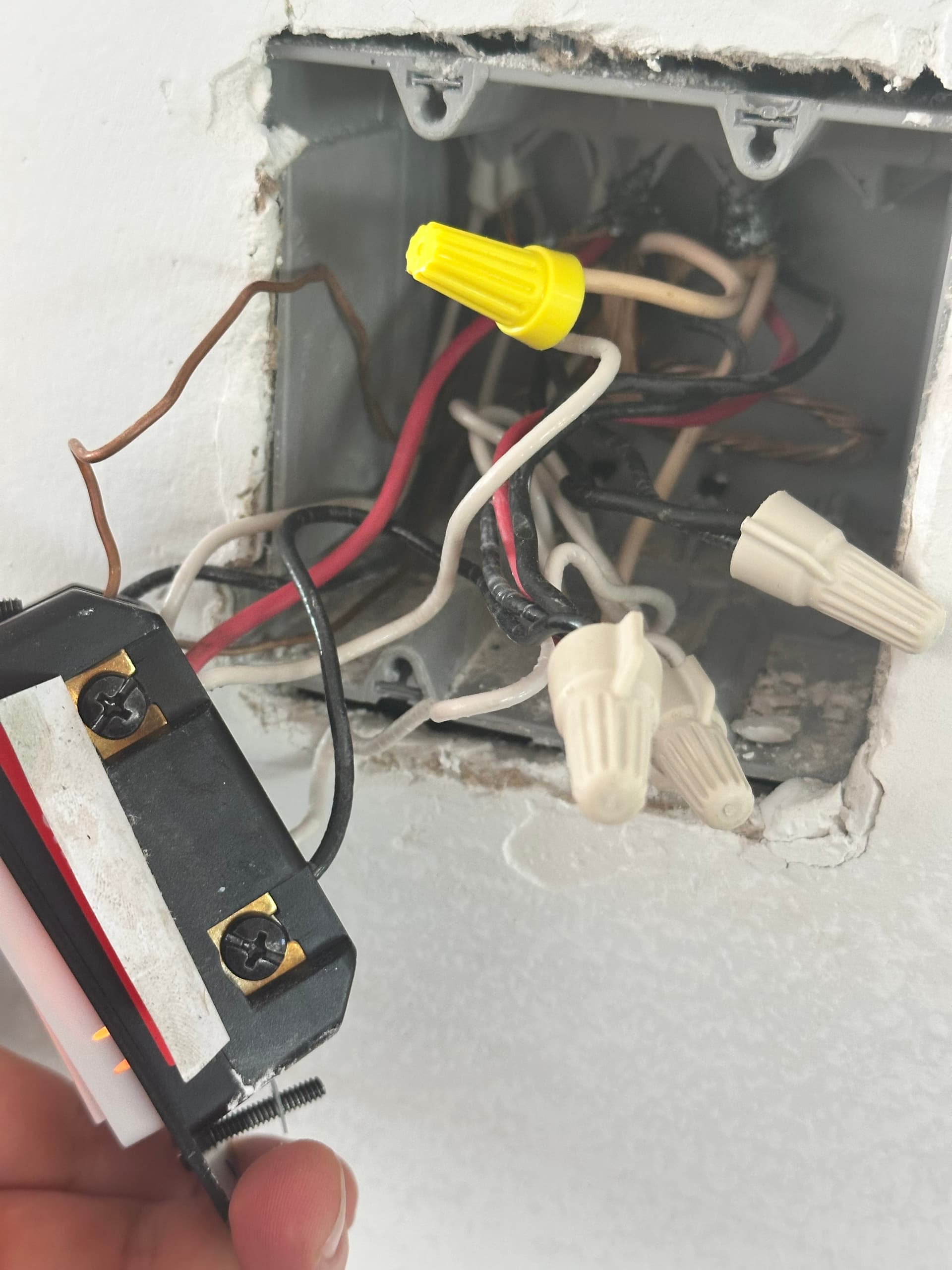

This is the smart switch. Line is the black wire that’s connected to the other black and red. Load is the white wire that’s connected with the yellow nut and the other white wire goes to the dumb switch. Red is the dumb switch wire, neutrals all connected. The nut with the two black wires is connecting the load wire to the light and the black wire to the dumb switch.

You’re going to have to do better with the pictures:
In the dumb switch box, post so that we can see the connections to the switch. I can’t tell which terminals the conductors are on. Also, pull that switch out and take a picture into the box. I’m guessing all 3 conductors on the dumb switch are from the same 3-wire, but I’d like to see that to confirm.
In Inovelli box, pull those conductors out. We have to be able to look into the box and trace each conductor. For this, we should be able to see the 2-wire to the load and the 3 wire, and all of their connections.

@Bry here are more detailed pictures of both sides:
Dumb switch
Smart switch
Correct, all from the same 3-wire

I can’t trace the 3-wire in the Inovelli box. Go into that box and trace the black from the 3-wire. It should be connected to the black of a 2-wire (presumably going to the load). That 2-wire’s white should be connected to a neutral bundle. You’ll have to confirm that.
What is the load? Depending on the load, if the wiring is correct, this could be a signalling issue which sometimes happens with dumb switches. I understand that you’re swapping the light. Any different behavior after the swap, or is that the different behavior you were referring to previously.
Hi @Bry - the wires are short so I can’t pull much more out. But I can confirm that the black from the 3-wire (that goes to the dumb switch) is connected to the black of the 2-wire (that goes to the light). The white from the 2-wire is connected to the neutral bundle.
