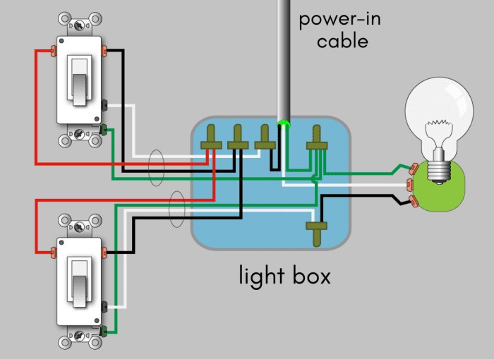

I have a LZW31-SN red series switch that I would like to add to a 3-way switch hall light. I have looked at the manual and the diagrams with the before and after wiring examples. None of them are characteristic of this setup. Is there a way to make this work?
Yep, Inovelli does not have a drawing for this one. In this configuration, you have power going to the light, with a 3-wire going to each switch box from the light box.
You will have to adjust to match your colors.
Perfect. This is very helpful. Thanks.
