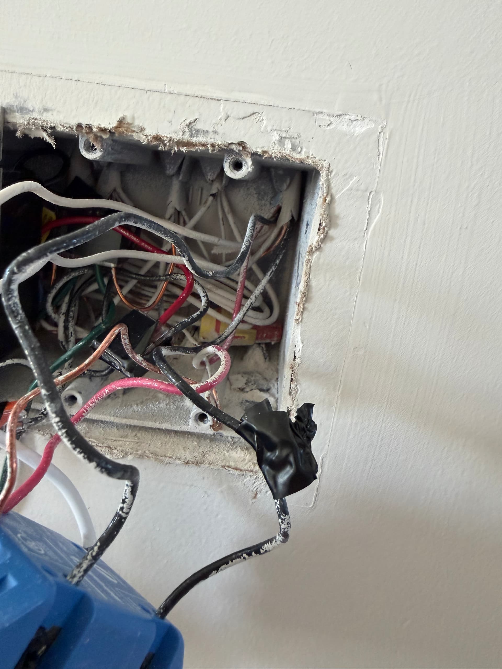

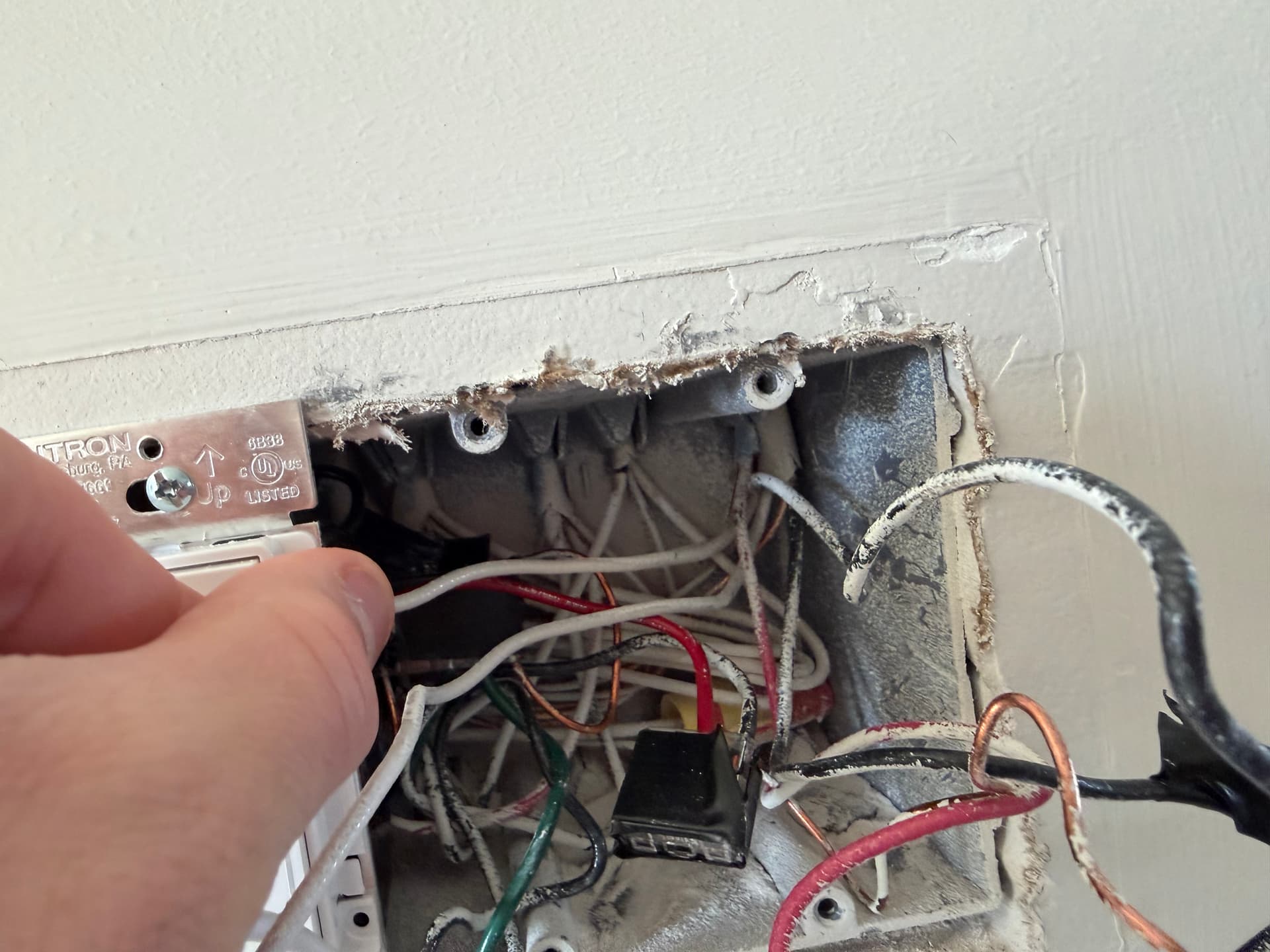

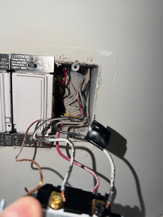

Looking for some advise on wiring up a Blue Dimmer into a 3 switch light, (1 dimmer 2 dumb).
After wiring the dimmer to match what was wired in with the old switch the dimmer just kept power cycling, the FAQ suggested swapping load and line which fixed the issue with that.
Now I can’t get the relay clicking sound to stop when turning the switch off and on, also the 4 way and 3 way downstairs kills power. Which surprised me as I thought this gang box was power in. I’ve attached a couple photos of what I have going on.
I’ve verified that the neutral wires are indeed for both the traveler and feed to the switch.
Not sure where to go from here is it possible to have this dimmer in the box and somehow I got the wires wrong?
Thanks
So how did you determine which box had the line and which box had the load?
Pre drywall walk thru was told that apparently it’s not the case, going to volt test it this week
