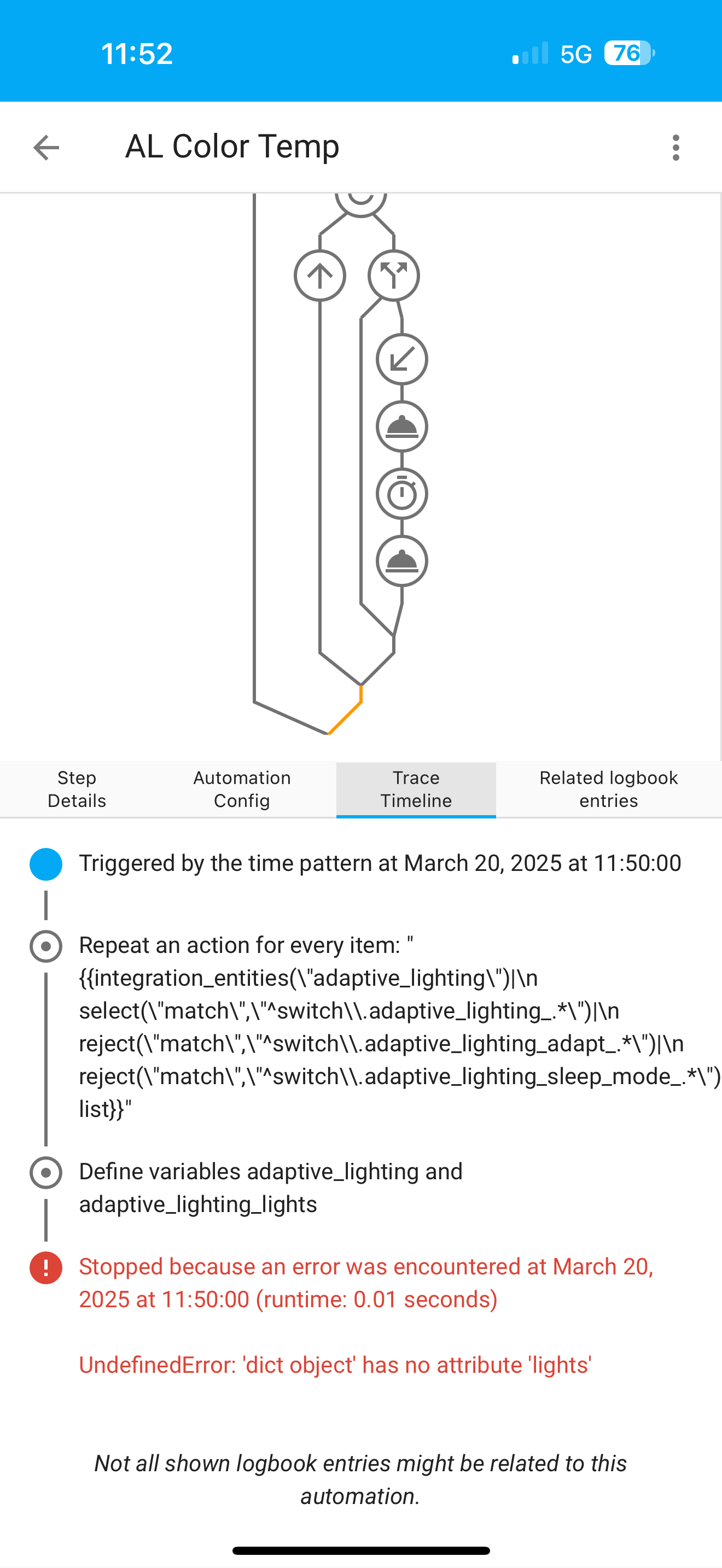

I’ve been frustrated by the same issue, and seeing your post here yesterday reminded me to look into fixing it again. I came across this automation and it’s pretty much solved the problem!
I had to make one modification, because I have some adaptive lighting instances that adapt only brightness, so I added a check to make sure adapt_color was on before publishing the color updates. Here’s my version of the script in full:
alias: Maintain Adaptive Lighting Color Temperature

Note: my AL is pointed at some zigbee groups in addiditon to individual lights. I don’t believe this automation will set execute_if_off for the members of the group, and I don’t know if that matters – I had already set it for each individual light in each group. If you have zigbee groups adapted by AL and this automation doesn’t work, I’d try setting execute_if_off to true for each individual light and see if that fixes the problem.
The original author seems to be updating/cleaning up the automation further here
Ok. This is great. I do have execute_if_off already turned on for all individual bulbs. I don’t know how to set that for groups, but I do have it for each bulb. I did verify that execute_is_off is set to true by looking at the state in all lights. I don’t mind adding this automation if it works. I am just not sure exactly what I need to do. Do I just copy and past that into a new automation.
I am not scared of yaml. My entire dashboard is yaml, but all of my automations have been built through the GUI.
Yes, just create a new automation, switch to “Edit in YAML” mode in the 3-dot menu in the top right, paste in the code and save. It’ll run every 5 minutes while it’s enabled.
I updated my own script to match the original author’s clean version, reintroduced my check for if adapt_color was on, and also added another filter to only select lights that accept color_temp commands (in addition to being off and controlled by AL). That updated code is here:
