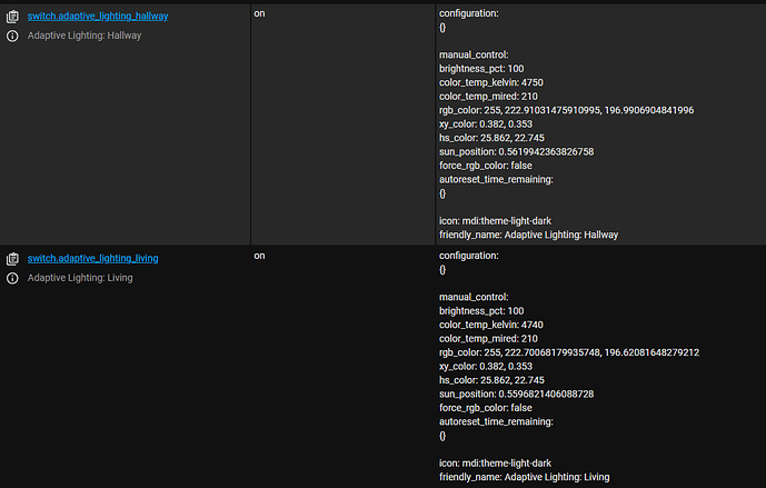

So I think I may have found my issue. When I look at the configuration attribute of the Adaptive Lighting switch I just see {} and no actual lights. I tried to define one of my instances in yaml and there was no change. Still shows the same in the Developer Settings. Not sure what is going on.

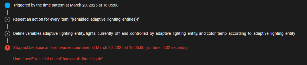

Your current trace error is slightly different, right?
The screenshot you shared before showed a step Define variables adaptive_lighting and adaptive_lighting_lights, but those variable names don’t exist in the newer script (they should be adaptive_lighting_entity and lights_currently_off_and_controlled_by_adaptive_lighting_entity in the new one).
I can maybe help prevent some burning of unnecessary cloud computing cycles by pointing to the spots to investigate.
There’s only one place in the automation an attribute named lights is being used: line 16 state_attr(adaptive_lighting_entity, "configuration").lights. That means one of the items in your enabled_adaptive_lighting_entities list doesn’t have a lights attribute. That list is being created by getting all of the entities provided by the AL integration, filtering so that their names start with “switch.adaptive_lighting_” but not “switch.adaptive_lighting_adapt_” or “switch.adaptive_lighting_sleep_mode_” (see the definition of the enabled_adaptive_lighting_entities variable). Maybe look at all of the entites in HA developer tools that match those criteria and see if they all have lights attributes and nothing else looks fishy?

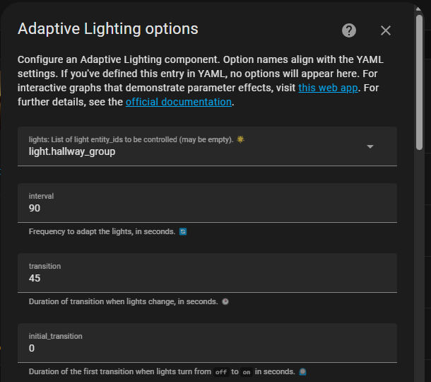

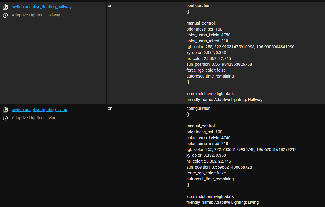

I will try that when you get a chance. Although I tried with just the bare bulbs and got the same error. In Developer Settings, what do you see for your adaptive_lighting switches. This is what I see.

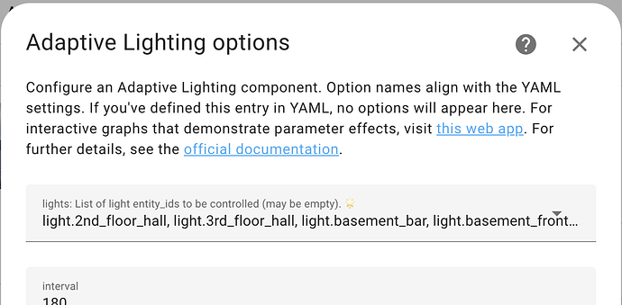

And in the AL entity’s configuration, you have lights in the first input?

If I run it I get
Error: UndefinedError: 'dict object' has no attribute 'lights'
and this happens at this place of the code
        - variables:
            adaptive_lighting_entity: "{{repeat.item}}"
            lights_currently_off_and_controlled_by_adaptive_lighting_entity: |-
              {{ state_attr(adaptive_lighting_entity, "configuration").lights |
                 expand |
                 selectattr("state", "==", "off") |
                 map(attribute="entity_id") |
                 list }}
            color_temp_according_to_adaptive_lighting_entity: "{{state_attr(adaptive_lighting_entity, \"color_temp_mired\")}}"
I have light groups assigned in the Adaptive Lighting.

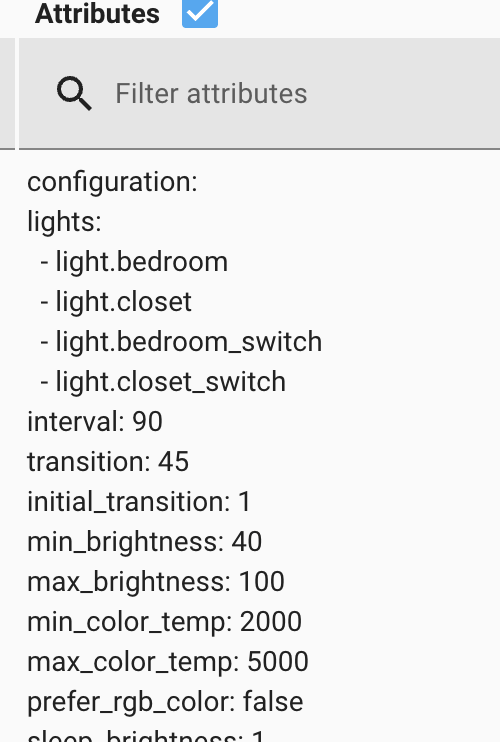

And in the states explorer under developer tools, your AL switch’s configuration attribute is {} like larryo108’s instead of something like this?
Screenshot 2025-03-20 at 7.10.37 PM

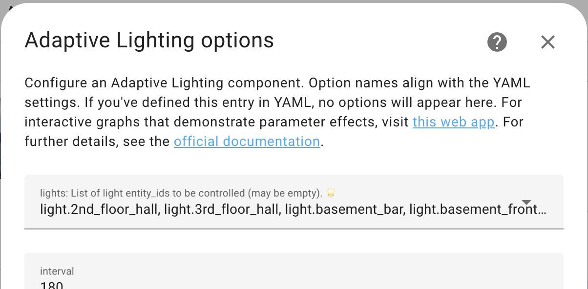

Are you guys configuring your AL entities with the GUI, or some other way? I’m not sure why the configuration attributes aren’t in there for you.
For multiple base topics, that sounds tricky. Is there a way to look up the mqtt info of a HA light entity? I’d think you’d need to do that, because AL only knows about the HA light entities. Maybe the original author of this automation has an idea (see the link to AL’s github in my post from this morning)
I do have lights defined in my AL instances. I am not sure why I am not seeing what you see in developer tools.

Curious what version of AL you are running? I am on the newest.
I think you need to enable the option:
include_config_in_attributes: Show all options as attributes on the switch in Home Assistant when set to true. :memo:

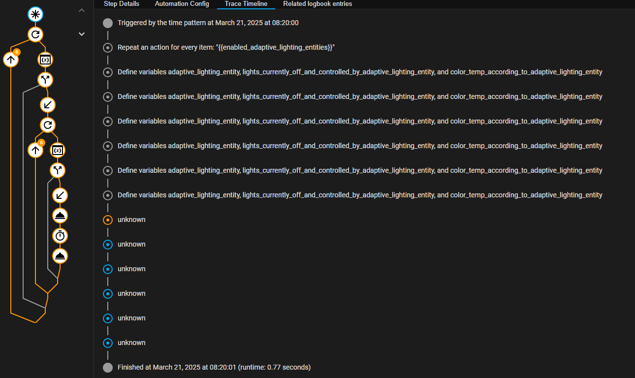

THANK YOU!!! That was it. I never would have thought of that. I am seeing it all in Developer Settings now. This is what I am seeing in the automation trace now. Next step to figure out.
That’s also what my trace timeline looks like in my (working) setup.
Do you have any lights that are off right now that were last set at a different AL temperature? My guess is you can turn them on without a color shift.
If not, maybe open up your Z2M logs and watch them as you manually trigger the automation?
