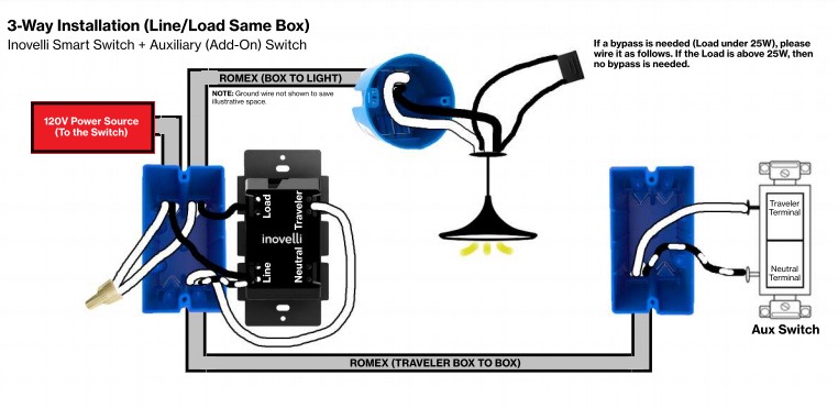

I have some 24k 3w resistors which I plan to use and test it as a bypass for non-neutral light set up.
I read that bypass should be install inside the gang box behind the light fixture and I was wondering would it make any difference f I install it in the gang box behind the switch instead?
It has to be installed where there’s a neutral present.
From the same circuit.
The bypass is connected to the neutral from power source and to the wire that goes to the switch terminal (Load) correct? “bridging over the led bulb socket”
The hot wire from power source goes to the switch terminal (Line) and nothing or no bypass is install on that circuit right?
Correct.
Thank you!
