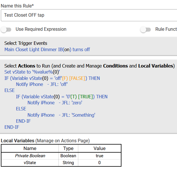

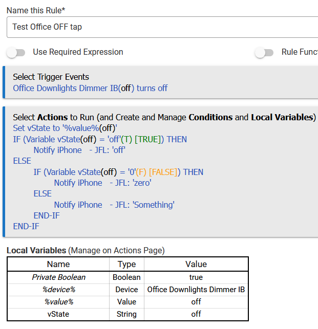

Below are screen shots of 2 instances of the same Hubitat rule (one was cloned from the other). One rule is for my office IB (the first one I installed out of 40+) and one is for our main closet (acquired and installed a 2-3 months later). Both units report a driver date of 2024-05-30, a firmware date of 20240412, and a firmware version of 2.18. The Hubitat driver for both units is identical.
The Office rule reports %value% as the string “off”. The Closet rule reports %value% as the string “0” [zero, not a capital letter O]. That seems to indicate that the firmware and/or hardware was changed in the few months between purchases.

I am using quick taps when I use the physical switch to tap, but the result is identical if I use “run rule“. Indeed, the screenshots I posted are from using “run rule“.
Then %value% doesn’t mean anything. This built-in variable only gets set to the value of the last triggering event (manually running the actions is not a trigger). From your screenshots, that should be “on” or “off” since your only trigger is the switch state – but, again, you’ll need an actual trigger event to make that happen, per the Rule Machine documentation.
If that is not what you are seeing, I suggest enabling all logging for the rule and providing the output of Logs, filtered to just this rule and possibly the event history from the switch, after an actual trigger event, as well as the values of the Local Variables table after a refresh of the page (if you already had it opened at the time of triggering).
(As one possible explanation: if you previously had different trigger events, this could be leftover from that, and if you cloned one rule from another, the built-in “cache” of the value will come along with it initially.)
If you still see 0 as a value after that, the driver must be mistakenly sending this as a value for the switch attribute instead of level attribute, but that would be unusual and an issue related to the driver you’re using on Hubitat, not the switch firmware itself. (It’s also not really an expected value for level, but it would at least make some sense.)
Problem resolved: The Closet switch was found to be simply not working right with a lot of different commands (logging and identification, for example), so I reset it to the factory state and reconfigured it as a dimmer and everything worked right.

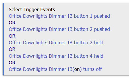

The image below is of my triggers. I test the value of %value% to figure out what the actual trigger was (so the rule is actually a 5-in-1 rule – again, for ease of dissemination via cloning). The rule actually works mostly fine, except that double-tapping the bottom paddle could use a little tweaking IF I could make sure that a double-tap on the top paddle wasn’t the trigger.
Hence the desire for some way within the rule (post triggering) to figure out whether a top paddle or bottom paddle double-tap occurred. The %text% variable doesn’t seem to exist in RM – it returns “null” in testing when I try to log its value.
My driver for each IB (dimmer configured) is the official Inovelli driver. It’s a bit surprising that it seems to lack a way of distinguishing multiple taps on top vs. bottom paddles. Really, the buttons couldn’t have been numbered 1-21? So instead it takes 2 parameters (button# and event) to identify a button action, and one of those parameters (event) is apparently invisible in RM?
This really seems like a better automation for Button Controller over Rule Machine.
The Button Controller editor is nearly identical to that of RM, so if you like RM, you’ll like this, too. It just makes using different triggers for different button events – as you are trying to do – easier, while still keeping everything under the same “parent” Button Controller app if organization was your concern with separate RM rules. I would suggest one of these approaches for both the reasons already discussed and the general observation, through years of helping people with Rule Machine myself, that multiple, simpler rules are almost always easier to write and troubleshoot compared to fewer, more complex rules.

But if you do go back to this approach … no, this really shouldn’t happen unless the driver reports that value for this event. You could try re-creating the rule just in case something else, like maybe a trigger you once had but removed, is causing problems? Or check “Event” history on the device to verify that this isn’t really happening (might have had you do that above, I can’t remember…); if so, that would be a driver problem, though an unusual one…
Or is it possible that I have set some parameter that causes the difference in how values of %value% are reported?
No, the problems I was having was that the 2nd IB unit I was trying out with my rule was simply not responding properly to a lot of commands, so I reset it to factory status and now all is well. The value of %value% is now “off” when the 2nd IB unit is turned OFF using the bottom paddle.
