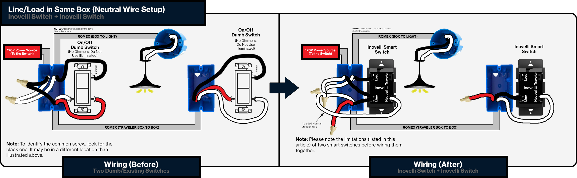

I have wired 2 White series dimmer switches in a 3-way configuration (see photo below). I have done this before with the Blue series and bound the 2 switches together. After I completed all of the wiring (3 3-way and 1 4-way setup) I went to configure binding and then realized we are very early in the implementation of this.
What is the best way to bind 2 white smart switches together using Home Assistant? I see a lot of threads, but it is unclear to me what is the best way to do this, or if I need to go back to using a dumb switch for the 3-way configurations.
