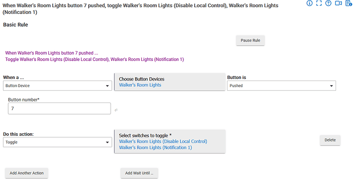

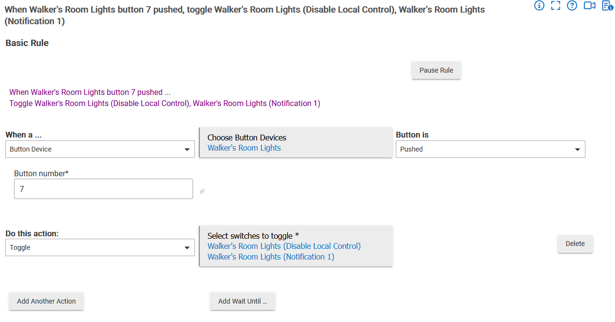

I have the same issue (toddler vs. light switch). Here’s the Hubitat rule I use; it just toggles control when the config button is tapped (and turns the lightbar purple to show it’s locked)
